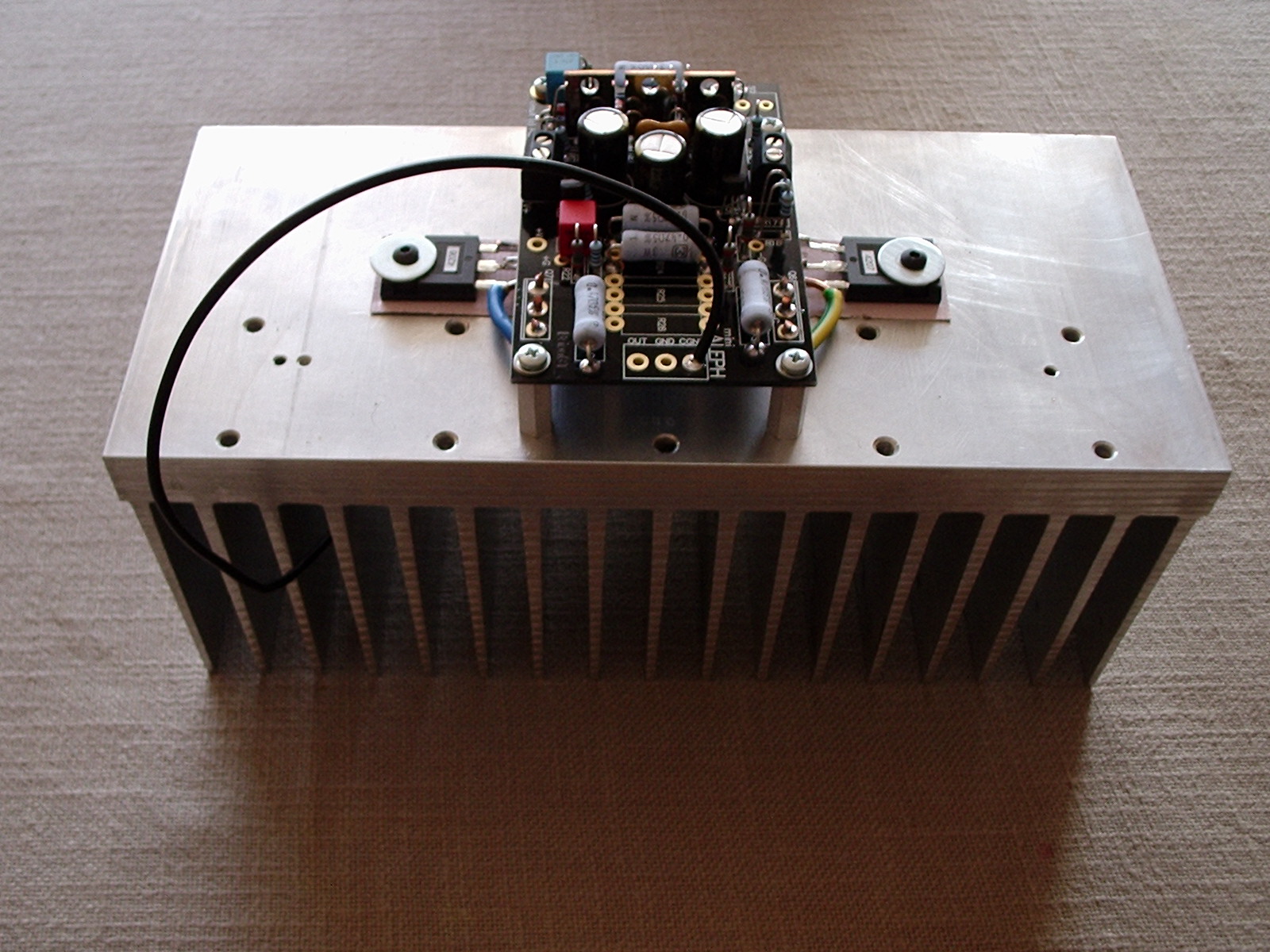

It has been cut in two pieces, one for each chanel.
A higher bias will be Ok with this one, I think so, don't you ? 😉
I've to design the others panels parts, the worst for me, drilling and so...
I'm not equiped to perform that actually.
I think you can run it at a higher bias than 1 amp with such heatsinks.
