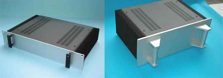

I just ordered my chassis from Here The base price of the unit is the same as modushop but for some reason the shipping from France was a lot more reasonable.
Very nice cases, I like this one,
Wonder what prices are and shipping, to Canada would be expensive i think ? I need 2 tho.
Shipping for the 2U unit 19" x 11" x 3" and 6.6Kg was 38 euro. Also if you make a profile on the french site the price is adjusted to exclude VAT assuming you're not in the EU.
