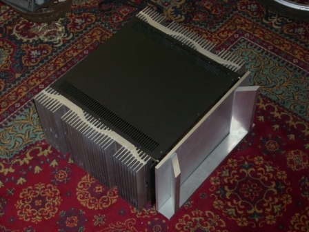

Hi everybody!
I just finished A30 monoblocks with BrianGT boards. I'm now looking in fine tuning Bias, AC gain etc. I have spent last few days reading... but I was not able to find out why the resistor R17 ref. Brians schematic (R16 on Aleph 30 schematic) recently posted by korben69, is marked for trimming?
In that matter following the logic of TBD in sch. shouldn't the R18 be left to trim DC offset??

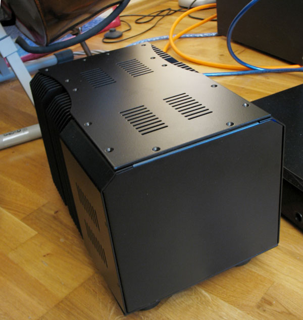

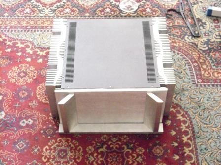

The sinks are PADA and I bought them used from zeonrider :wave:
The case is my own design and was manufactured in Serbia.
Also of course lot of my handwork and sweat built in the case.
Oh and yes,..Uriah guess what I'm going to use as the preamp😉
