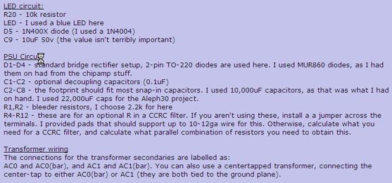

I'm building a standard Mini-A using BrianGT's boards (Amp+PSU) with a 2x12V toroid, hoping 15v at the rails. I need about 10W.
I was wondering about some questions :
1° - With 3K3 resistors as R1/R2, a strap is required for R3 and R12. Please confirm.
2° - Could the PSU board be fed with 2 Leds and a single 10K R ? Please confirm.
3° - I'm planning to use 2x(22000µF/10000µF/3K3/10000µF) in this order. I'm right or not ?
Would it be a better solution with 22000µF/22000µF/3K3/10000µF ?
Nice to read from the expert ! ;)
Hi !
For C1/C2 I've used 0.1µF/160V MKP1837.
I've read it in the MiniA topic.
