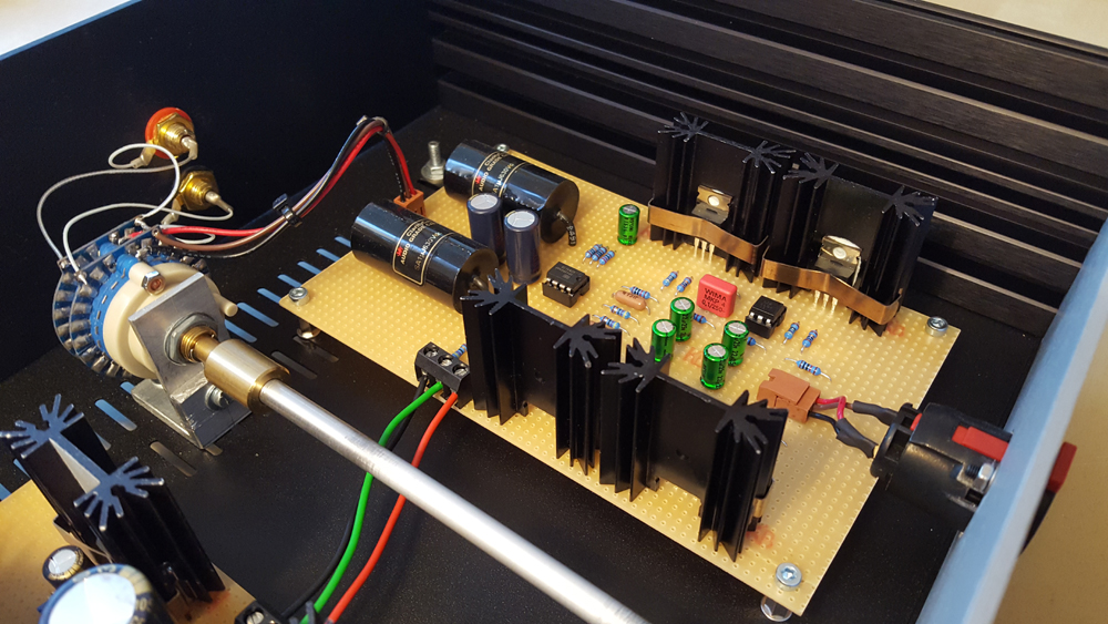

Pics of the board - this thing is really tiny so its vey easy to fit into the amp:
And the back of the amp with the fans. I know its ugly, but they can't be seen, and indeed, much more importantly, can't be heard. They start up reliably, run quiet and I have found that the inside the case temp and the heatsink temp is the same as when I had one fan mounted inside but running harder and noisier.
So overall a result I would say. Not the most efficient means of cooling I know, but I'm happier now with the 30-33 deg C rise over ambient on the heatsinks and 25 deg C rise over ambient inside the case.
Thanks to all, and of course to Nelson for the fan circuit.....
