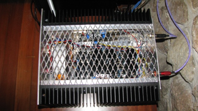

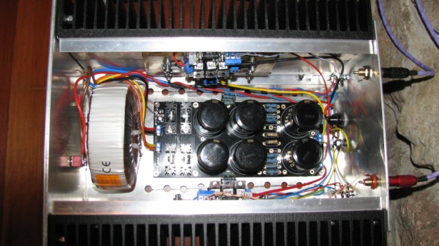

Completed my Mini-A using Brian GT boards, after leaving it to "burn in" for 100+ hours have done some critical listening and very pleased with the results. I am comparing with my most recent amp which is a single ended EL84 (http://www.tubeaudio.8m.com/RH84/rh84.html) the Mini-A clearly has much cleaner bass yet retaining the clean smooth mid/tops without any of the glare I have heard with other transistor amps. Ultimately the RH84 may win in terms of its detailed yet silky smooth presentation but the Aleph is better balanced. I have yet to decide my preference! Speakers are Fostex 208ESigma/T90 in BIB cabs, fairly efficient.
Briefly, I am using a 18v-0-18v toroid 225VA, rails sit at 22 to 23V. The PS uses 6 18kuf caps in a CRCRC config (I cut the track on Brian's board between the first and second caps), resistors are 4 @ 1ohm 3watt and drop about 0.58 volts each set. Current draw per MOSFET is 1.12A so gives approx 25-26Watt. DC offset starts around 50mv each channel but drops to below 10mv after 1 hour. I am using 2 Conrad MF30-75 (0.37 C/watt) hear sinks per channel, they are bolted together with piece of solid brass to which the power mosfets are attached (I had 6 of these sink sitting around for an A75 project that never got built, that also provided the power mosfets!). After an hour they are sitting on 40C which is a 21C temp rise. More than adequate heat sink then.
In noticed after about 3 hours running you can still hold the heat sinks continually without much discomfort however the transformer is hotter than the heat sinks. I would guess its sitting around 50C. I know they get hot running class A (my RH84 traffo gets fairly hot) but is this too hot and reason for concern? It wasn't so hot before I put it all together in the chassis with the heat sinks - I have drilled holes in the base and the top is an open mesh for airflow.
Will post some picks later.
Usual thanks to Nelson, Grey for the design and Brian for the great boards.

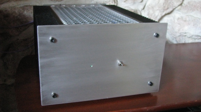

ChrisMmm said:Some pics
BTW, what's the best way to get a good "brushed aluminium" finish on the front panel?
using a 1/4 sheet palm sander , take all the scratches out of the surface , finishing with 320 grit silicon carbide paper.
wash surface well.
on a sanding block load up 80 grit silicon carbide paper .
using straight linear strokes sand the surface, you may want to clamp a straight edge on the panel to guide your strokes (be sure to pad the clamp so it does not marr your work).
Every few strokes blow off the surface preferrably with compressed air to remove particles of grit. move straight edge to next position till you reach the other edge of panel.
this method has given me some beautiful looking panels, after anodizing they look as good as any commercial products.
on further note 80 grit may give a courser finish than you are after so by all means try this first on a scrap.
happy diy'ing

maybe so but I have used this method for years at work and have made 75 to 100 panels with perfect result.
If you don't feel comfortable doing it then your anodizing shop can do it for you.
