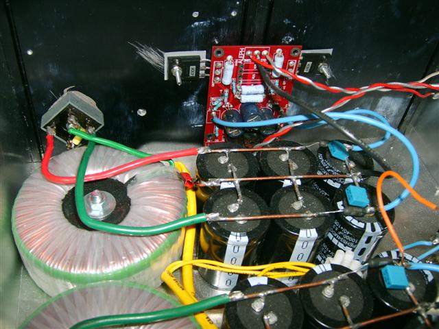

Yep, I received a new batch of boards a couple of weeks ago, and put them on the website order page on Tuesday. They will be on the order page until they are gone.
I haven't seen any Aleph amps built with the red boards yet. For the first person who posts a reply to this post with a picture of an amp built with the red boards, I will send out a free black pcb set of Aleph boards.
I shipped out almost 100 of them, starting way back in May 06:
http://www.chipamp.com/diyaudio/mA-boards0.jpg
They looked like this:
http://www.passdiy.com/gallery/aleph30-p3.htm
Brian

I am not sure what Bias I am running Brian, they are built exactly to your Parts List. I can tell you the massive Heat sinks remain cold during operation and I am only using half of each side.
The rails are 16VDC
Are the Black Boards the same circuit?
Anthony

Awesome, drop me an e-mail with your address, and I will get a black pcb set shipped out.
(the black pcb set and the red ones are the same, just different color soldermask)
