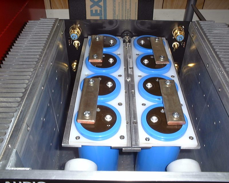

fcel said:I happened to see the attached pix. What were you going to built?
And where did you get those vertical position plastic xfmr's holders?
That Capacitor Rack is for my Aelph-X project, I made it from scratch myself. That is 2 Farads of capacitance in that rack!!

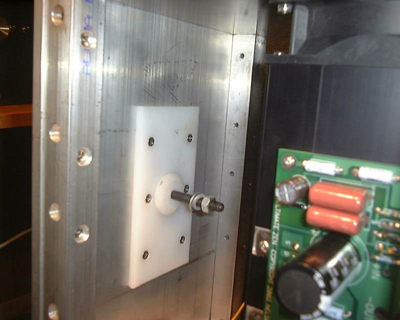

The transformer holders were also something I made up, I machined some Delron from 2" stock to fit inside the core of a my Hammond Transformers. I drilled and tapped one side and fastened them to a plate also made of Delron, imagine the letter "T". Then I drilled and tapped into the back of the faceplate, not through the plate, just about .285" the plate is about .375" thick. I also drilled and tapped a through hole for the mounting bolt to clamp the transformer on. I made two of them as this chassis is made for Dual power supplies eventually.
I also made some brackets for potted transformers as seen in the attached Photo

fcel said:No wonder I have never seen that holder commercially. Good job on that!
Thanks, see photo I added above for another version I made.
