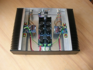

Finished my new mini aleph last night,decided to go with the Mini first rather than the A30.Case from a old P3A no room for the transformer though, after two hours the temp of the sinks are fine so in the future I'll be increasing the bias. Running with a 300VA 12-0-12 tranny, rails +/- 16VDC,offset left 4.8mv right 12.4mv.
I can't believe how good this amp sounds after so little time, feelings of deep joy.
Many Thanks to all involved in this project, greatly appreciated.
What better its Friday as well,think I'll stay in tonight with a couple of bottles and enjoy some music.
Cheers
Bruce

Beautiful work!.
Can you show the back side and a close up of the inside?
Conrad heatsinks... I may have to go that route too.

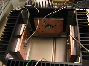

Gents,
I powered my mini up last night and (after a little smoke
) she came up fine! I had soldered the legs on the 9610's together so I could manhandle the boards without blowing the fets with static. I forgot to cut the solder bridges out...need I go on!
Question, with 17.8v rails, how much power am I making? It sounds real nice on my old Infinity rs4b's in the garage and I am very impressed (and pleased with myself). 🙂
I will have plenty of pics to follow when it is cosmetically done but here is a preview. As you can see I will be able to bias those irf150's to my hearts content. This baby's gonna get some white oak accents and is my take on the original A30 design.
