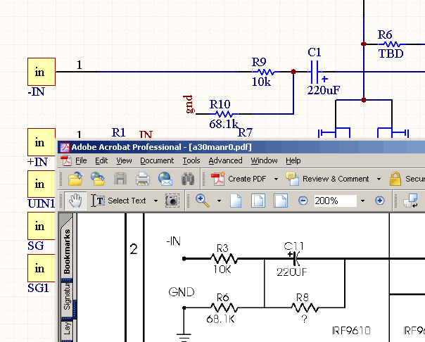

Brian
I think I may have found an error on the boards. C1 (or c11 on aleph 30 or c5 on aleph 5) has the polarity marked on the board wrongly. the + leg should connect to R9.

dhole said:Brian
Can you confirm this .
regards
dave
You are correct. Thank you for pointing out this error. I will put an update on the website. Here is a comparison of the schematic and the manual. I am sorry for the mistake. I will send out a mass e-mail about this soon.
The prototype amp (same amp board layout) has C1 with the polarity backwards and worked without problems:
http://www.briangt.com/gallery/miniALEPH-prototype/Brian_GT_Mini_Aleph_044_copy
I will talk to Mark and see if he noticed any problems. Sorry about this issue.
One more issue that I found last night, if you are using the 4 pin caps on the power supply board, you will want to remove the 2 unused pins, as the connected to the + capacitor lead, and this might cause problems. I will include this in a mass mail, and I will put an update on the webpage.
