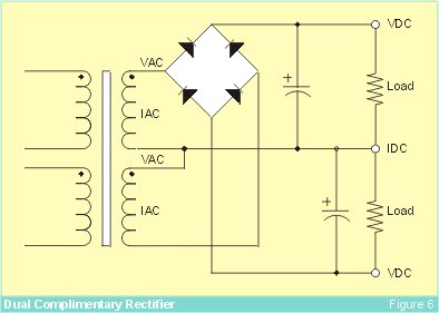

I am having problems here. I think I have blown something up. i have a toroidal with 2x28v . I have stuffed the board but had some problems. if I only use one which connections (AC0 or AC1) do I use ? Why are there there these two sets ?

dhole said:I am having problems here. I think I have blown something up. i have a toroidal with 2x28v . I have stuffed the board but had some problems. if I only use one which connections (AC0 or AC1) do I use ? Why are there there these two sets ?

Hello mate, there are four pads for the AC in, as this PSU does both +/- rails you would need a CT or dual secondary transformer. The two inside Pads are common and form the GND rail, the two outside Pads are for the two primary connections.
The primary connections can be done in two ways, they can be the two ends of a single CT transformer or the two free ends of a dual secondary with the centre taps brigded. The bridged or CT leads from a transformer go to the two center pads. Take a look at the attached image, perhaps it will help explain Transformer secondaries.

OK Ok I understand ( a moment of foolishness )
I connected the AC up the wrong way.... doh nearly set the room on fire again... hehe
now I have two rails at 37.7 v
Regards
Anthony
Here is an example of the Dual comlpimentary design that Brian's PSU uses.
Anthony

Hello Dave, if you load the PSU with the resistors or Inductors, CRC or CLC, that will drop the rails.

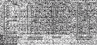

I finally started soldering my amp boards last night, soldering on all of the resistors for the static configuration (the resistors that don't change depending on the expected power output), the caps and diodes. My plan is to next match the IRF9610 devices and build a Mini-A with the first pair of boards. (stuffed 10 boards, as I ordered enough parts to stuff 10 boards)
Note the polarity of C1. The footprint on the pcb is incorrect for this component, and the cap should be mounted opposite the markings on the board.
Full size image:
http://diyamps.com/aleph/images/aleph-boards-big.jpg
Brian

BrianGT said:I finally started soldering my amp boards last night, soldering on all of the resistors for the static configuration (the resistors that don't change depending on the expected power output), the caps and diodes. My plan is to next match the IRF9610 devices and build a Mini-A with the first pair of boards. (stuffed 10 boards, as I ordered enough parts to stuff 10 boards)
Full size image:
Brian
Is that one of them new fangled AntiStatic Paper plates? 🙂
Anthony
Anthony
😉 The only static sensitive component on the boards are the diodes, which should be just fine. I will mount the transistors on the boards at the time I am ready for testing.
Brian
