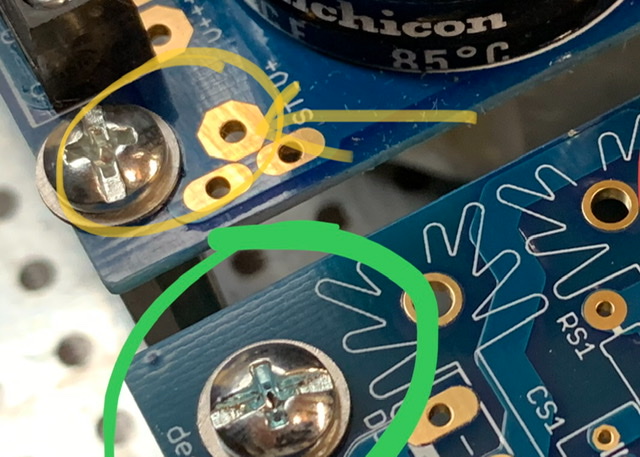

Oh my! I see what you circled. I didn’t notice that. Appreciate the catch! That could have gotten ugly.This is bad!

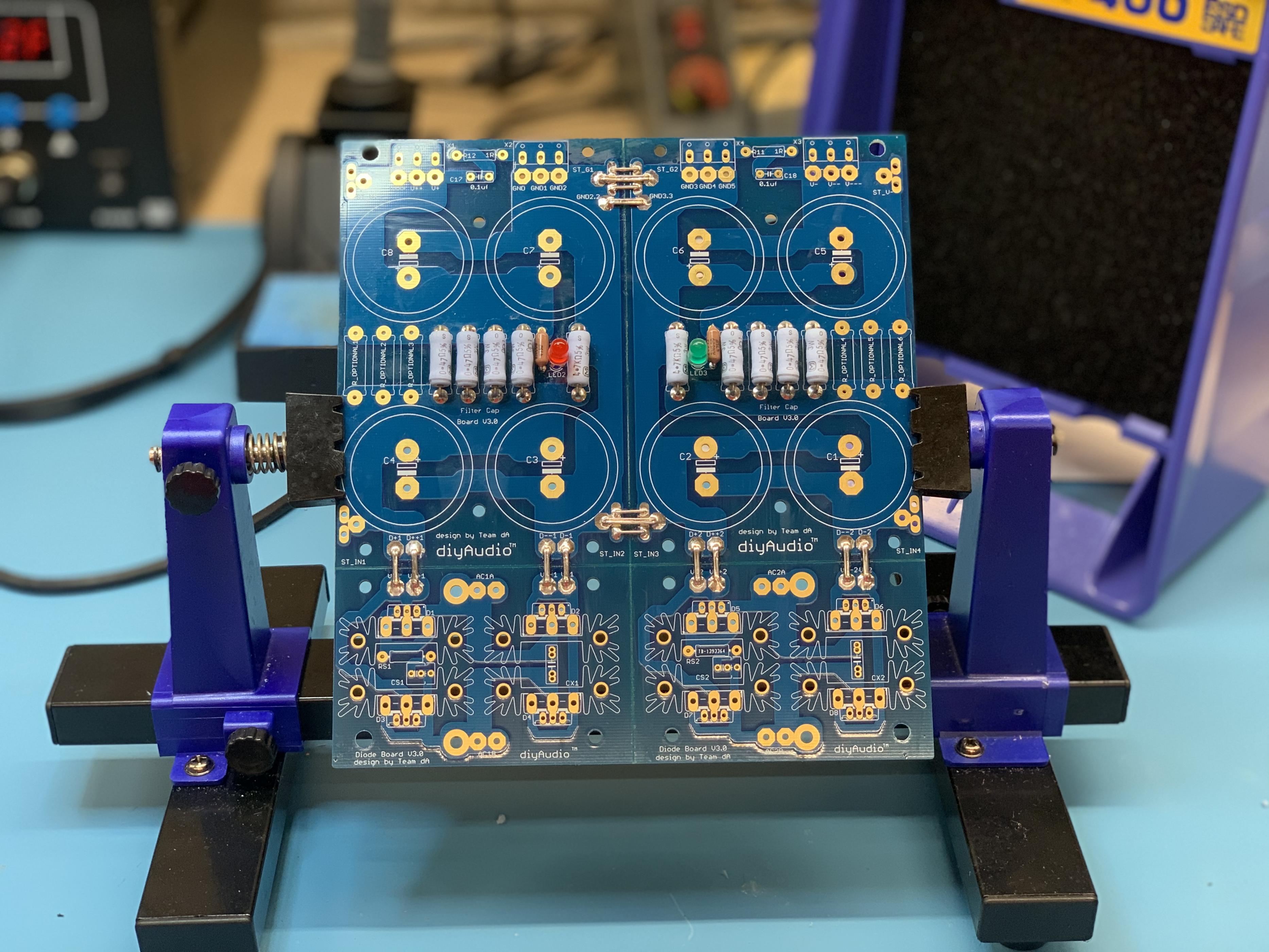

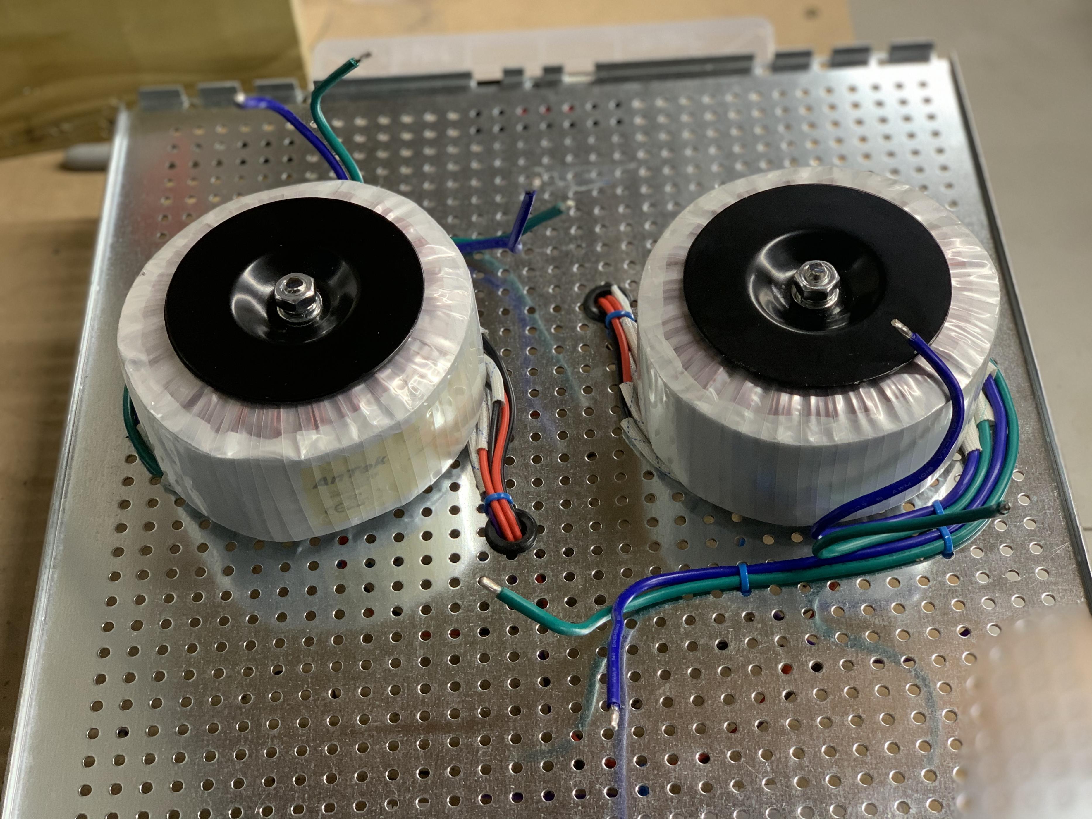

Got started on the second PSU tonight. The lessons learned from the previous one is making this one move along a bit faster. 🙂
I’ve learned on the YUGE voltage and ground planes you need more heat. Lots more heat. I found that 690°F will heat things up nicely for the jumpers and high-watt resistors. Tread lightly though. In and out. It’s a lot of watts

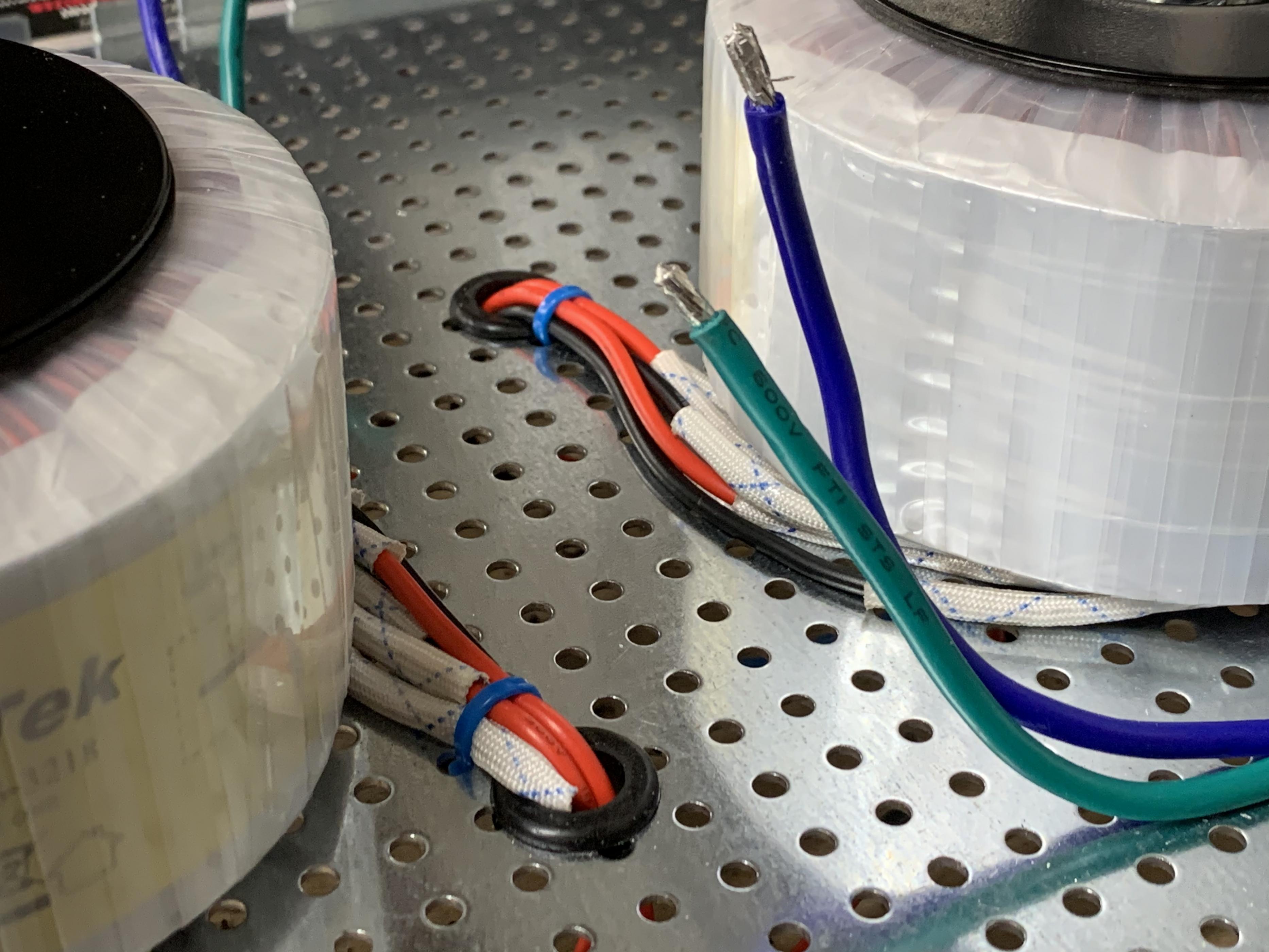

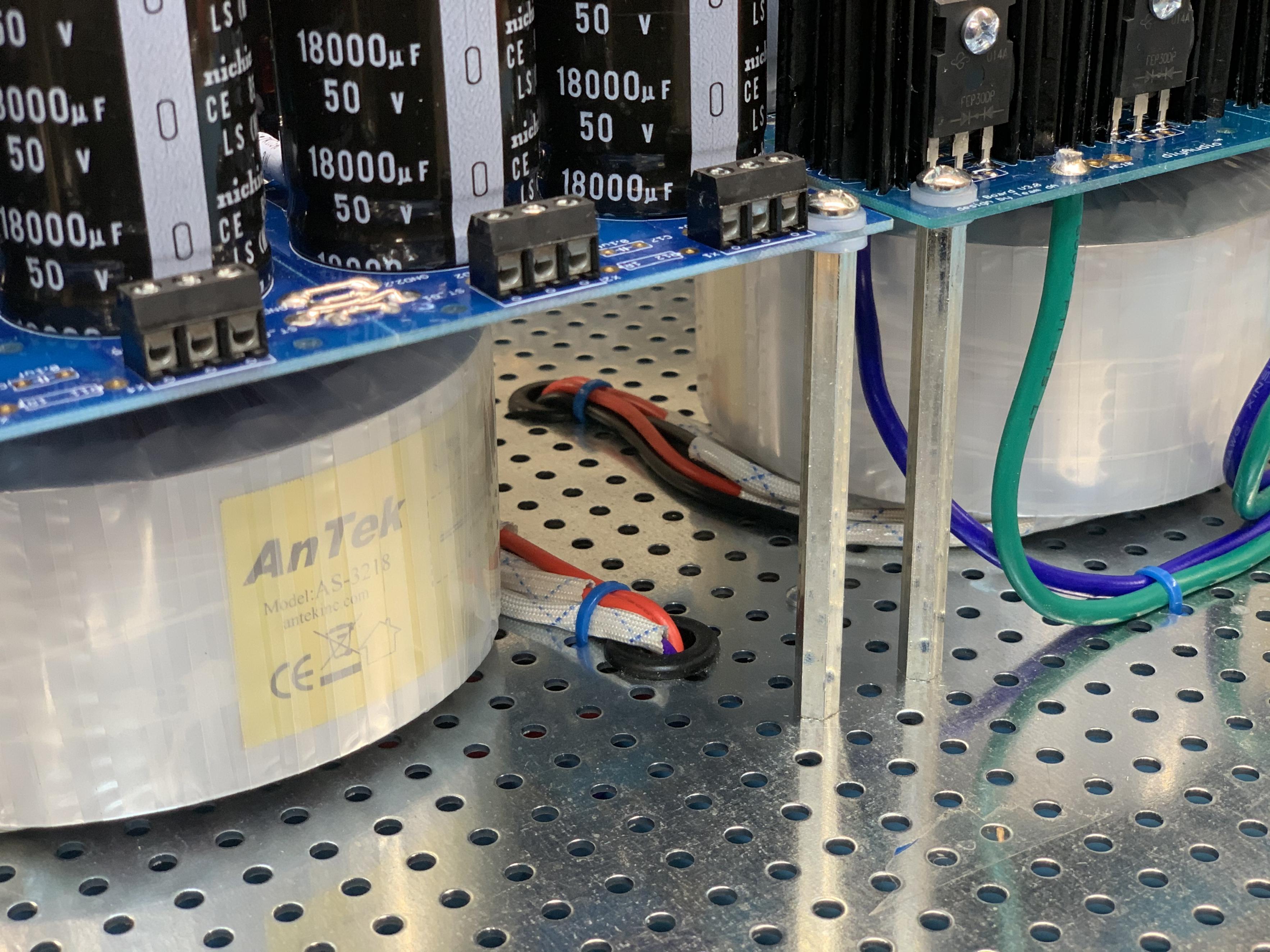

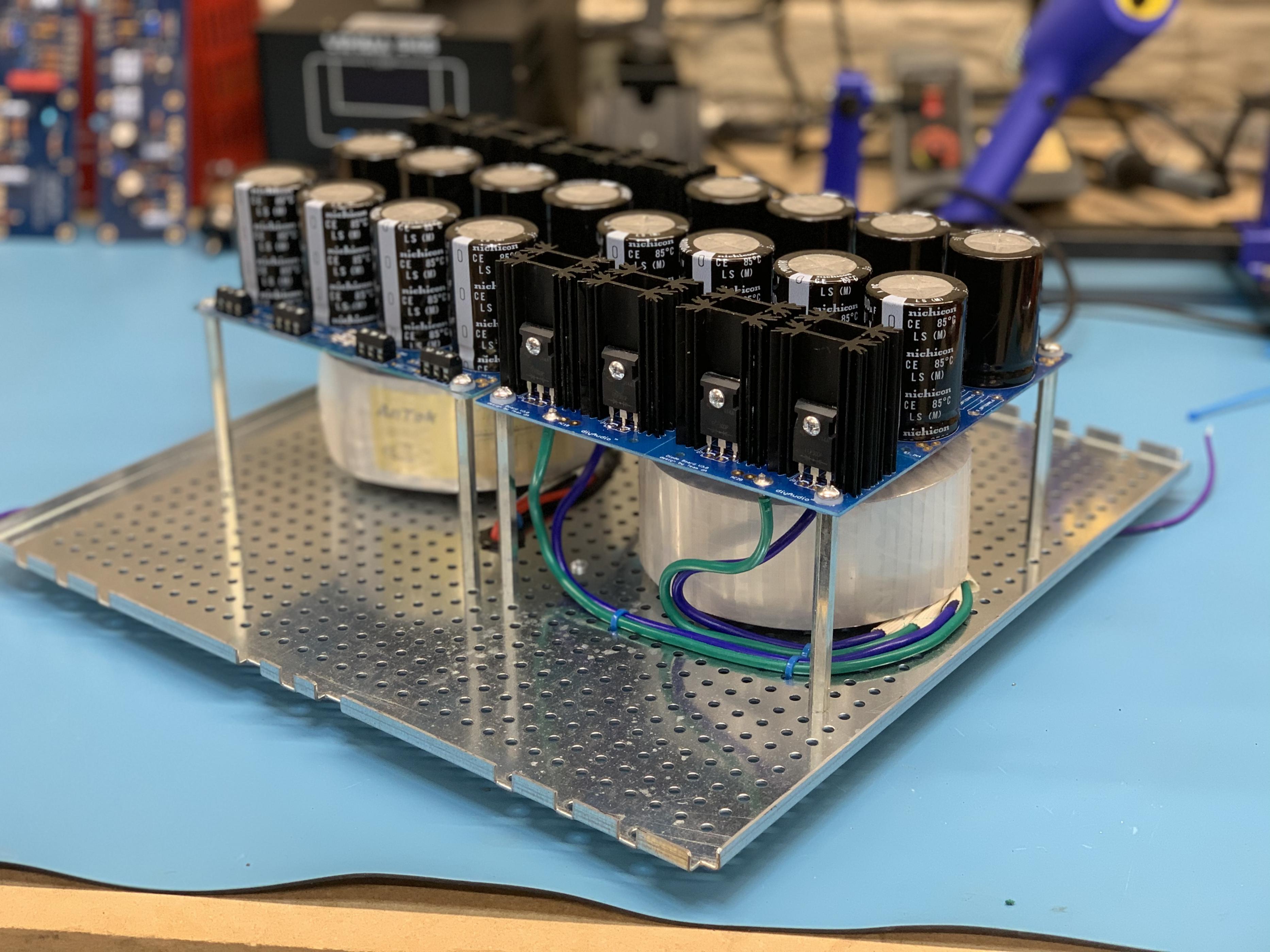

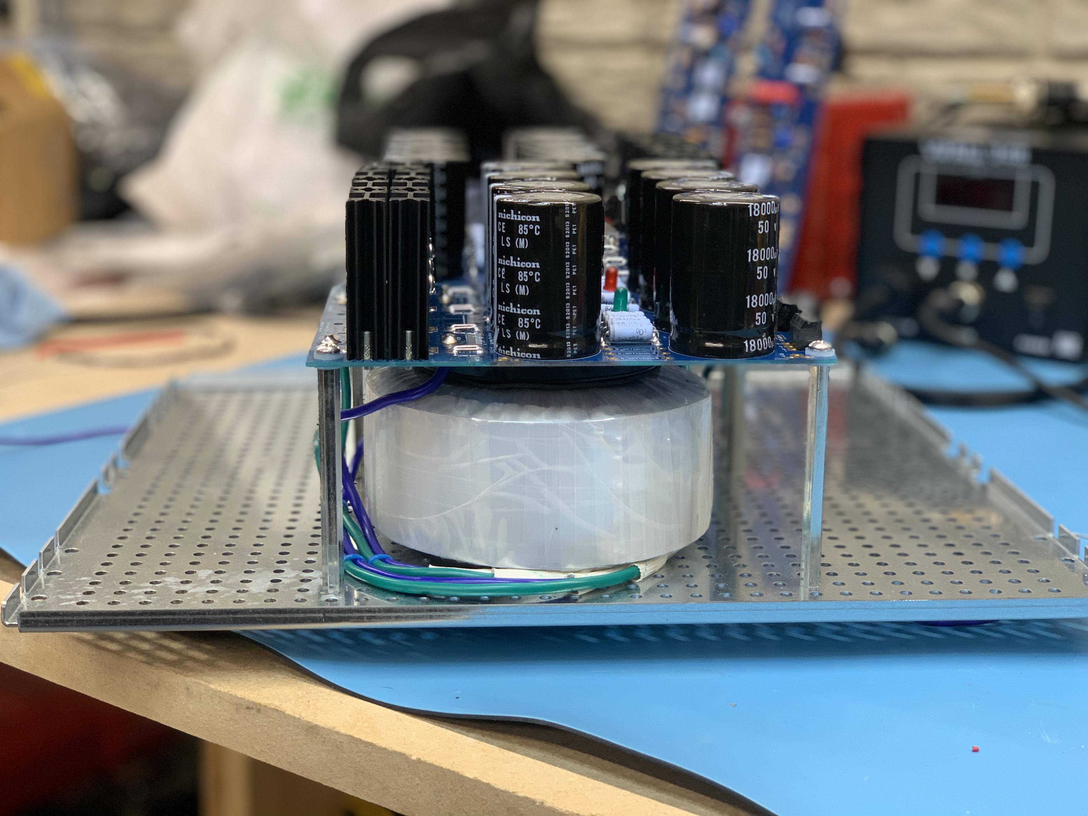

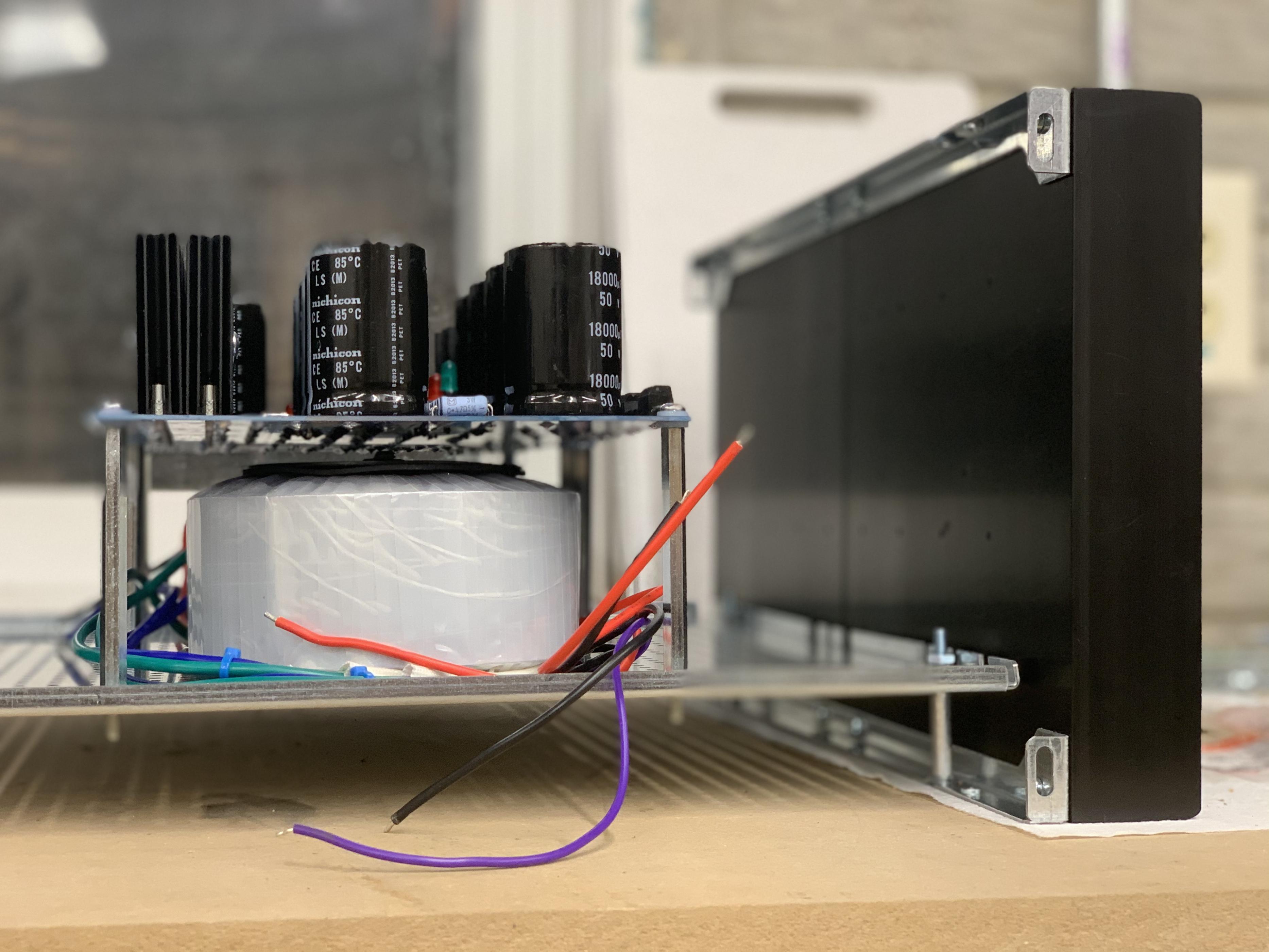

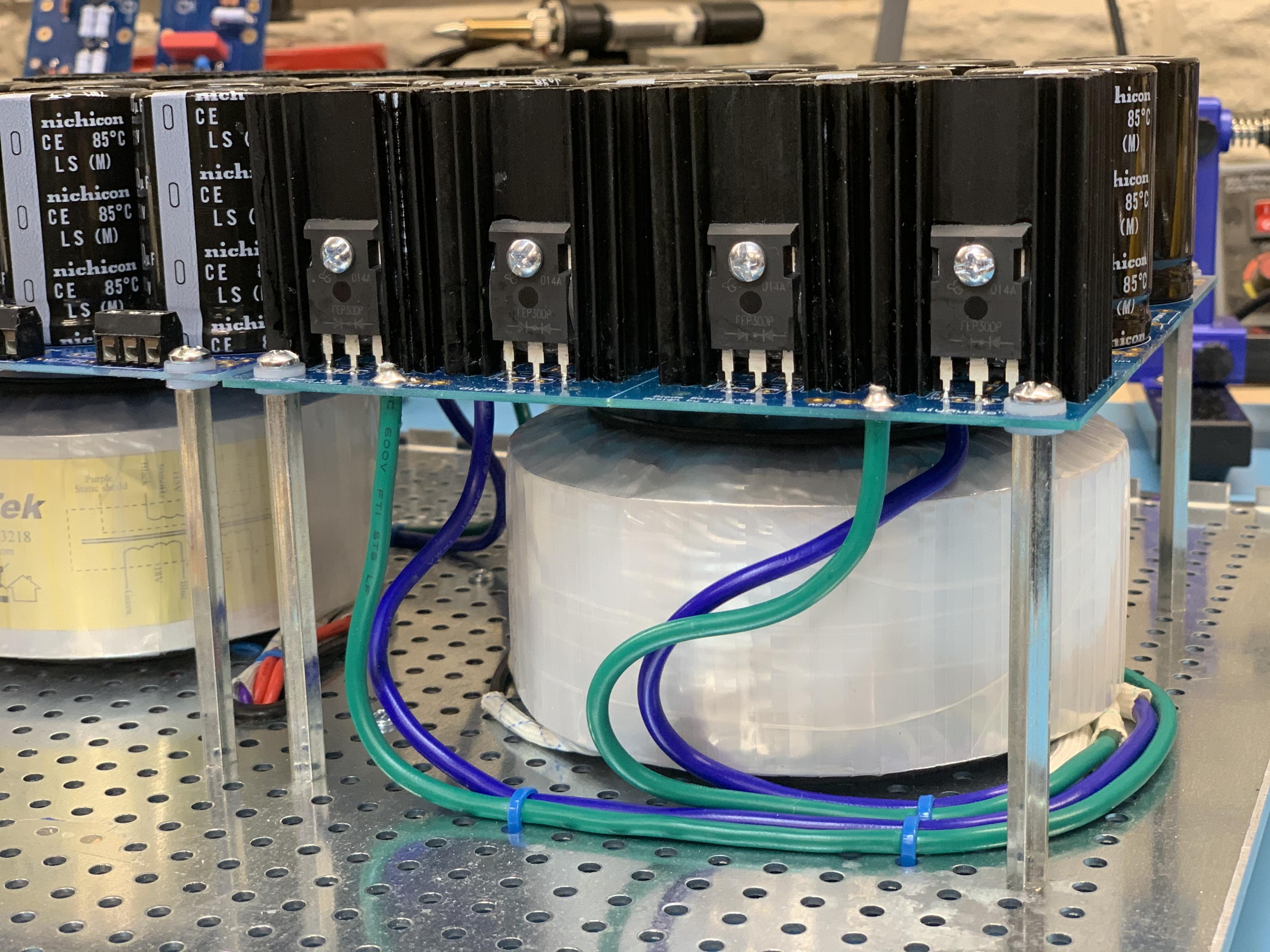

Well, ladies and gentlemen, I present one big mega huge dual mono power supply. Needless to say, it’s heavy. I fixed the potential shorting problems identified a couple days ago. Thanks for the catch! After (over)analyzing several of your comments and suggestions about elevating the platform, I took it a little to the extreme. Turns out since this is a 5U case, I can elevate the baseplate not only 10mm, but nearly 40mm (1.5”) and still have almost 50mm (2”) to the top plate. Score! That means the screws/bolts/studs for the front and back plates no longer interfere with the baseplate. The skinny standoffs that you see in the photo aren't supportive enough, so I'll probably have to fab some sort of bracketry to accommodate. But having that space is wonderful.

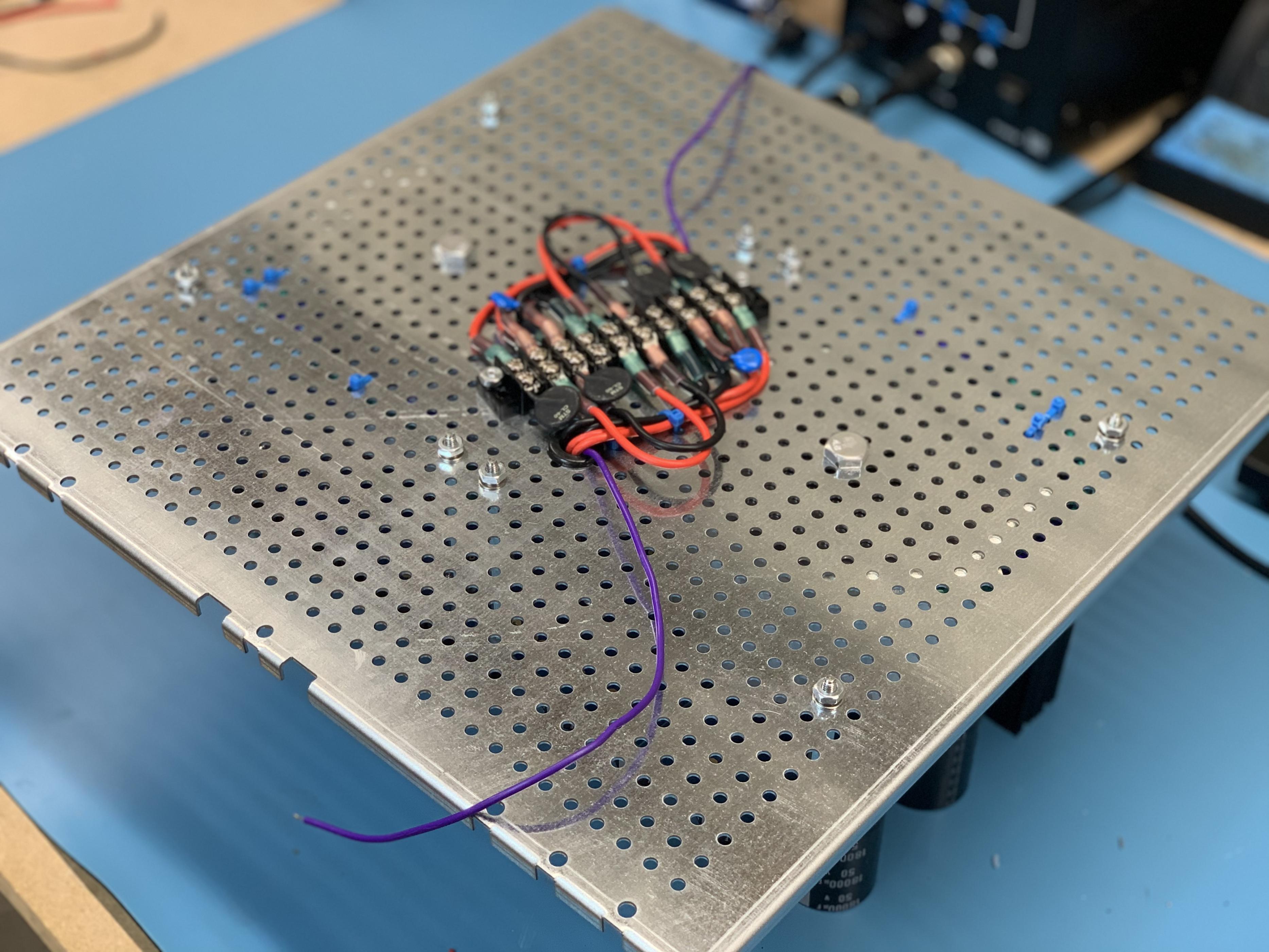

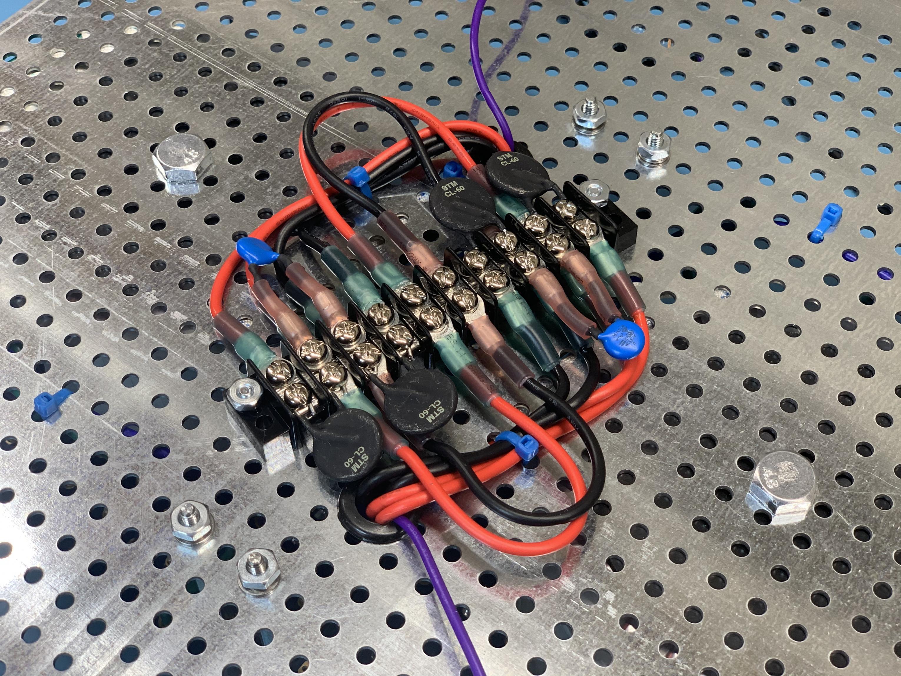

I haven’t got the mains plugged in yet, obviously. All of that is under the baseplate out of sight. While there will be well over an inch of airspace beneath there, I’ll be sure to put a protective cover over the HV parts for safety. On the barrier strip in the photo, the bottom two terminals are for the mains power. And of course there are still earth grounds to tend to.
All in all I’m very excited! Test run coming soon. Any advice before I flip the switch? Light bulb tester is recommended, I suspect. Although I do have a variac as well.

1) I think traced out your terminal block properly. Back to my chickenish nature. I like testing one PSU at a time. If it's not a PITA, I'd remove and reattach as appropriate what I think will be jumpers to carry the mains from the center set of terminals to each of the transformers' primaries to test one at a time.
2) I wish I could find my exact reference, but I can't. I took someone's kind advice to fuse each hot leg of my transformer primaries. Someone else please chime in re: whether that's appropriate here. If I find the exact reference, I'll post it later.
Edited after accidental submit to add - I'm a chicken. I use a Variac and a dim bulb tester.
One more edit much later...
