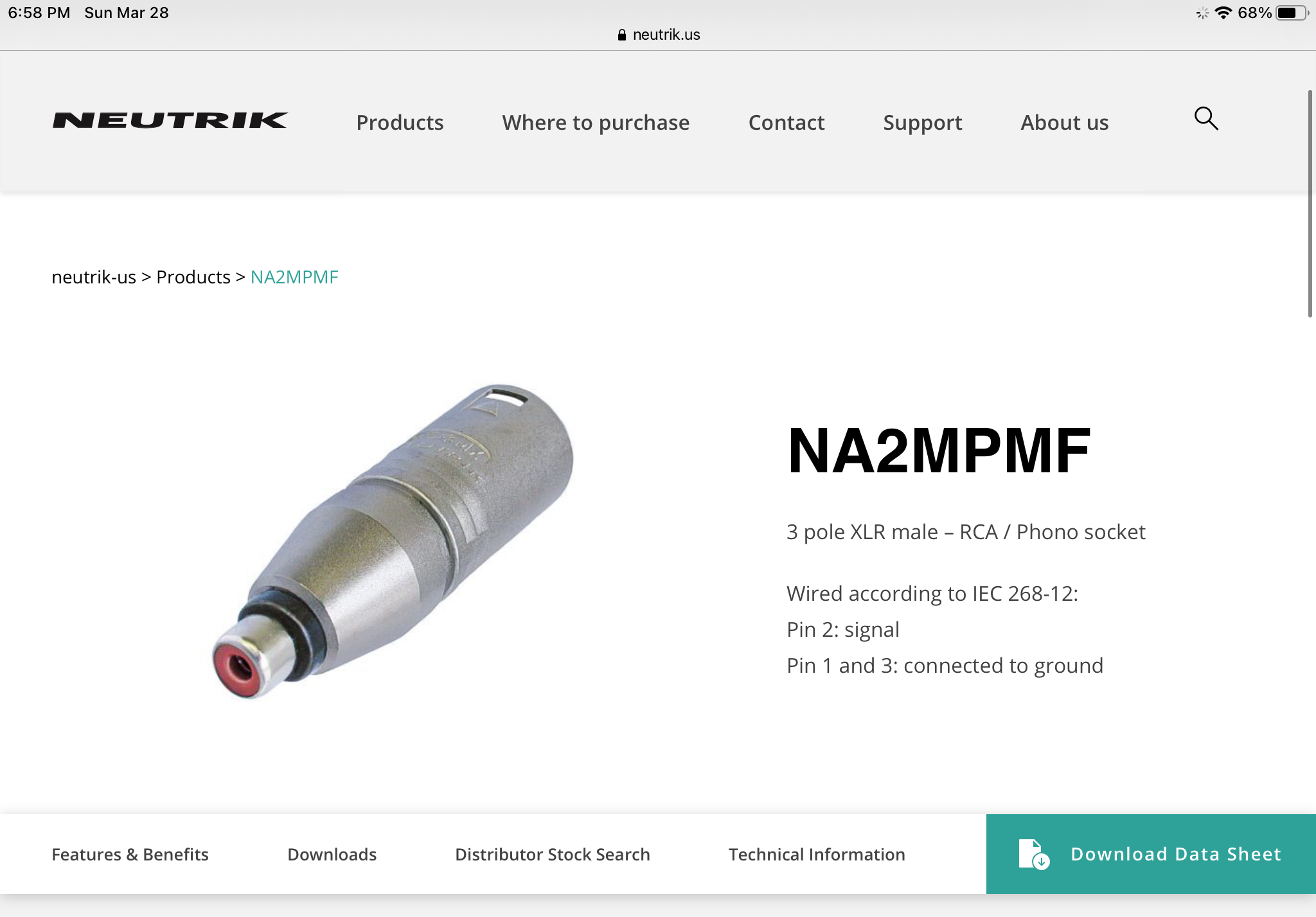

One thing I noticed today, and I don’t know if an equipment configuration changed or this is a function of balanced inputs. So a question for those using balanced inputs: is the input gain higher on them than single-ended?
Here’s the scenario. Until this amp, everything has been RCA inputs. I have used my Technics amp/preamp, and from my friend’s collection an ACA, an M2X, and an Elekit—all RCA. Into all of those I used a Mac Mini with Audirvana and a Schiit Modi DAC configured with software volume control (I know, I know). The input levels have been consistent the entire time.
Now I have the Aleph J and I set up the same configuration, with the only difference being I have a balanced input on the amp with and XLR-to-RCA adapter on the amp inputs as shown in the attached image. In this configuration, the apparent gain is insane. As a matter of fact, the software volume control is at normal listening level one click off of infinity (-35dB on the display). And it goes up very quickly to uncomfortable levels.
So my question is, does this input stage provide more gain than an RCA input? This adapter does the shorting inside the plug versus a separate RCA with a shorting wire in the plug.
I just think something changed in the software since I can only get the volume control down to -35dB, but thought I’d ask the question in case there’s something I don’t understand about this amp.

amp is having same gain V/V , being driven SE or Bal
gain is roughly (but almost exact ) ratio feedback resistor value divided with series input resistor value
I'm lazy to check in AJ thread what is that , but I believe some 10V/V, that being approx. 20db
check that adapter - is there really short circuit between pins 1 and 3
if that is the case, and you have all right values of resistor in amp, something else is fishy

I also suspect fishy. I didn’t think there should be any difference.
