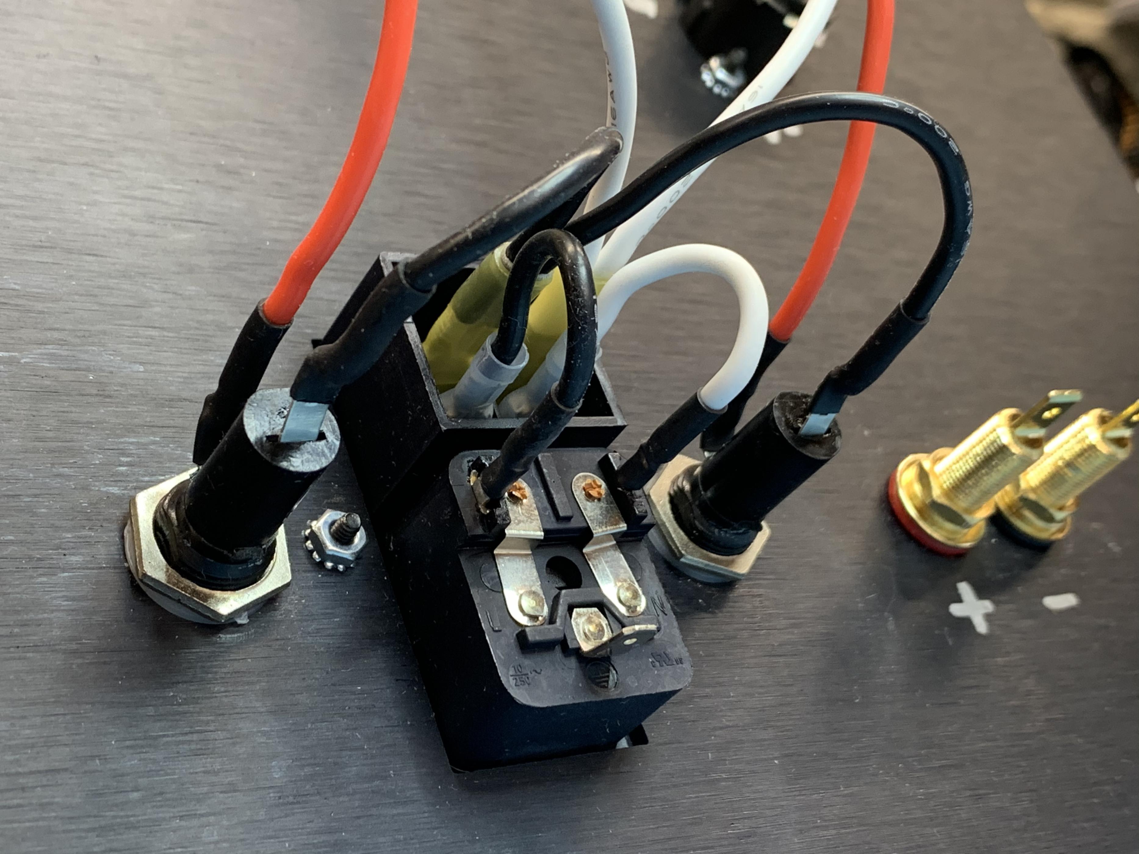

I chose a 4.7K 3W resistor for that duty. It doesn't cause problems for me (at least not that I can tell). But I did notice that it had been mentioned in the past that they'll store energy for a while, so I wanted to throw a number on that. I do appreciate the link to the discharge probe. I remember having those available on some high-power electronics in the military before we worked on them.
Safety issue resolved. Thanks for your vision, Ben!

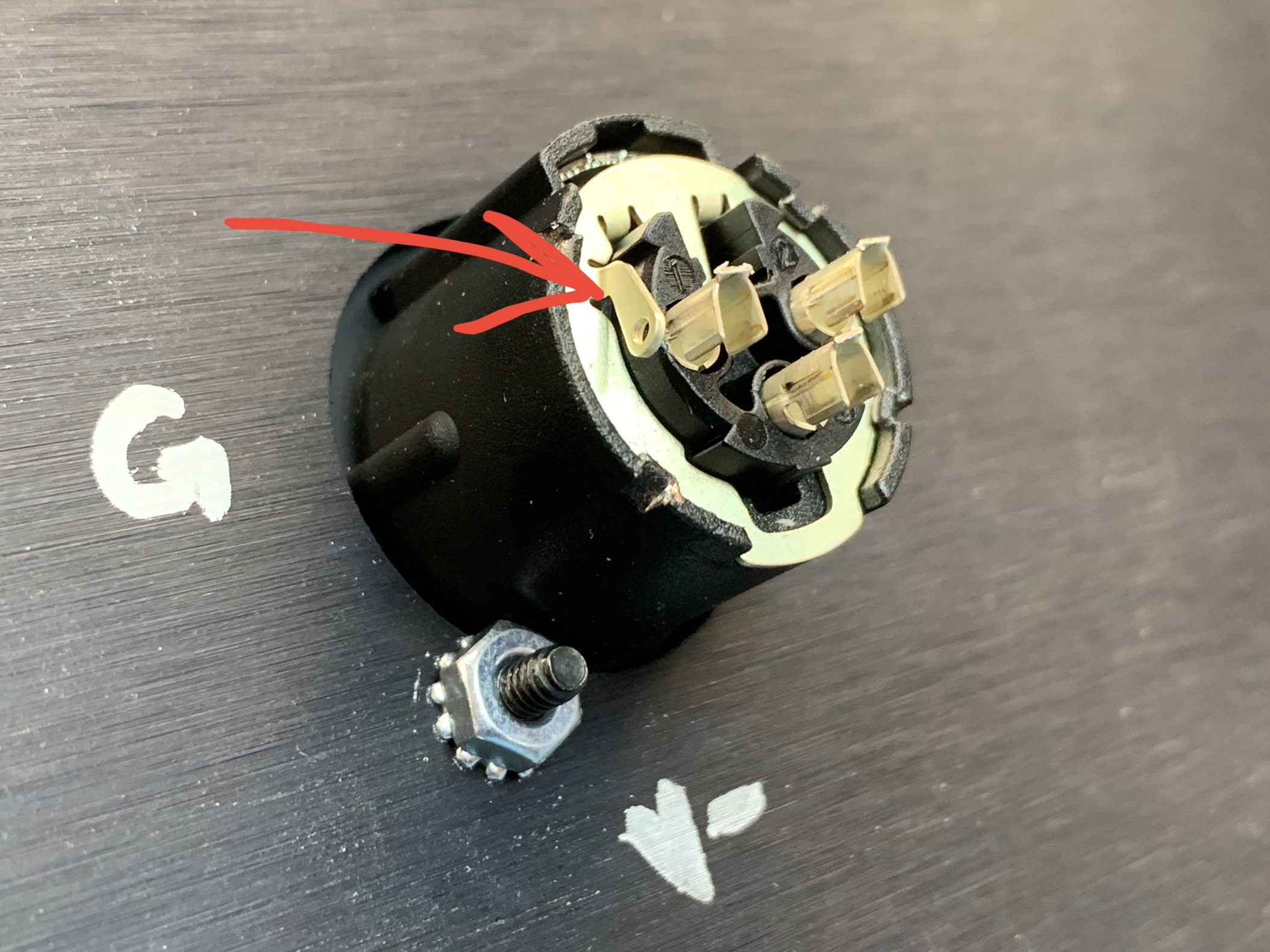

I’ll be moving on to these guys soon. The XLRs I sourced have what appears to be a shielding ground or similar. Should I tie these to earth ground? They aren’t normally a current-carrying conductor.

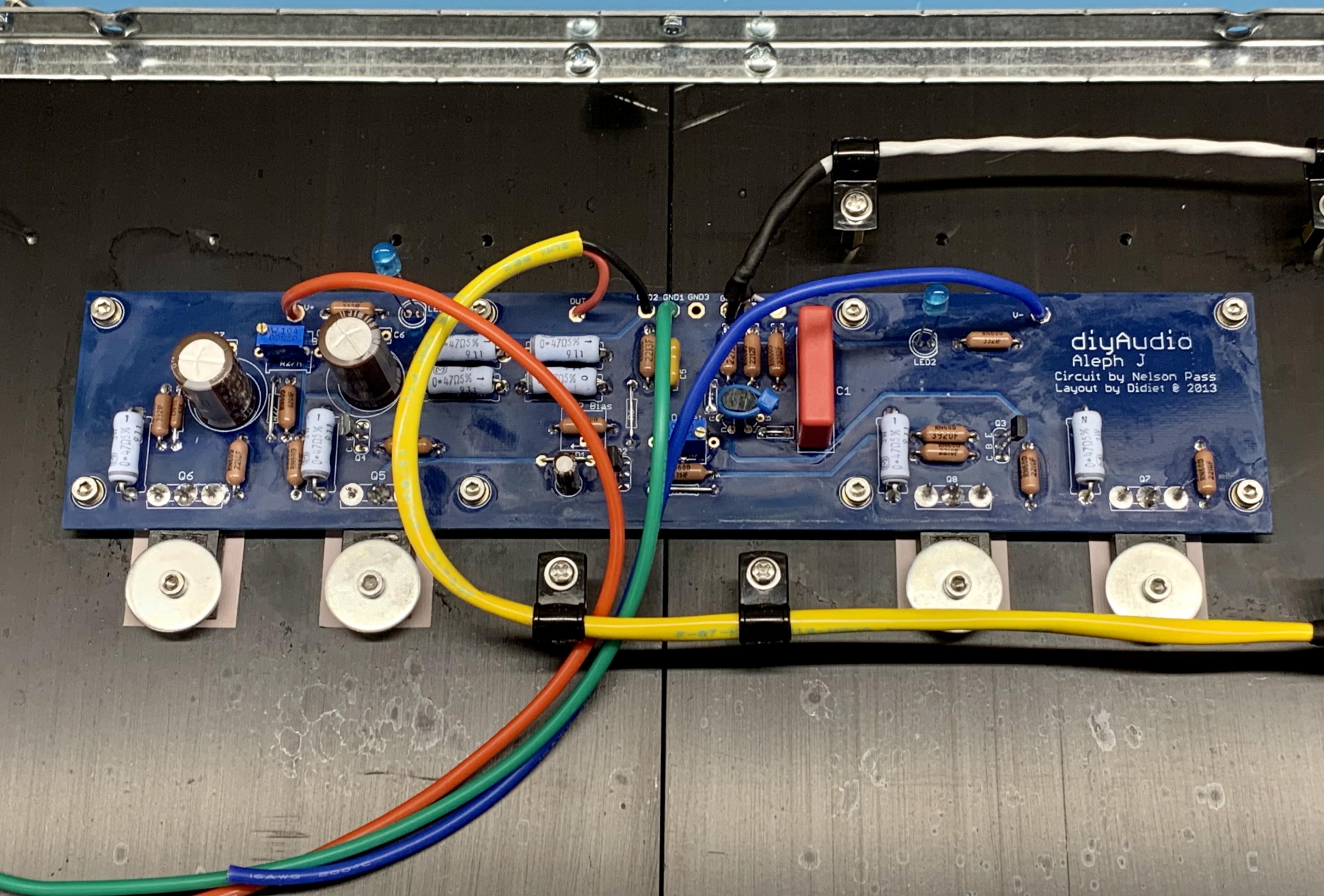

Chris... how to connect XLRs can be an oft discussed subject. Note, below is noting that you have already used a gnd lift and have not cut the trace to separate low current return from high current return on your amp boards as is sometimes done.
The way I do it is:
Ignore the tab
Connect Pins 1, 2, and 3 to Audio GND, In+, and In- on your amp boards respectively.
Edited to add - Added "In" lest someone mistakenly connect their inputs to their VDC / rail connections. 😀

All sounds like my original plan. So no surprises. Nice!
I haven’t added the ground lift resistor (yet) since there aren’t any noise problems (yet).

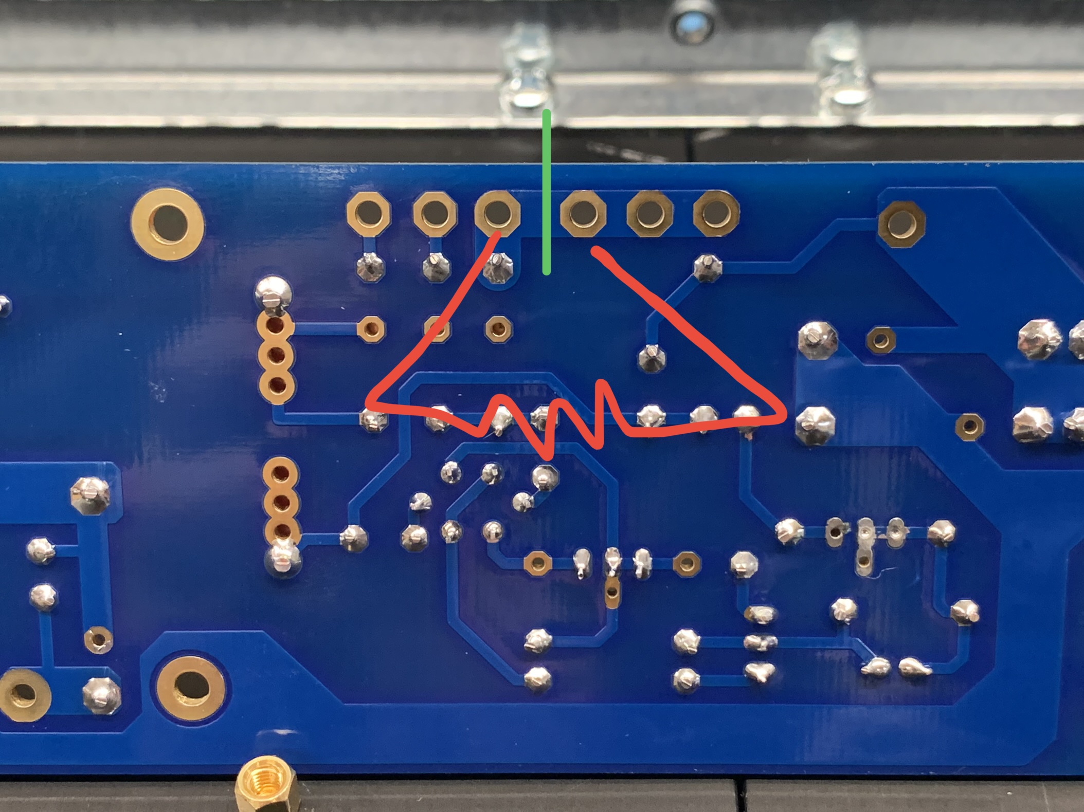

Your CL-60's from PSU GND <=> Audio GND to Chassis Earth are your ground lift. No need to double up in another location as far as I'm concerned. Again... grounding / ground lifts etc. are often discussed. It is certainly science, but I'm convinced the best engineers also play a bit in the dark arts. 😀
Ah, then I should be good. There was discussion on the noise thread about a resistor between “here” and “here” with a cut trace. I thought that’s what you were referring to. Good to go. 🙂

Hum bucking resistors and the like, as described by Andrew Russell of Hifisonix:
http://hifisonix.com/wordpress/wp-c...B-Design-Guidlines-for-Minimizing-Hum-1-1.pdf
That being said, I have found that using a differential input solves a lot and I never seem to have a 'hum' issue. My primary source (DAC) is differential.
Even when I played with vinyl I would use the XLR outputs (transformer coupled) and never had any hum issues to deal with.:
