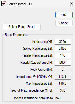

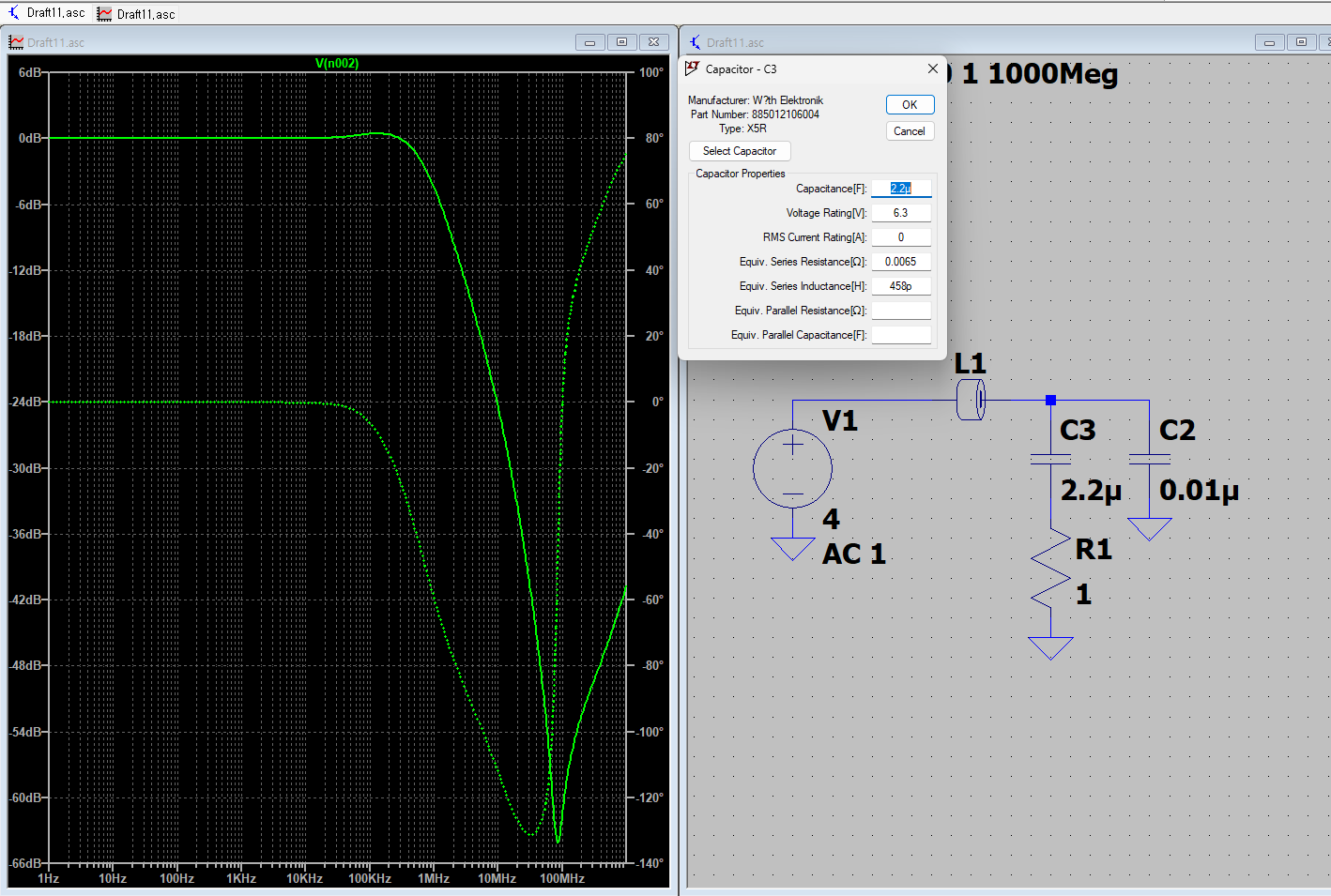

It does not.Regarding the use of a clock buffer, unless AK4497 includes an internal ASRC,
Currently I am simulating a Ferrite+C filter to prevent noise from being amplified.
There is a additional 10nF C to avoid losing high frequency bypassing performance due to damping resistance.
Of course fc should be lower
An ideal filter dint have one. But a real would implementation containing some iron do. A bead has a core or it sent one - right?

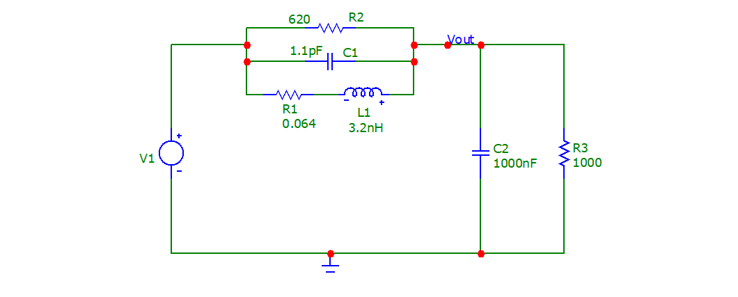

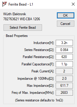

Ferrite bead Spice models are a combination of RLC networks. Hysteresis is not modeled.
E.g.
(from https://electronics.stackexchange.c...imulations-for-a-2-4-ghz-esp32-3v3-power-line)
E.g.
