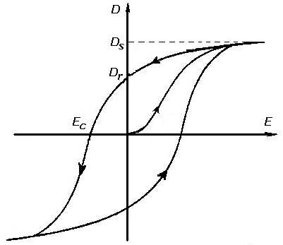

Yeah, I would say so. Its something to keep in mind.For example something like this?

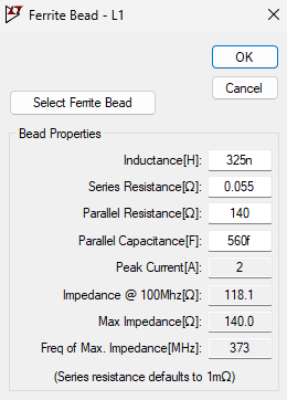

For some ferrite beads, you need to cut the inductance in parts that each get their own parallel resistance to model the real and imaginary part of the impedance reasonably well. Two parts are usually enough to get within 10 % for most frequencies.
No, it will be a small-signal model.
Hysteresis distortion/noise has been modeled, measured, and listened to. For a steady state sine wave you will see FFT spurs, since the minor hysteresis loop keeps retracing the same path. However, the particular hysteresis loop path may be frequency and signal level dependent. For non-steady state signals its more complicated.I think will be sufficiently quantified in matlab.

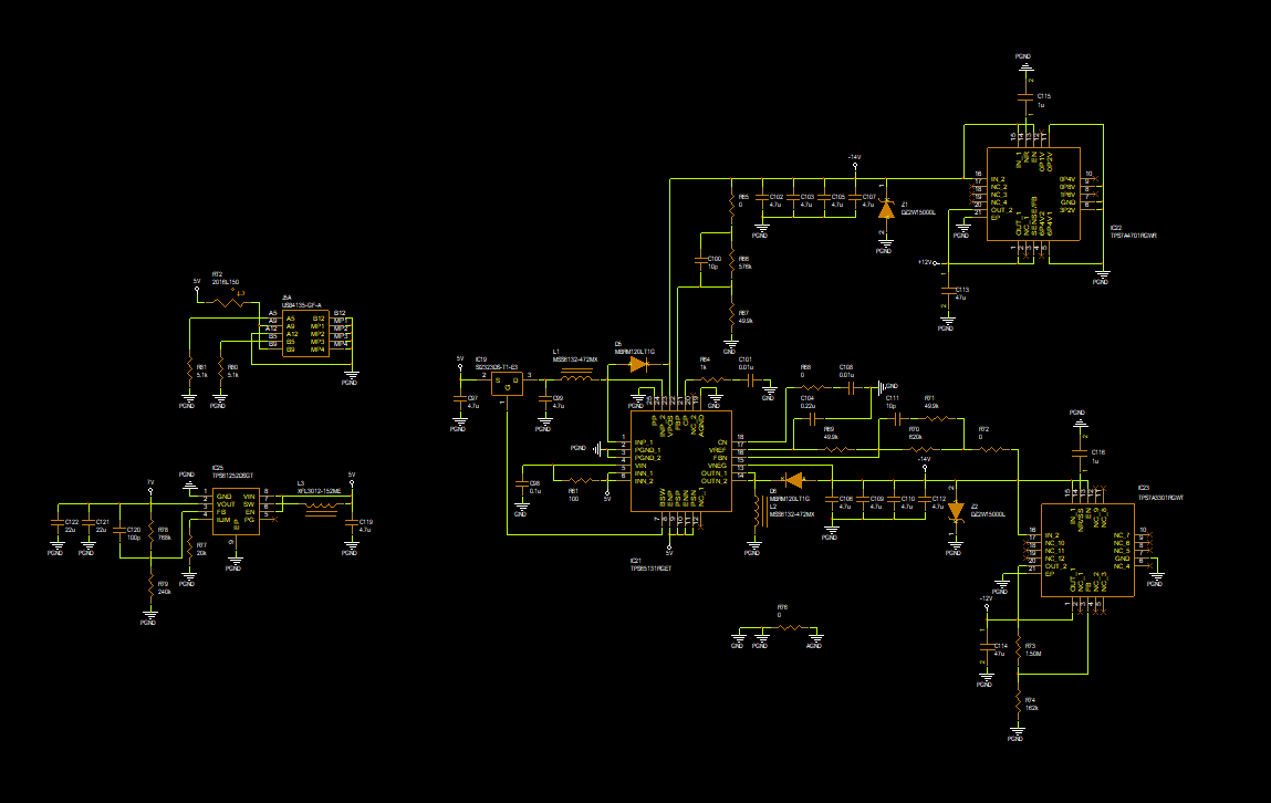

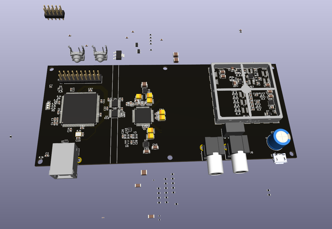

Maybe you should just work on planning the schematic before working too much on a conceptual layout. Sometimes electrical requirements should be considered first, before board visual aesthetics. Just sayin'
Still in progress.
-All terminals are replaced with USB C type.
USB 2.0: USB4110-GF-A
POWER: USB4135-GF-A
(GCT site has a user-friendly UI, only one attractive option, and simple numbering.)
-The LT3471 has been replaced by the relatively inexpensive and more modern solution, the TPS65131.
-The output stage follows the suggestion of altor.
However, opa1632 is replaced by opa1633, lme is replaced by opa1612,
The vref cap is designed to use vishay's 293D footprint and is designed to be 10~22uF. The additional bypass is NP0 100n+10n.
Also, I am conside lowering the order of the LPF by one step.

-This new split rail circuit outputs +/-12V.
- 5V to 6V for -5V (VDDL/R) uses TPS61252DSGT.
-In the case of -3.3V, 5V is supplied to the LDO through a 1000uF reservoir capacitor and LC filter without a switcher, forming 3.3V.
I think having only SE output is functionally disappointing.
The differential output of OPA1633 seems suitable for adding an XLR output terminal or TPA6120 through a relay.
