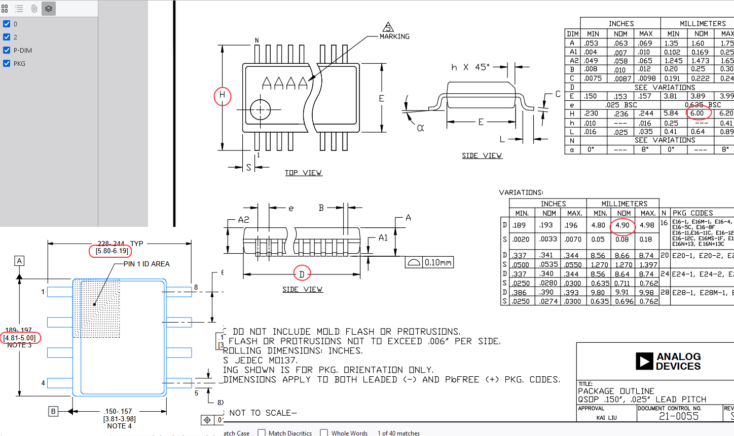

MAX14850. Smaller than ISO1640 and has 2+2 additional channels as well.Feel free to recommend an isolator for i2c that would work well with this!
Very good chip!MAX14850.
No however smaller - SO8 vs 16SSOP, and more expensive, but if 2+2 additional line required - very useful.
Alex.
Actually 16QSOP is smaller than SOIC8.No however smaller - SO8 vs 16SSOP,
Maybe I saw the wrong numbers.
16QSOP at MAX's datasheet is 21-0055
It's pdf can be found at https://www.analog.com/en/resources/packaging-quality-symbols-footprints/package-index.html
Also SO8 drawing from TI ISO1640 datasheet.
Both sises are app. the same - 6x5mm.
Alex.

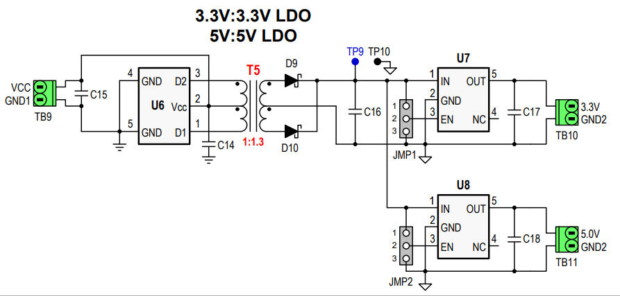

https://www.ti.com/tool/SN6501-MULXFMR-EVM
And I'm interested in this push-pull transformer driving.
Transformers come in a variety of turns ratios to form any voltage required and provide insulation.
I think that the isolation between the digital domain and the power domain makes the analog domain
behave like the body of a car suspended by suspension.

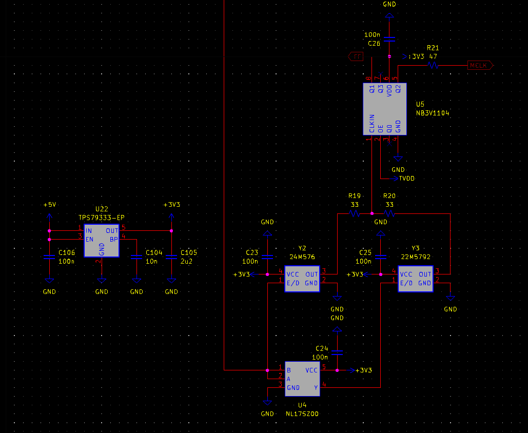

IMHO, there are few points:MCLK Schematic.
1) U2 - if you input voltage is 5v, better to use LP5907
2) R19 R20 - one common resistor is enough.
3) U4 - I usually use simple transistor, let say 2N7002 + 2 resistors, but this is not important.
4) If the oscillators are located <5-7 cm from the DAC chip, U5 is not needed.
Alex.
Even better choice for U22 is TPS7A2033 and for U5 LMK1C1104 is cheaper.
