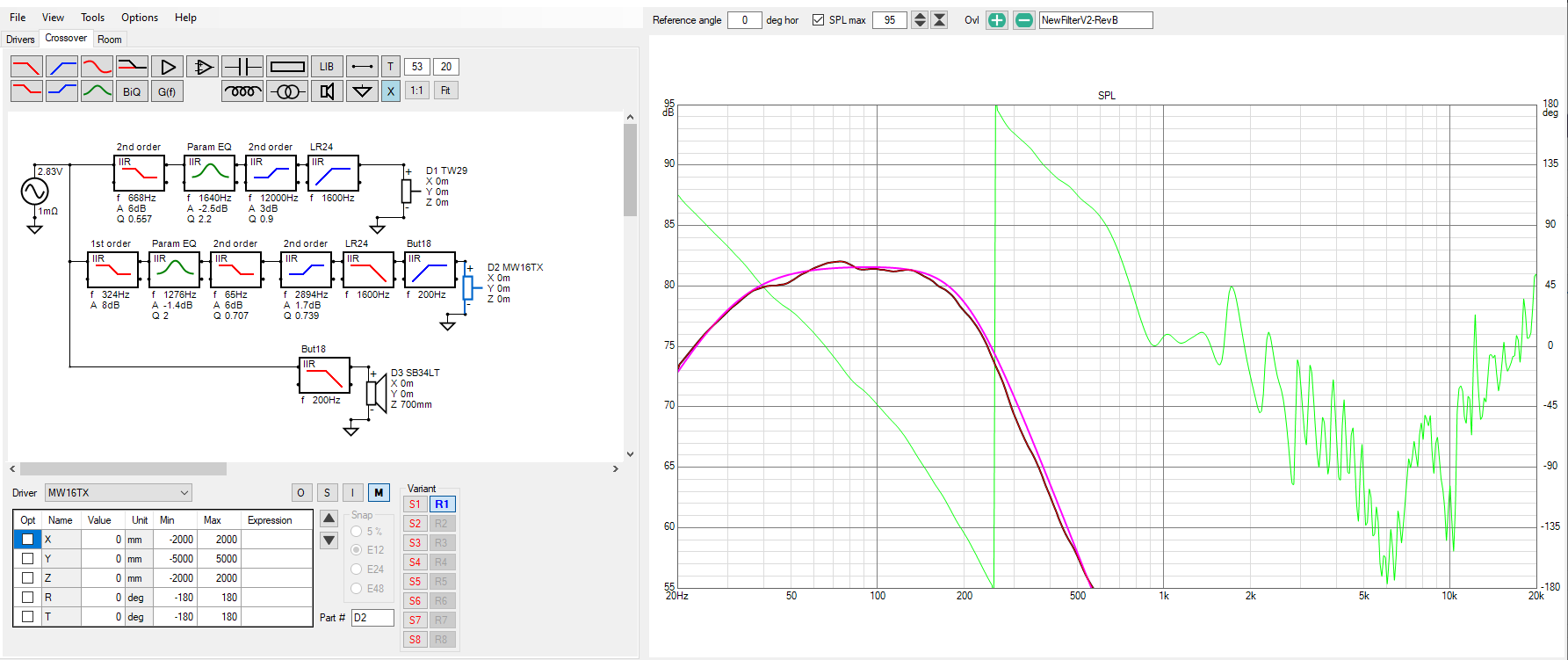

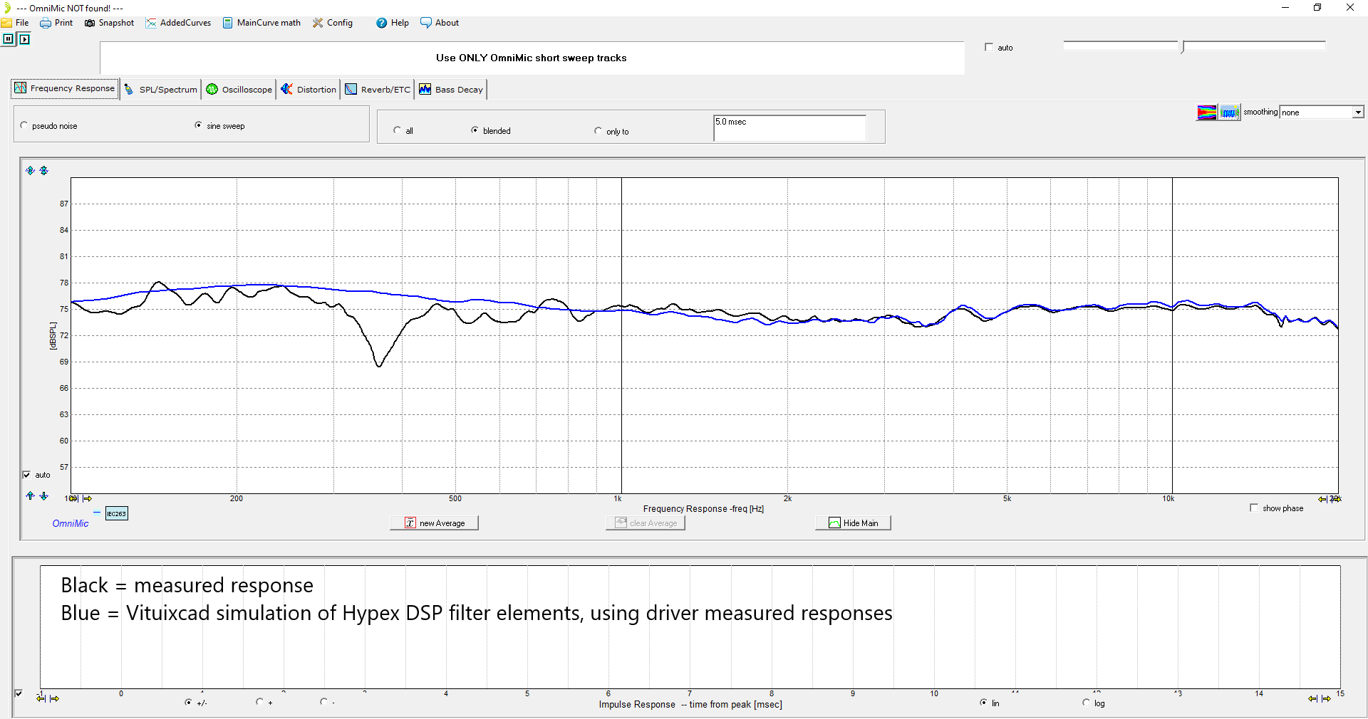

I was curious about the process of designing the DSP filtering for the Hypex amps in a simulated environment, specifically Vituixcad. I already have a workable filter which I developed by iteratively taking measurements and adjusting the filter. I thought the best way to explore the simulation process would be to implement my existing filter in Vituixcad and compare the predicted response to the measured response.
The simulation is based on the individual driver frequency response measurements. The far field gated measurements were merged with the near field responses. I modelled the baffle diffraction effect in Vituixcad, and it provided a 4-pi equivalent low frequency response which was merged to the gated responses. Then each biquad element in my Hypex filter was duplicated in Vituixcad.
I was expecting that there would be some differences in the curves, and I would have to explore each biquad to compare simulation to measured. However, I mildly surprised at how close the simulation matched the measured. Above 1 kHz it is almost an exact match. Below 1 kHz the simulation is smoother because the near field response is used in the simulation. The measured system response, on the other hand, uses a blending feature to merge the room response to the gated measurements below the gating window frequency. So a difference would be expected below 1 kHz, but overall, the two curves are very similar.
In the past I had some trouble with this exact same comparison on my SB17CAC / SB26CDC system. I can only assume that I had some measurement error or a simulation problem.
Now I have more confidence in refining my DSP filters using simulation.

That is very good agreement and given how hard it is to take far field measurements without the influence of reflections gives good insight into what is happening. There doesn't seem to be any issue with the filters matching this time, now you can move on to different target slopes or refining the crossover matching from the comfort of wherever you use your computer 🙂Now I have more confidence in refining my DSP filters using simulation.

I am attaching my Vituixcad simulation. The filter elements are exactly as implemented in the Hypex HFD software, except for the gain on the woofer. I was using an older near field woofer measurement in the sim, so its level is not consistent with the mid and tweeter levels.
...do you measure all drivers from a single microphone point or do you measure all drivers on its on-axis, you adjust mic height to each driver?
When designing a speaker, Kimmo recommends aligning the mic on each driver’s axis. However, I am not designing a new speaker at this point, I am comparing simulated to measured responses, so I took all measurements from the design axis. For this project I decided the design axis would be the midpoint between the tweeter and the mid (see pic), at a distance of 66 cm. All far field driver responses, as well as the whole system response, would be taken from this point.

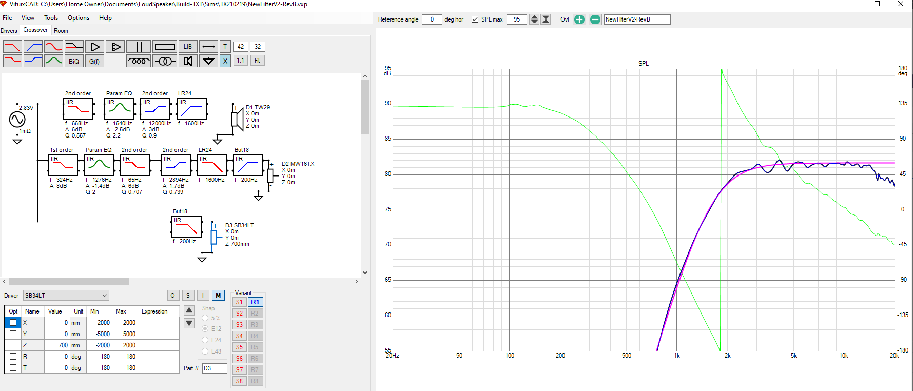

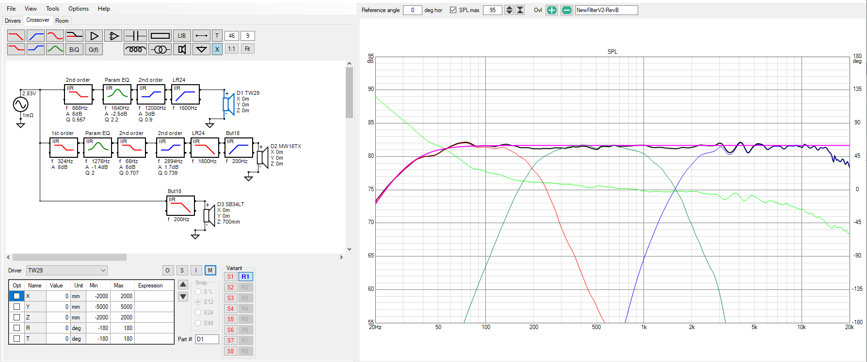

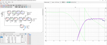

For this next round of filter development, I decided to simulate in advance. And I must admit, it worked better than I expected.
In post 106 I showed the results of simulating (after the fact) my initial DSP filter. Since then, I have slightly refined each driver’s measured response by more carefully merging the near field to the gated far field.

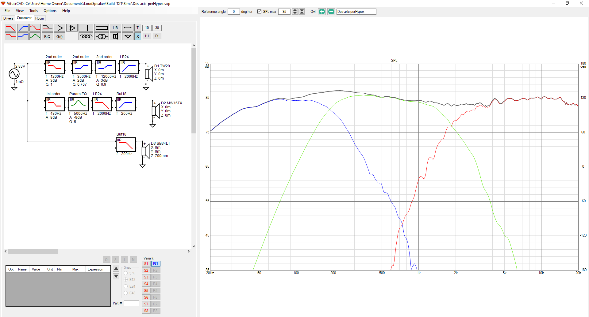

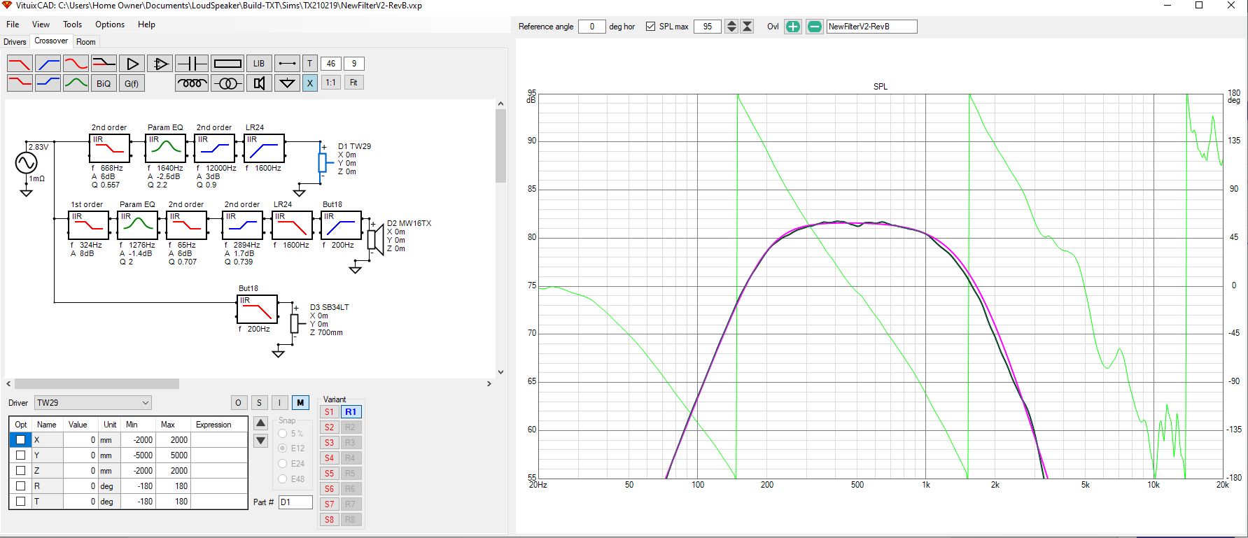

For this new filter, I began with a target response for each driver. The first 3 graphics show the simulated tweeter, mid driver, and woofer responses compared to the idealized target responses (in magenta “purple”). I think I am matching the target curves pretty well. The more I use VituixCad2, the more impressed I become. Truly a great tool.
The next graphic is the complete system simulation. It looks outstanding, I am within 1 dB of the target response from 20 Hz to 16 kHz, except for a few diffraction related burbles between 3k and 5k. However, simulations mean nothing if they do not agree with reality.

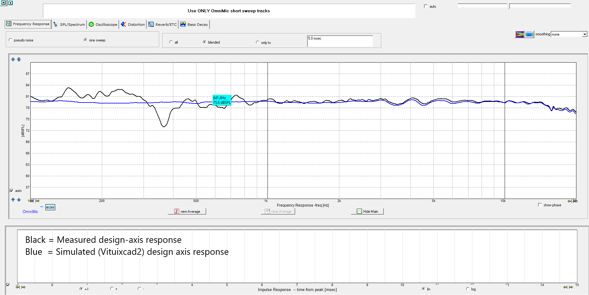

The next plot shows the VituixCad2 simulation compared to the measured response. My gating window is 4.3 ms (floor reflection), so OmniMic software blends in the room response below that point. I am showing 100 Hz up, because below that the room modes become dominant. Overall I am quite pleased with how closely the simulation matches the measured response. The final plot is the system measured response with 1/6 octave smoothing. I like 1/6 octave smoothing because it tends to mimic how we perceive. I believe that peaks and valleys which do not show up in 1/6 octave smoothing are insignificant. I show the mid and tweeter responses here.

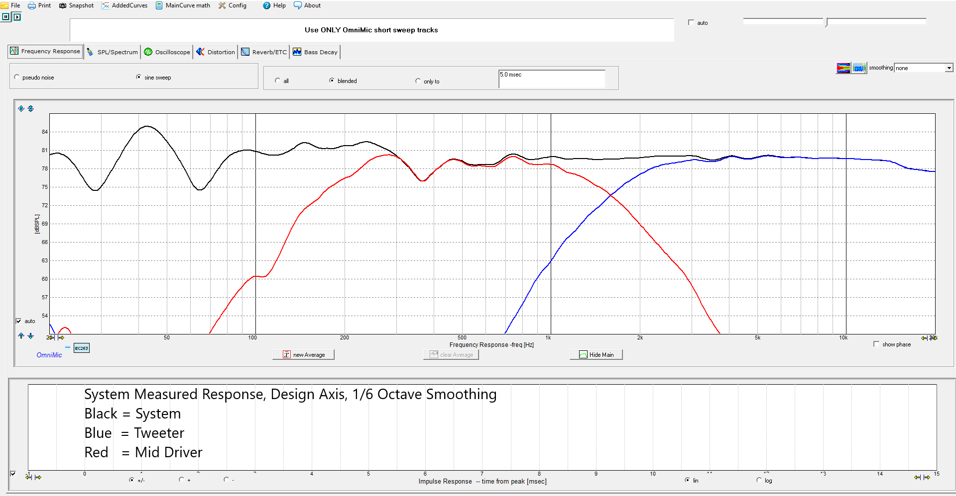

A few other things I neglected to mention...
I found that I still needed to set my driver levels in Hypex HFD based on direct measurement. The gain settings in the VituixCad simulation were within a few dB, but to really match the simulation I had to adjust each driver by hand. This is possibly some error on my part, or perhaps it is a difference in how Hypex and VituixCad interpret the gain on various filters and shelving function? not sure.
The other aspect which does not simulate well for me is driver delay. This is entirely expected because I use a USB microphone and this is a well known limitation to this kind of system. My solution is that I made my simulations based on a simulated delay which generated the maximum possible inverse polarity null. When I loaded the DSP filter into the Hypex amps, I experimented with delay until I generated the deepest inverse polarity null. At that point I was satisfied that the simulation and the actual DSP filter were equivalent.

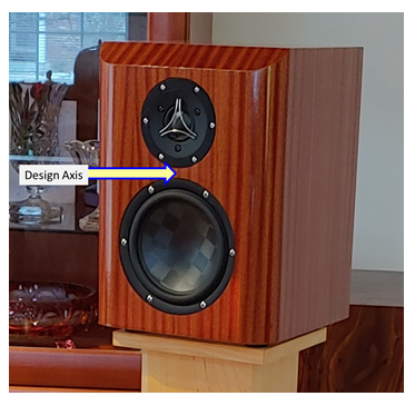

(3) The design axis of the ceramic system is the tweeter axis. For the textreme system, the design axis is the midpoint between the tweeter and mid.

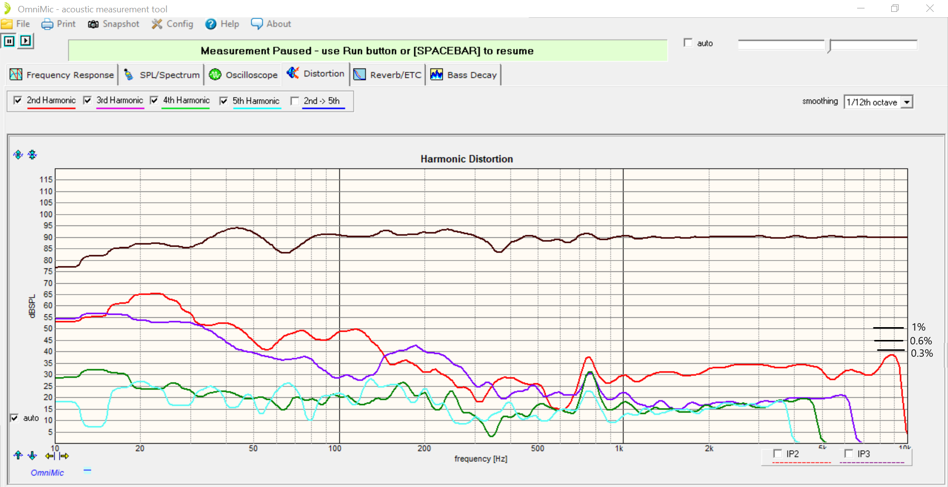

I ran the harmonic distortion measurements yesterday.
My view of HD is that once it is below the audible threshold, it does not matter. Based on surveying a lot of different sources, it seems like 2nd order HD is not audible on program material until it is above 2%, and even when audible, it is not unpleasant. Odd order HD is more intrusive, so I like it to be below 0.5% if possible, but definitely below 1%.
I still need to put the cabinets face-to-face and do the "Remlab cancellation null" test to assess cabinet radiation. And at some point I will re-do the off-axis responses, but I really do not expect there to be much difference from post 96.
