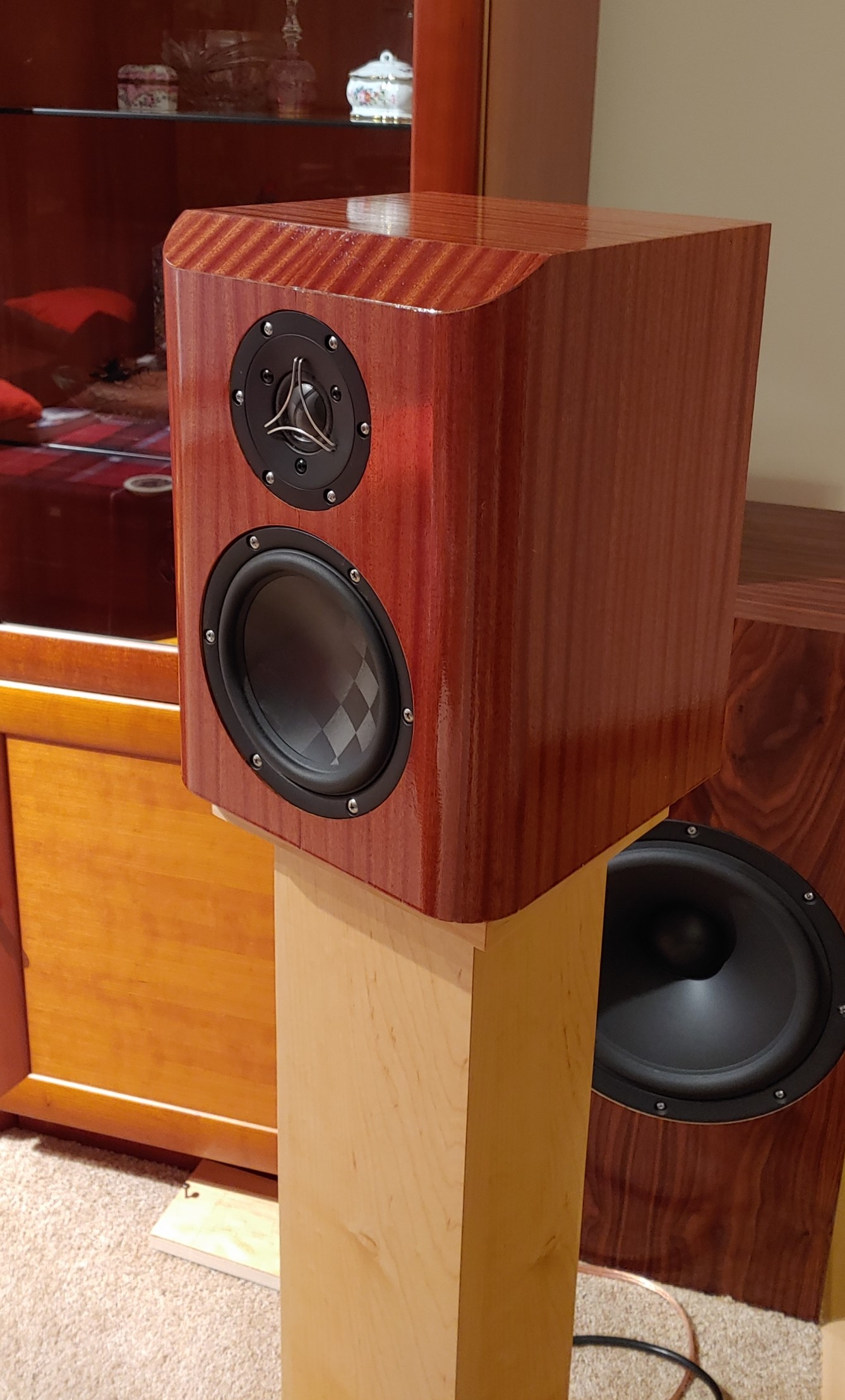

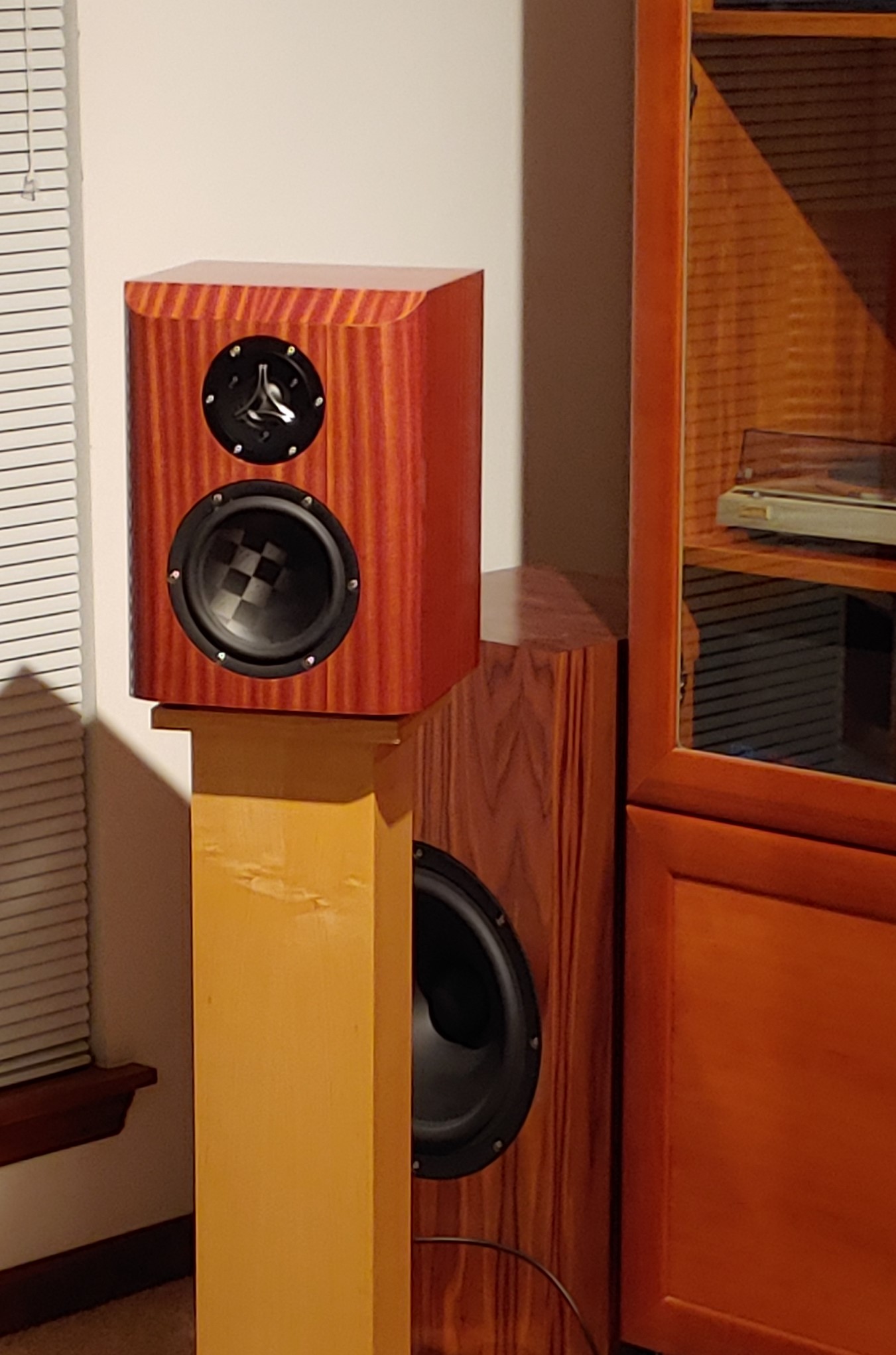

Cabinets are complete. I have always had good luck with General Finishes Arm-R-Seal urethane varnish, so this is what I used... I applied it with a brush, and sanded between coats.
I stuffed the cabinets with long fiber wool. I was worried I would not have enough, but I had just exactly enough. I would have used ultra-touch shredded denim if I had needed more (see Augerpro's excellent thread https://www.diyaudio.com/forums/mul...on-methods-shootout-thread-9.html#post6301785 )
In my modular design, speakers are attached to the stand with a 5/16" bolt. The speaker has a T-nut in the center of the bottom panel. Wires exit the speaker through a small hole in the bottom, and connect to a terminal block in the stand using ring terminals.

Wow! Beautiful!!

Celef
I disagree, it should be rotated one pinhole to the left. 😀
Just kidding, you're right🙂

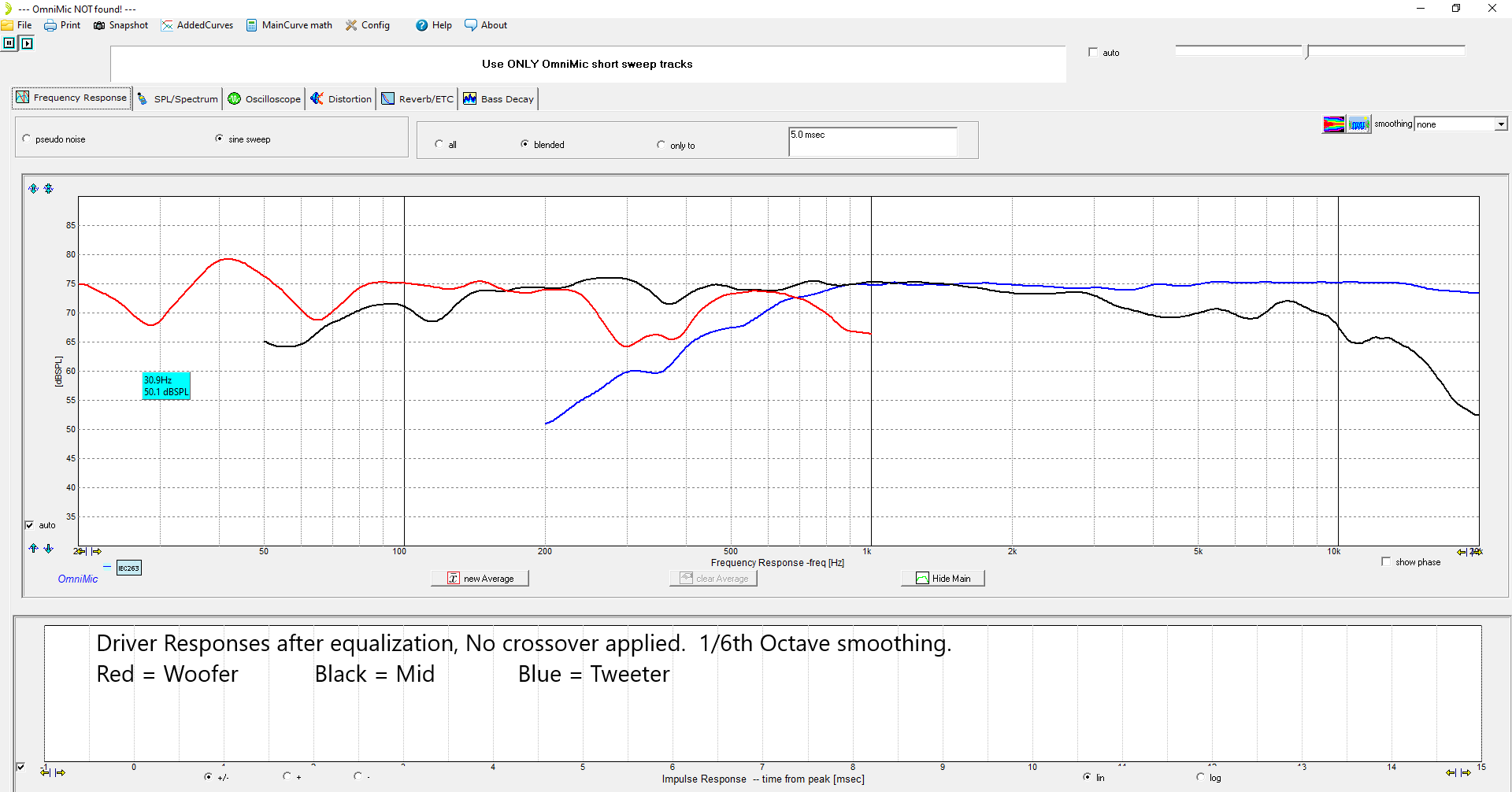

Well I have some measurements.
I stuck with the filter development method I am comfortable with, i.e. develop the eq in real time while measuring as I described in post 76. Apologies to AllenB... I did not want to learn a new skill just now.
This is my first prototype DSP filter. It is not complete, I intend to keep tweaking and "voicing" over the several weeks or months. For now I started with a BW3 crossover at 200 Hz (this worked well with the previous system) and LR4 crossover at 2000 Hz.

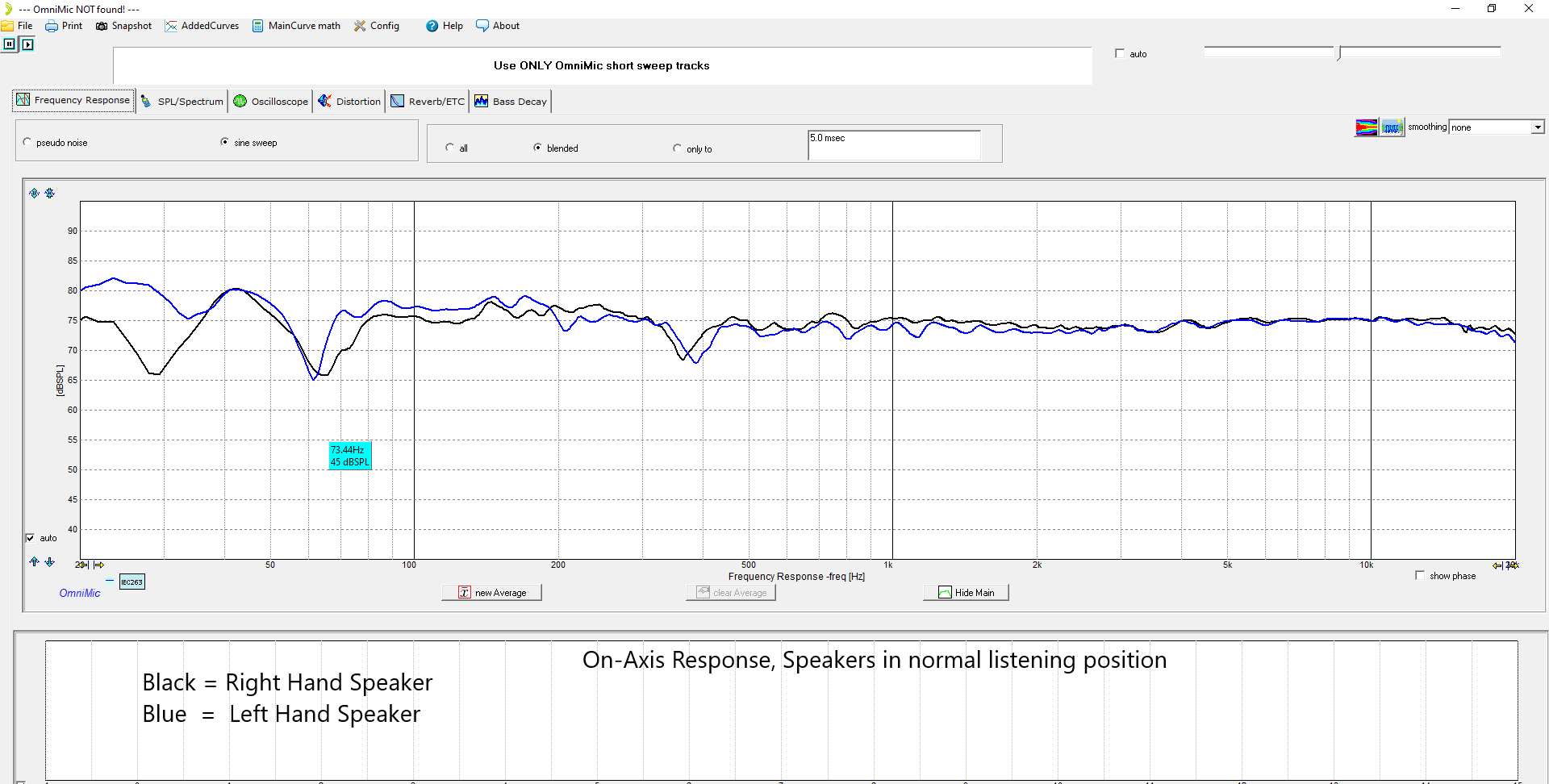

The first plot is the left and right speakers, as measured in their normal positions. The gating window was about 4 ms, and Omnimic blends in the room measurement below the 4 ms cutoff.

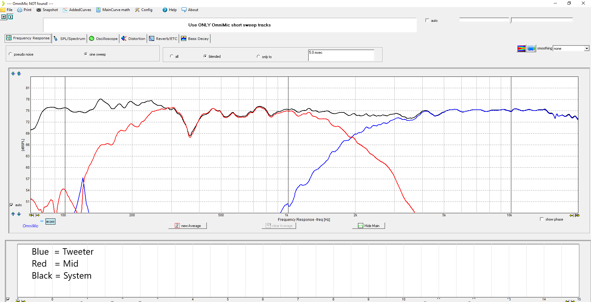

Next plot is the tweeter and mid plotted with the full system response.

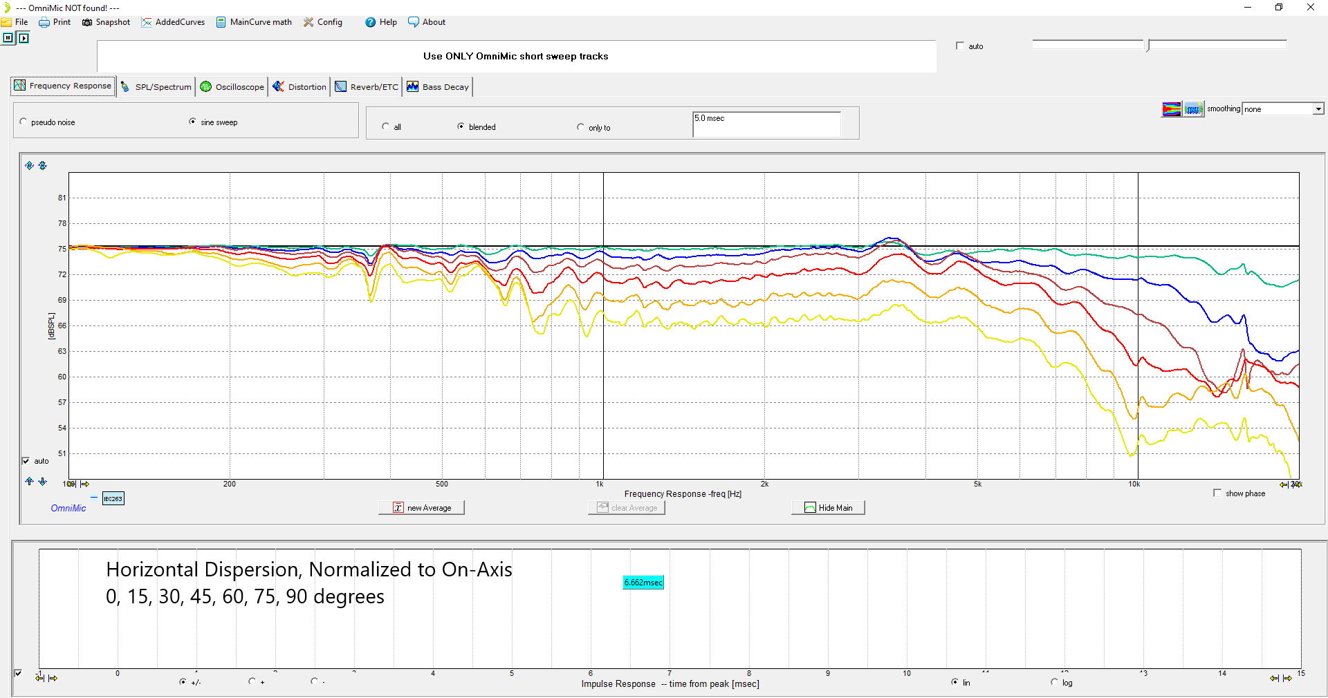

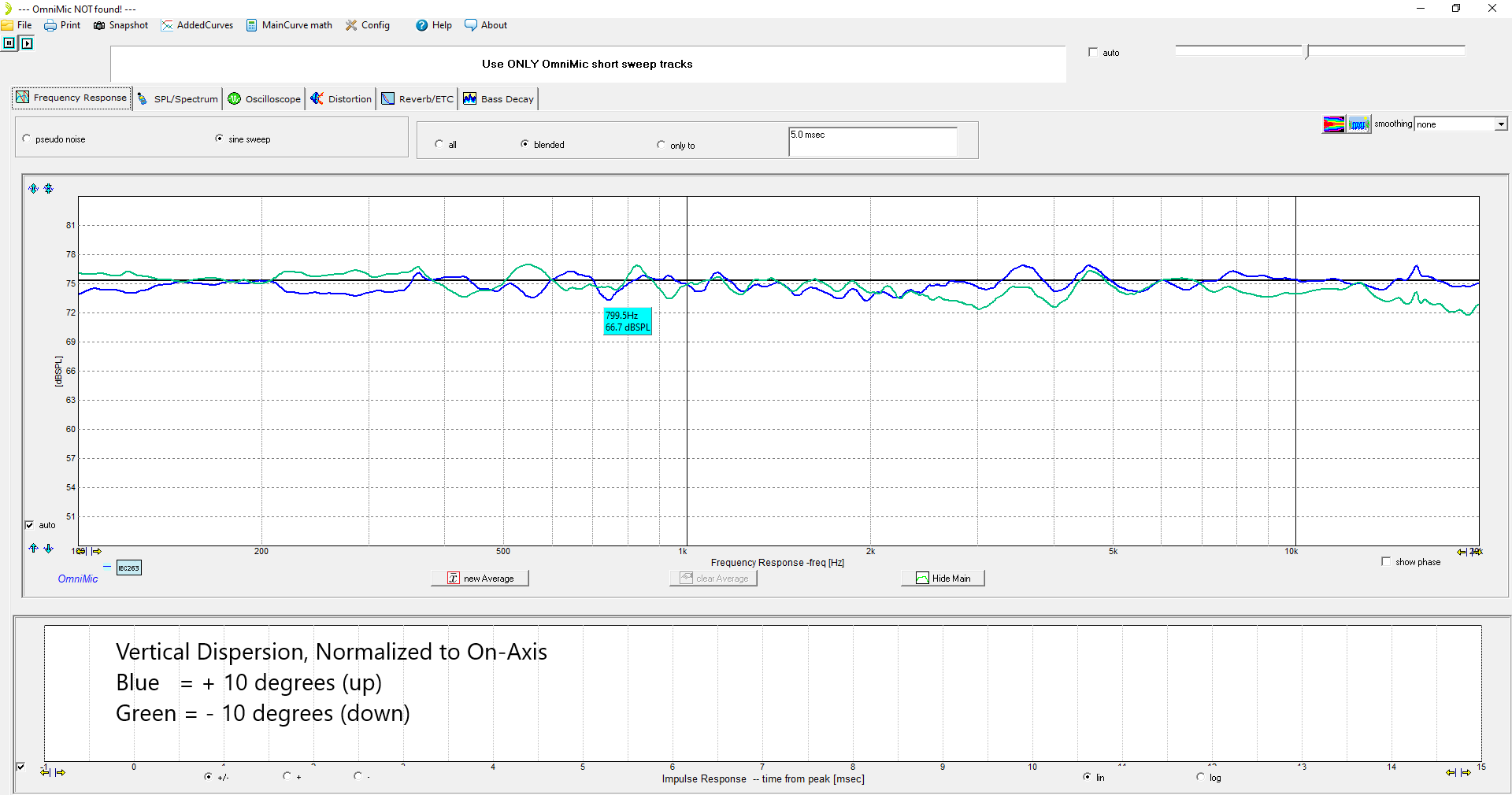

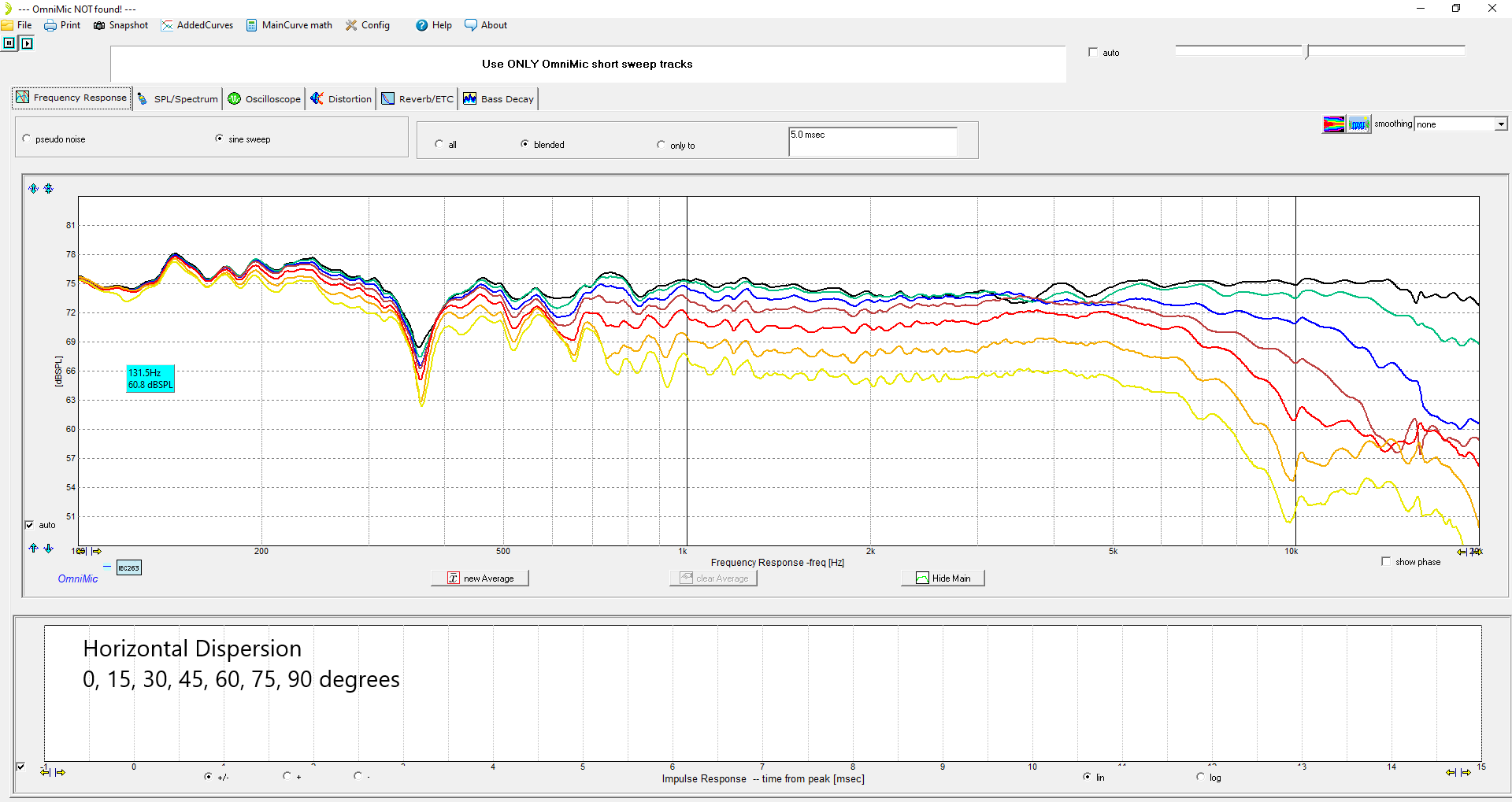

Next is the horizontal and vertical dispersion plots. I am pleased with the polar response.

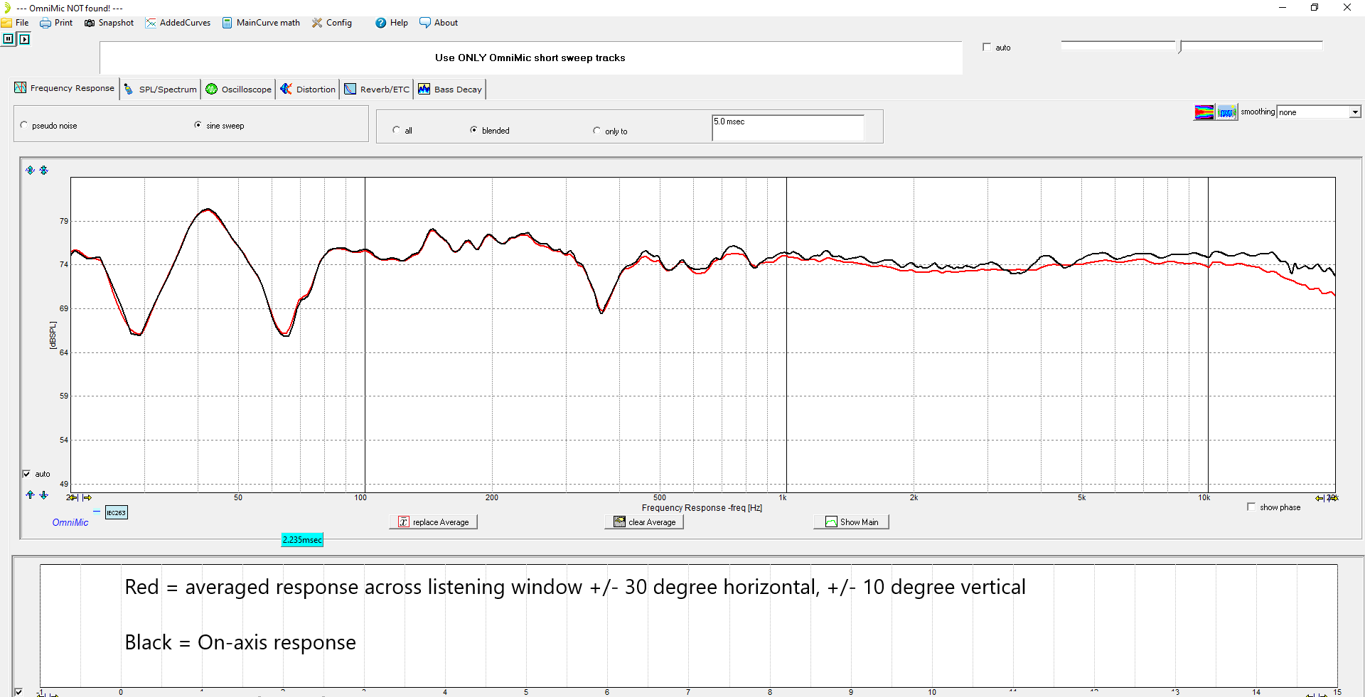

The final plot is the drivers with all EQ applied, but without the crossover filters.
I think I have enough data to load into Vituixcad and have it calculate a listening window, directivity index, and power response. It will be the first time I have used that feature of Vituixcad.

Looks pretty good so far, only a few bumps in the tweeter of a dB or two left.
Vituix will give you a response but you don't have enough vertical data or fine enough horizontal data to be sure that what it predicts is what you have.
You do actually need 5 to 10 degree resolution over the full 360 degrees in both directions for an accurate power response and free space DI. Limiting it to the frontal hemisphere cuts down the measurements and allows you to get close enough to guess what the full space will do.
The accuracy of how you take the polar data matters too for this sort of thing much more than a quick look to see that the off axis isn't too bad.
Having a rotation table with index marks allows you to take repeatable polar measurements and make sure you have taken them with the mic the same distance relative to the source, the vituixcad document I linked before explains it better than me.
If you are already doing that then ignore the above 🙂

looks good, but i would rotate the woofer one pin hole to the right
Ha! I knew someone would bring that up...The textreme checkerboard pattern on this pair of drivers does not look right if it is vertical or horizontal. The factory managed to align the pattern with one pair of screw holes, but the pattern is not symetrically aligned. It is off-center, so it does not look right. Perhaps this is for resonance control, assymetry being less resonant. In any case, an angled look seemed to work best for aesthetics.
I know this is a big deal for some people... the textreme thread was consumed with this issue for several dozen posts.

10 degree over 360 degrees sounds like a lot of work. Perhaps I will learn to be happy with the measurements I have. It can be a future project.
I pushed for high accuracy in my measurments. I taped a paper protractor to the top of the cabinet and lined it up with the mic, and I measured the distance from the baffle centerline to the mic for each sweep. I used an improvised rotation table. Realistically I estimate my margin of error was +/- 2 degrees on angle, and +/- 1 cm on distance.
I averaged the response across a +/- 30 degree horizontal and +/- 10 degree vertical window, and I compare it to the on-axis.
The perturbations in the on-axis between 3k and 7k do not show up in the listening window curve, so it would seem to be diffraction. Other than baffle step, I don't believe in correcting for diffraction. However, I might try reducing the tweeter level by 1 dB. I have a slight elevation from 4k to 10k, and on some music I think I can hear it. I also want to experiment with a 1.6 kHz crossover between mid and tweeter.

What are you hoping to learn from the listening window average? As data, it seems to be an element of the spinorama commercial speaker evaluation criteria... As a DIY tool it stops short of room power and goes past listening axis response.
From the Toole and Olive preference research the listening window is the most representative of the way the speaker was rated. It also represents an area of space where a number of people could be listening so having the listening window be very similar to the on axis response suggests that the speaker will sound very similar over that area. Being a spatial average it does get smooth minor irregularities between curves due to diffraction etc. but the biggest problems should remain, checking the individual curves is still good practice because a flat result might be because there was a big dip and a big peak that cancelled out.As data, it seems to be an element of the spinorama commercial speaker evaluation criteria...
Your baffle is symmetric horizontally so you could get away with half the measurements and just mirror them. Vertically you couldn't do that but lying the speaker on it's side and using the rotation table makes it fairly easy.10 degree over 360 degrees sounds like a lot of work. Perhaps I will learn to be happy with the measurements I have. It can be a future project.
If you took the full set of measurements that are needed for the Early reflections curve then you could compute the ERDI with accuracy but that is still quite a lot of measurements, you could cheat and only use 3 rear measurements as appeared in the way the standard was first written, but you see here the effect of that on the DI.

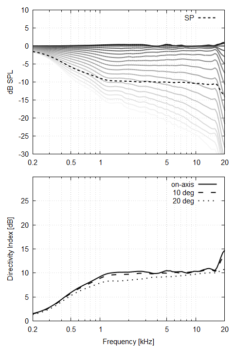

Spinorama! (also known as CTA/CEA 2034 but that sounds dull, apparently) | Page 3 | Audio Science Review (ASR) Forum
Working out the soundpower is difficult without making all the measurements. As you can see in this graph no off axis curve is particularly representative of the SP curve.
