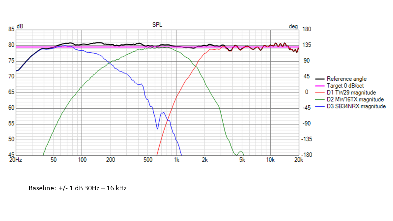

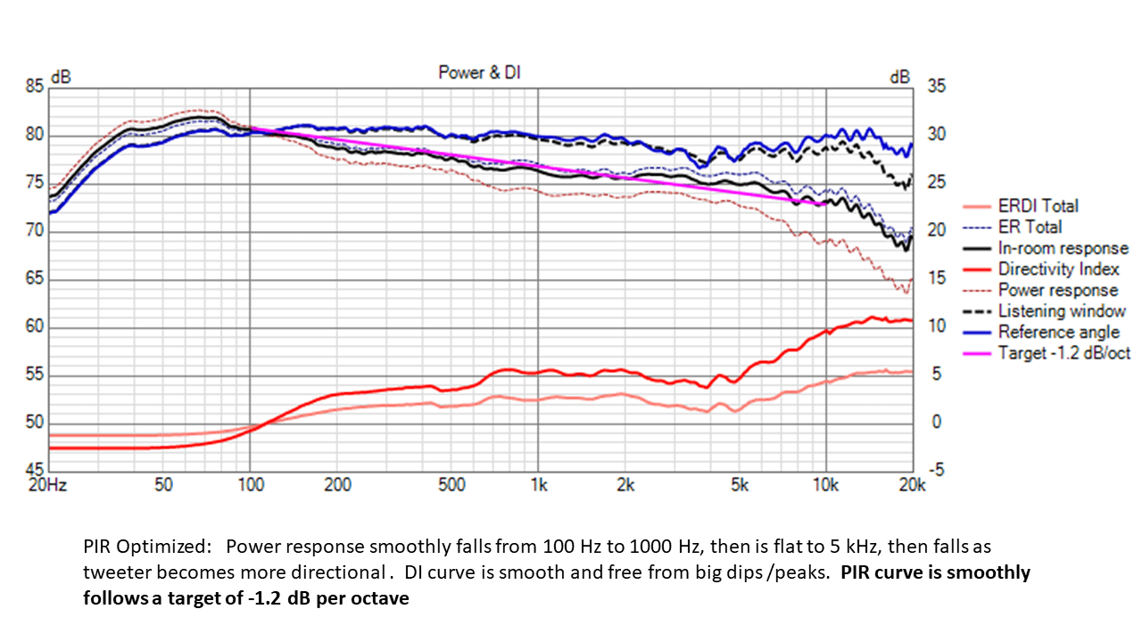

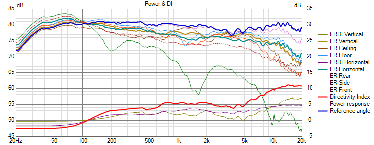

In September 2022 I made a completely fresh set of full polar measurements, vertical and horizontal, and new near-field responses. I re-did the merging of NF with the gated polar responses. Thankfully my new measurements were very close to the old ones.

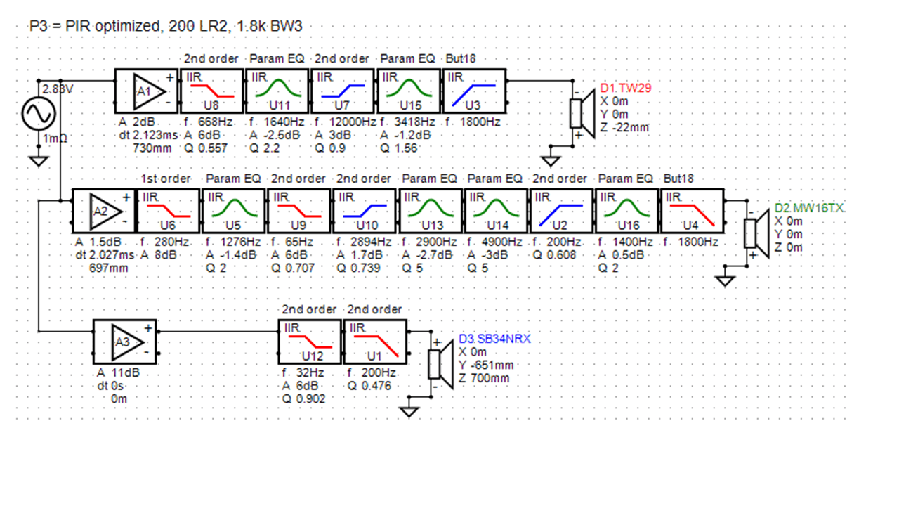

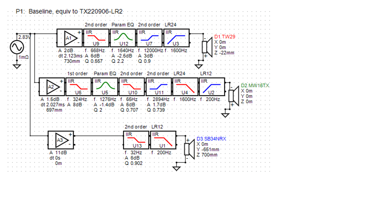

I have continued to refine the DSP filtering for this system, based on things I learned from my other project: https://www.diyaudio.com/community/threads/new-project-tower-3-way-with-twin-8s.378223/
As well as things I have learned from our discussions with @vineethkumar01 and @tktran303

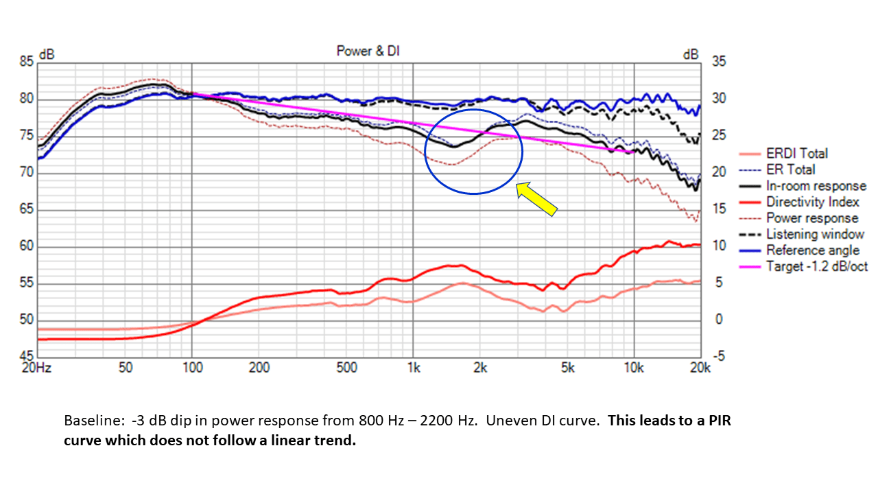

For this phase of development, I decided to put more emphasis on Predicted In Room response (PIR).
This system has a center-to-center spacing between mid and tweeter of about 0.75 x wavelength. This is not optimal, and as I acknowledged earlier in the thread, I made this decision before I had the knowledge I have today. Now we know that a CTC spacing of about 1.2 x wavelength can lead to a better result when using a non-waveguide tweeter.

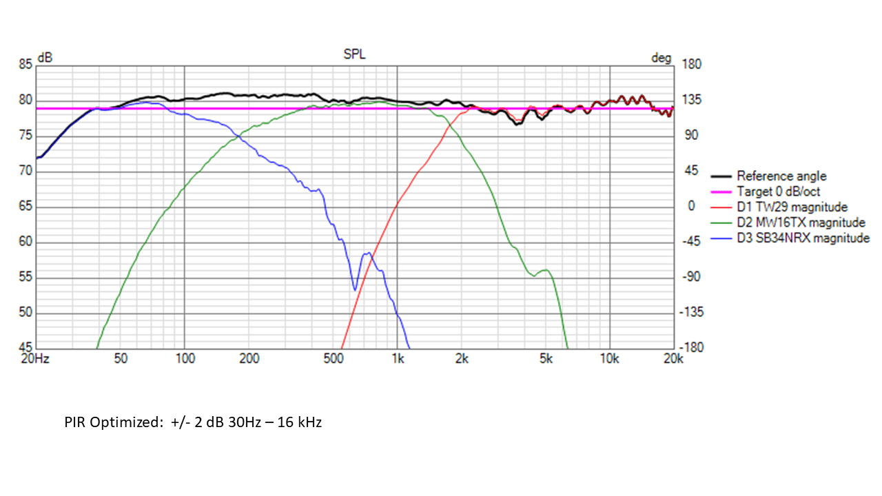

Nonetheless, I found that it is possible to achieve a good power response and a good PIR curve even with a non-optimal CTC spacing. It was necessary for me to relax the on-axis requirement from +/- 1 dB to a less restrictive +/- 2 dB.

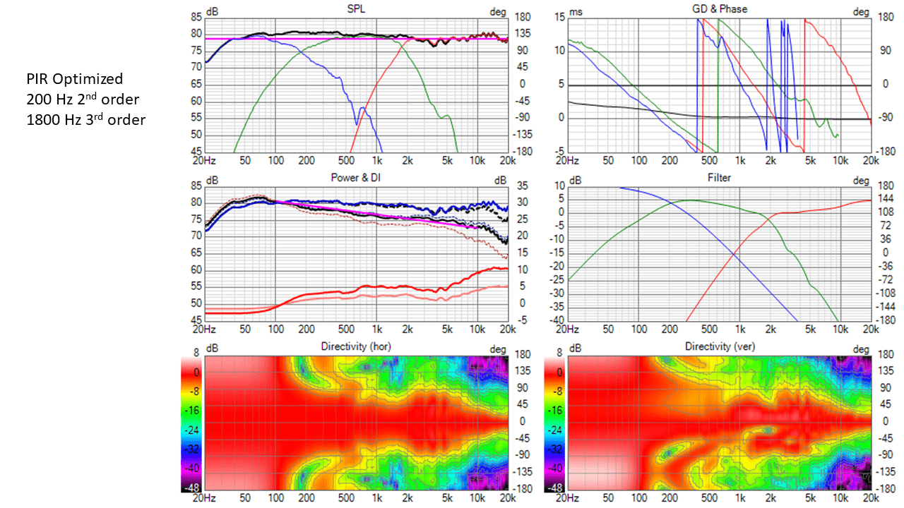

The natural directivity of the tweeter at 10k showed me that a -1.2 dB/octave slope in PIR should be achievable. With this goal, I was able to apply some subtle EQ to get the PIR curve within 1 dB of this target goal, and yet still keep the on-axis response flat within +/- 2 dB. The results look quite good on paper.
How does it sound? Compared to baseline, it sounds very similar. It took me a while to get accustomed to how the two filters sounded different. The baseline filter can have a certain “hardening” of the sound on piano notes in the upper registers, and on soprano voice. The PIR-optimized is “sweeter” on those same notes. On the other hand, the baseline can have, with the right recording, an impression of spaciousness that is slightly wider. These are small differences, the kind that are only apparent with certain recordings.
For now, I think I like the PIR-optimized better, so I have been listening to that one.

Nice experiment. I like that you give also listening differences, not only graphs...that is really precious. Regarding, "harder" and "softer" sound, before you had small "BBC hill" at 3kHz, now there is wide "BBC dip" from 2-4 kHz...and of course much smoother graphs without jumps...
What about general soundstage, did it move maybe a little bit in some direction with new filter?

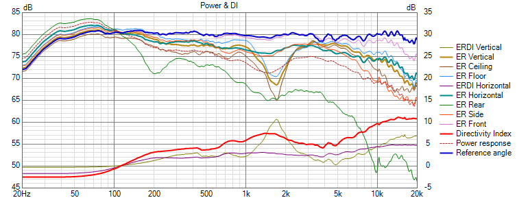

Interesting stuff Jim. I assume most of the benefit for in-room response came from the vertical direction? How do the floor and ceiling reflection compare? What is your ceiling height?
My theory is that, in the PIR-optimized filter, the vertical and horizontal ER responses balance themselves out. My ceiling height is 8'

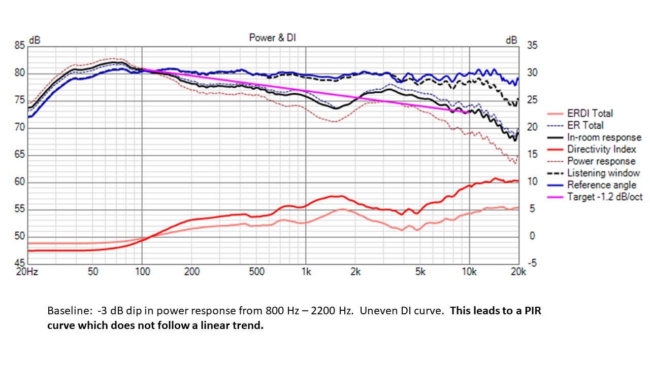

Above is the baseline. The ERDI-horizontal is nice and flat, but the ERDI-vertical has a big peak.
Above is the PIR-optimized. Both ERDI-horizontal and ERDI-vertical are well behaved.

Others have suggested that a rising response from 1k - 3k will add a sense of harshness to the sound, and it doesn't matter if the rise is in the on-axis, the ER response, the power response, the PIR.
In the attached graphic you can see I have a rising response from 1.5k to 2.5k in the power response, ER response, and PIR, but not in the on-axis or listening window. This could explain the slightly "harder" sound I hear on upper register piano and soprano voice. Since the bump is not present in the on-axis, it is not immediately apparent, but it is enough to affect the timbre in a subtle way.

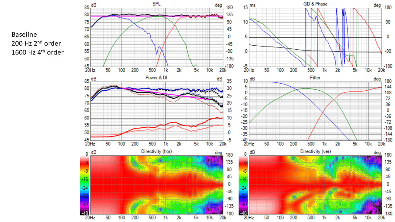

There once was something about better power response of Butterworth alignments, wasn’t there? The phase difference at Xover on the PIR optimized one seems you have targeted on that alignment, be it fully aware or rather coincidental. What do you think?
I knew from simulations with ideal drivers and 0.75 CTC that a 3rd order crossover would result in a better sound power response. Because I have the freedom to delay the tweeter, I can use 3rd order butterworth. With a passive crossover in the same situation, I would have probably tried the quasi-3rd order LR, since it works best when the tweeter has 20-40 mm closer acoustic center.
When the spacing is 1.2xwavelength, it is possible to get 2nd and 4th order filters to give a good sound power response.
