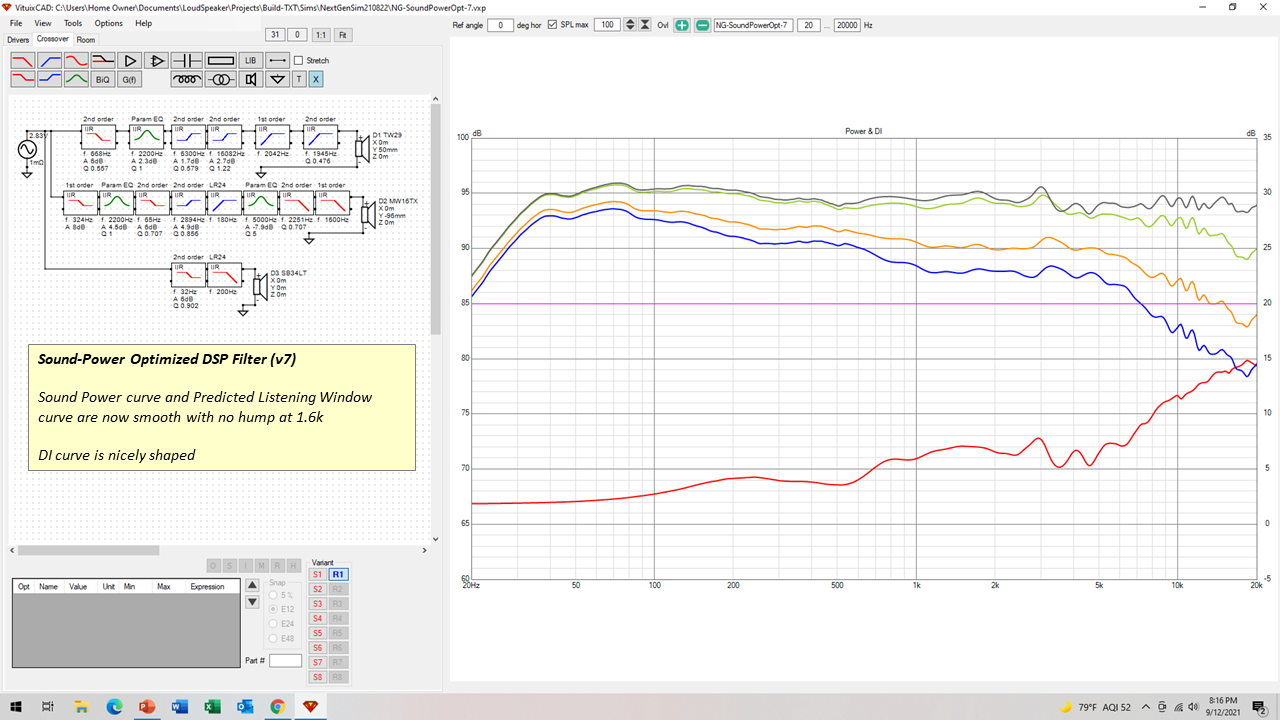

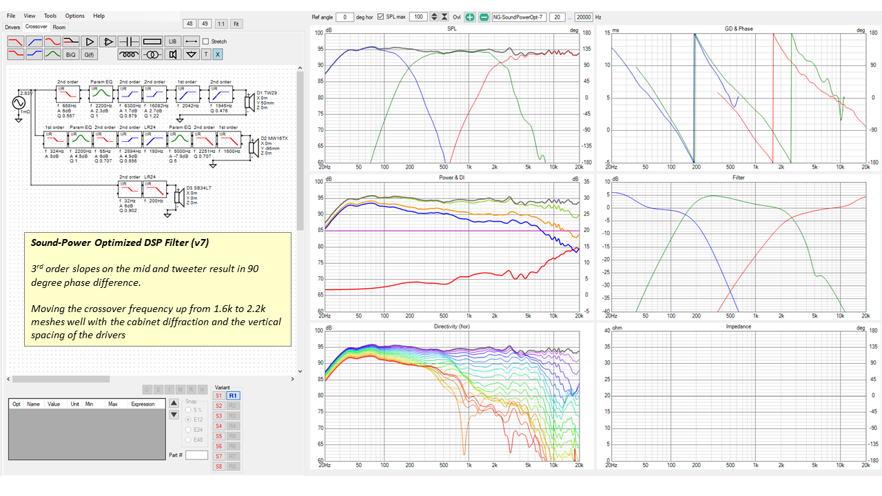

Last week I finalized an alternative DSP filter which optimizes the predicted sound power response while maintaining nearly the same on-axis response. I went through 7 iterations, so for clarity in my graphics I call it "Sound Power Optimized DSP (v7)".
Thanks to some hints from Kimmo, I tried non-symmetric 3rd order slopes on the mid and tweeter. Actually, I tried a lot of combinations, but this is what worked the best. A classic BW3 response got me close, but to really optimize it, I had to combine a 1st order slope with a 2nd order slope, and then vary the Q and frequency of the 2nd order filter.
As can be seen in the graphs, the Sound Power, Predicted in-room, and DI curves are all very nicely behaved.

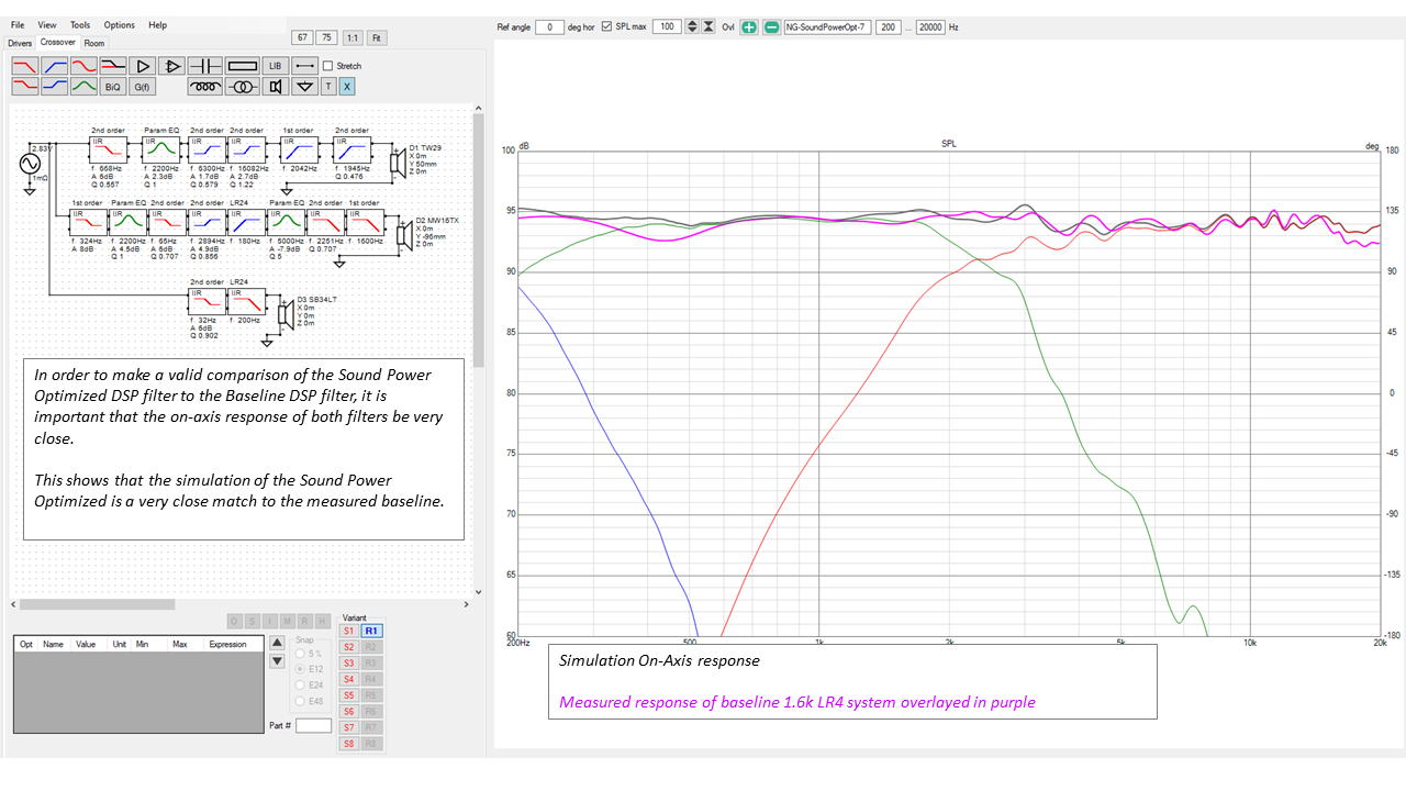

To make a fair subjective evaluation, it was important that the baseline filter and the new Sound Power optimized filter have very similar tonal balance. The second graphic show that I did not succeed perfectly, but I think it is close enough. Just to be clear, the baseline filter is LR4 at 200 Hz and 1.6 kHz, as shown in posts 156 and 157.
So how does it sound?

The Sound Power Optimised V7 mid and tweeter's phase relative acoustic phase doesn't look as good as the other one...
The main directivity of the design is set by the geometry of the drivers used. The rapid fall in soundpower due to the increasing directivity of the tweeter and the general slope is pretty much the same in both. There is a 3k resonance which is more pronounced in the later version which could explain why you like it slightly less.And now I am perplexed by what this all means.

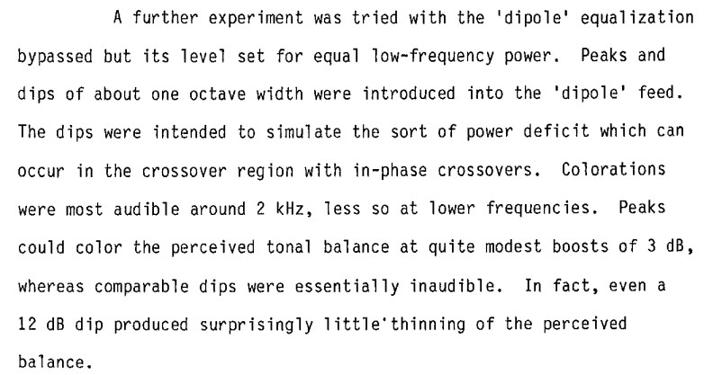

Lipshitz and Vanderkooy found that power response holes can be quite severe without them necessarily being audible.
Your experience would seem to bear that out.

No it does not. It seems that, with my baffle layout and driver directivities, the only way to get both a flat on-axis response and a flat power response is with a 90 degree phase difference between the mid and the tweeter. If the tweeter had a waveguide, it would be a different story. If the drivers had been spaced with 1/4 wavelength spacing, different story.
Yes, and I am not sure of the source of that resonance. It is in the mid driver raw response but not the tweeter. However, when I measured the mid driver in a 60cm x 60cm foam board baffle last october, I found no resonance. It could be a cabinet resonance perhaps? I had assumed that such a high resonance, and with such a high Q, would be inaudible, but perhaps with very critical listening it is revealed? In any case, the 1.6 kHz LR4 filter eliminates it.
Now that is very interesting indeed. I had been viewing the power response of the baseline system (post 156) as a problem to be solved, but perhaps it is not. Thanks for that information.

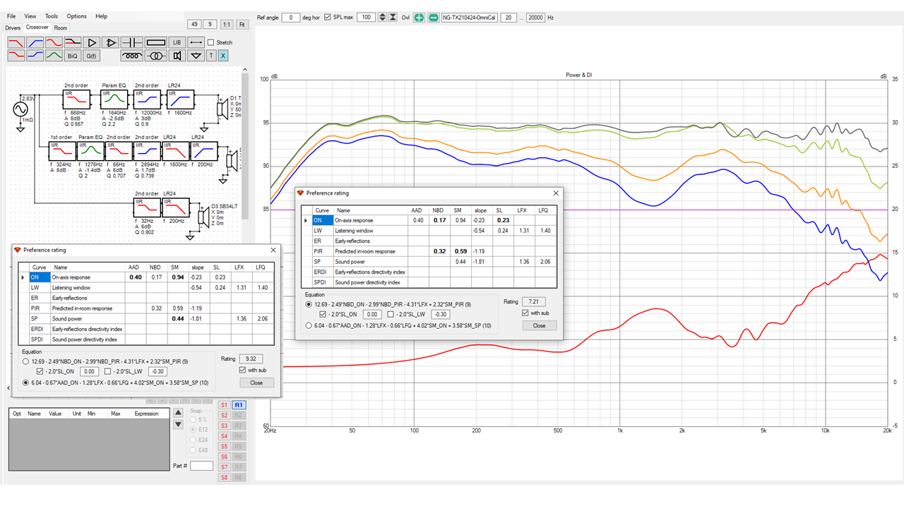

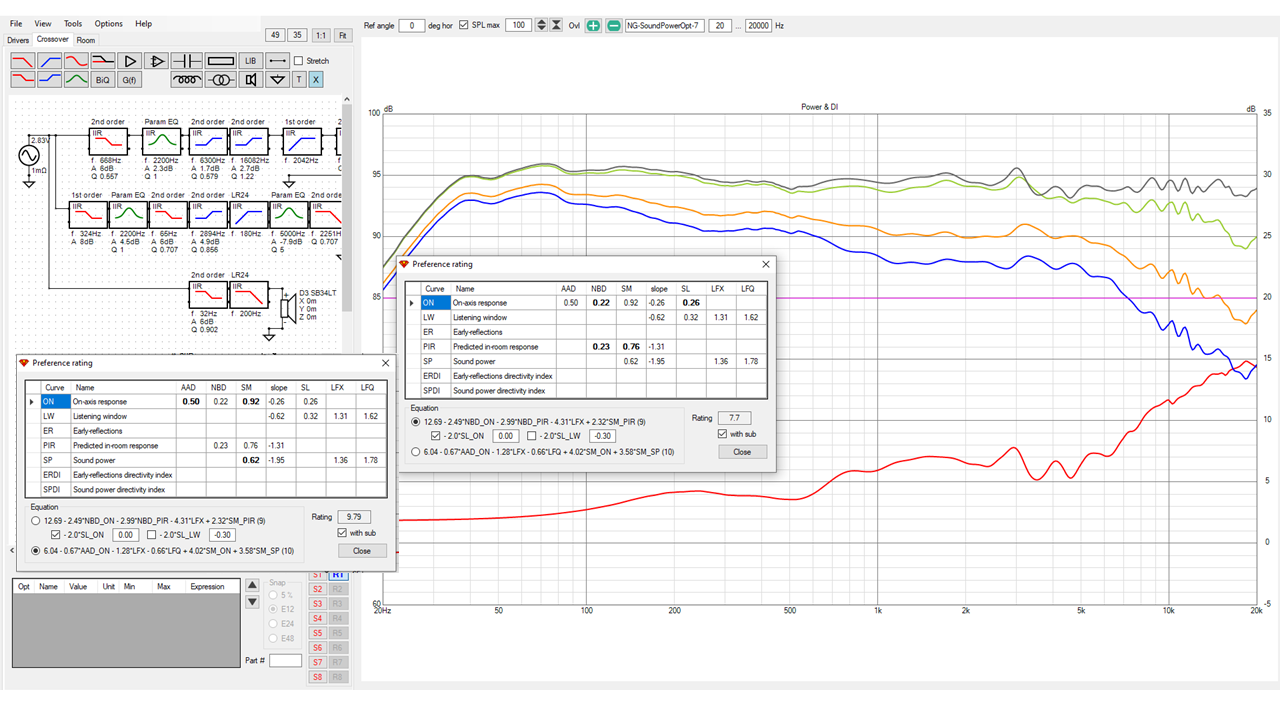

what was the VituixCad2 preference rating for the 2 crossovers?
I was enamored with the preference rating for about a month... then I got over it... When I looked at S. Olive's paper, there was a fairly low correlation between individual preference and the final score. If it were rounded to the nearest even number, it might be useful in segregating into three general categories, the bad, the acceptable, the very good. Calculating it down to a decimal place is misleading... calculating it down to 2 decimal places is silly.
I don't know which equation to select, so I am showing the score from both.

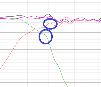

Looks like these things circled here could be combining, you could try a couple of EQ tweaks to see if you can make a worthwhile change and listen to the difference. I think it is a big enough bump in a sensitive hearing area and likely to be audible.Yes, and I am not sure of the source of that resonance. It is in the mid driver raw response but not the tweeter.
I big power response hole is not ideal but perhaps looks worse than it sounds. Trying to fix it with a non acoustic solution probably just shifts the problem instead of fixing it.Now that is very interesting indeed. I had been viewing the power response of the baseline system (post 156) as a problem to be solved, but perhaps it is not. Thanks for that information.
I would look at trying to flatten the listening window more than the power response and see what that does.

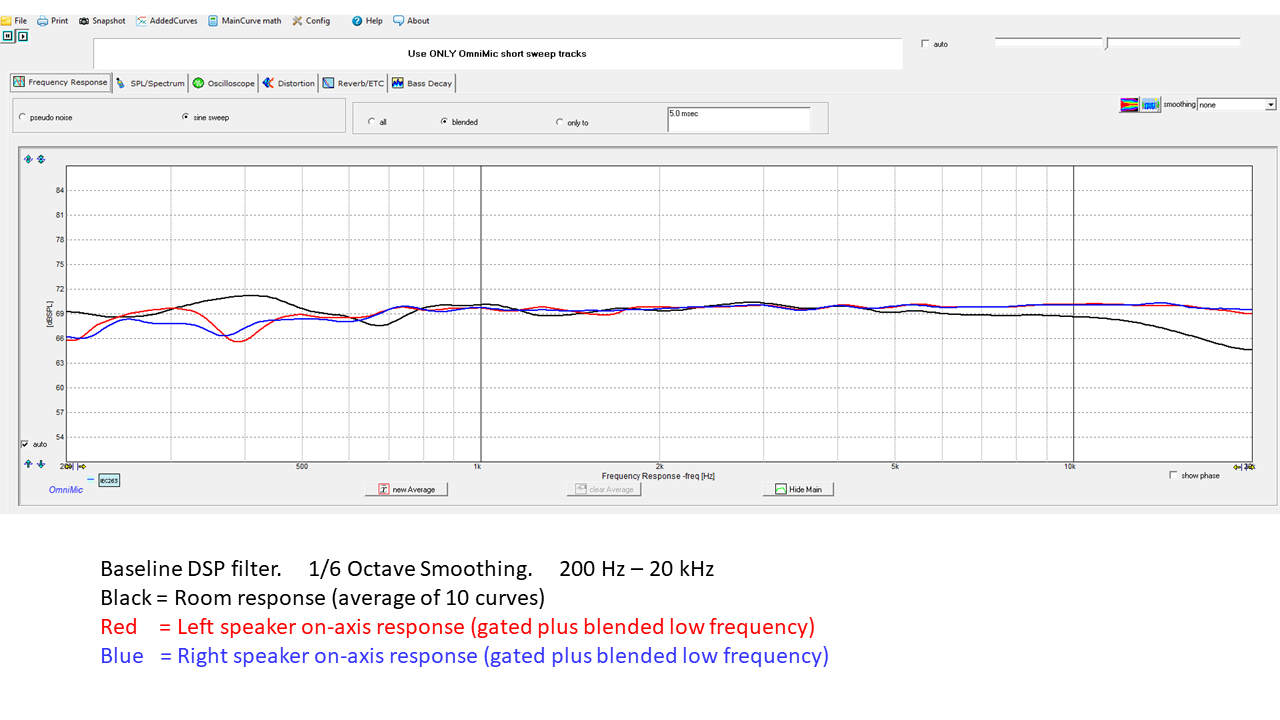

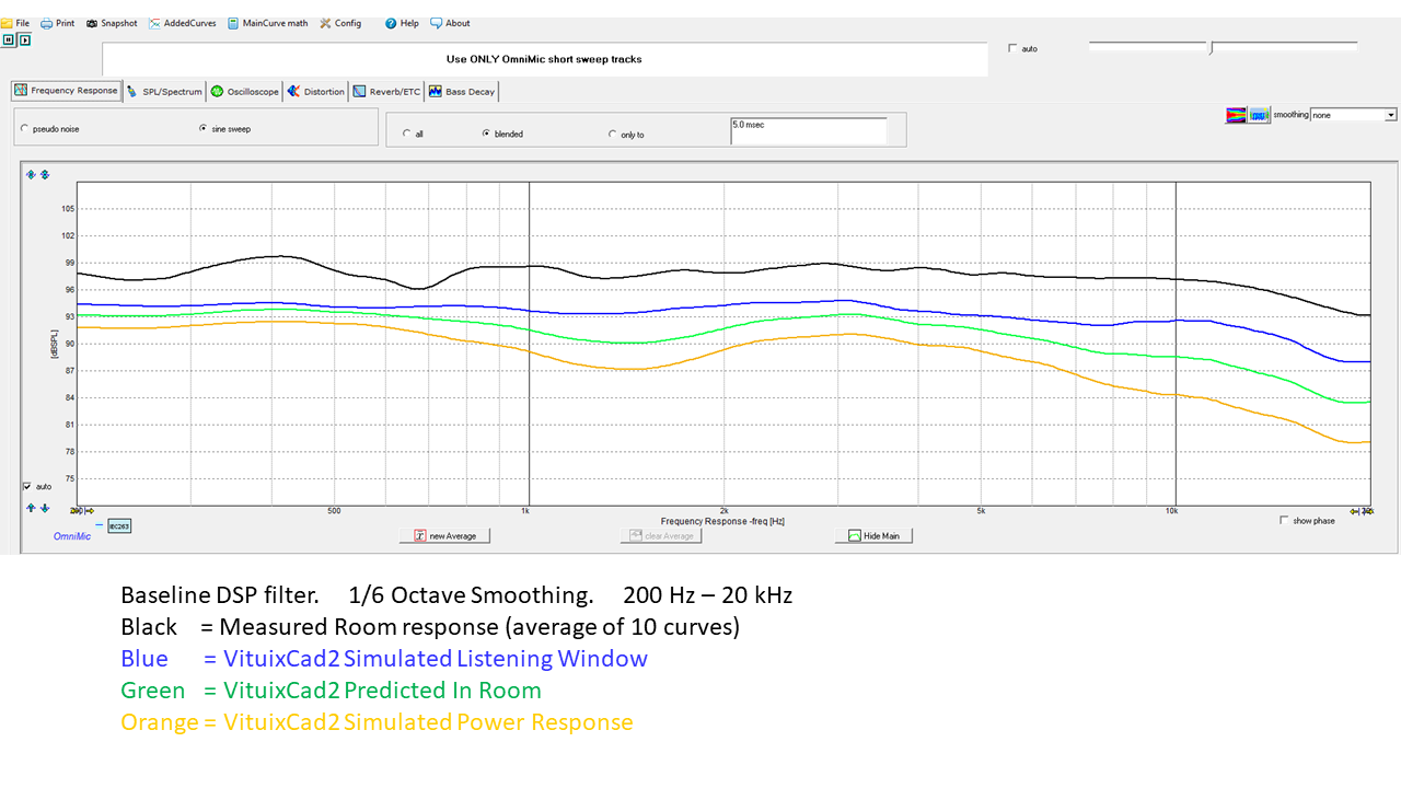

So now let’s talk about why the baseline filter and the Sound Power Optimized v7 filter sound so similar on the majority of material. Here is my theory...

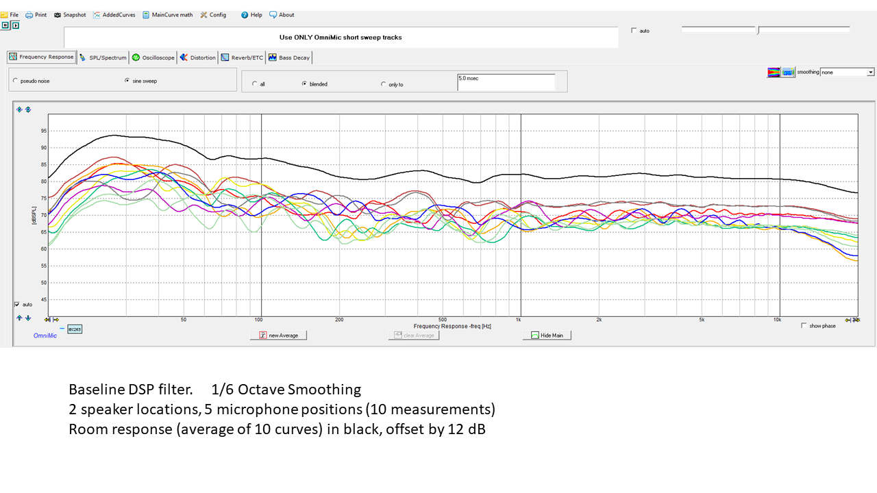

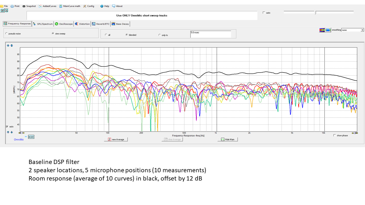

Several months ago, I made a room response curve. I used 5 different microphone positions and 2 different speaker positions for a total of 10 separate measurements. The 5 mic positions were spaced out quite a bit further laterally than the normal listening position, at different heights and distances from the speakers. When all 10 curves are averaged together, the result is smooth and even. I show this in the first graphic. The next graphic shows the same thing, but with 1/6 octave smoothing.
The third graphic shows the average room response curve compared to the measured left and right on-axis curves. I was pleased to see the close correlation between the room curve and the on-axis curves.
The fourth graphic compares the average room response curve to the VituixCad2 simulation. My measured room response curve is much closer to the simulated listening window curve than it is to the predicted in-room response or the power response. So, this is the explanation. Since both the baseline filter and the new filter have very similar on-axis responses and listening window responses, they tend to sound very similar in my unique room. Optimizing the sound power response had no effect on my listening experience because in my room, I don’t hear the sound power response.
This is not so surprising in hindsight. In his book, F. Toole discusses how the sound power response is a good indication of how a speaker will sound in an average room, but he acknowledges that every room is different, and some are quite different. Does this make sense? or am I completely dished 😱 ?
