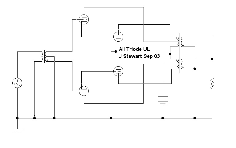

When you built a DC coupled all Triode UL, what did the bias circuitry, and other resistance values look like?
That took some pretty complex calculations, right?
Or were the output tubes RF triodes that like to run with grid current?

All Triode UL, How it works
The pdf on cct description details how I got there.
Nothing magic, it simply works.🙂

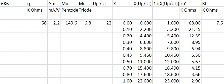

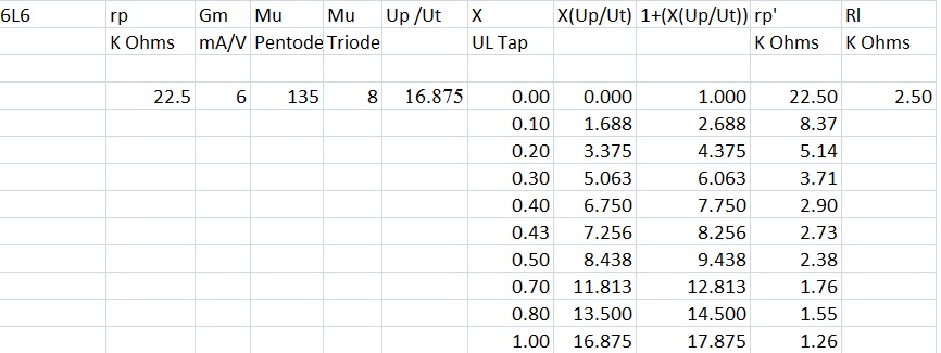

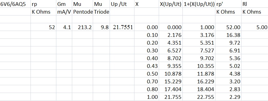

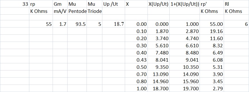

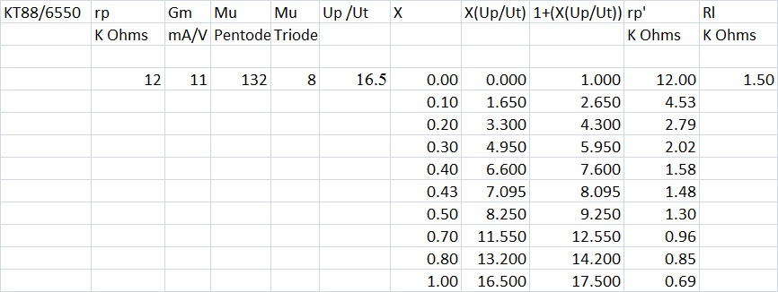

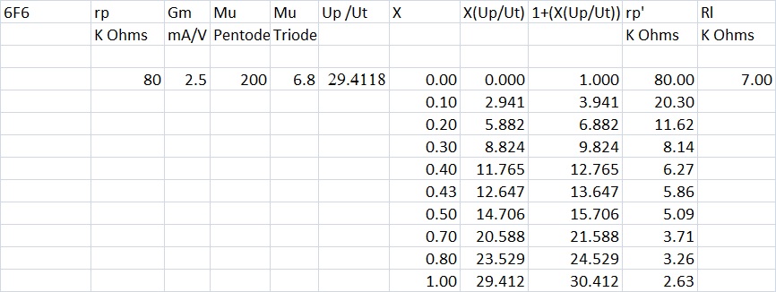

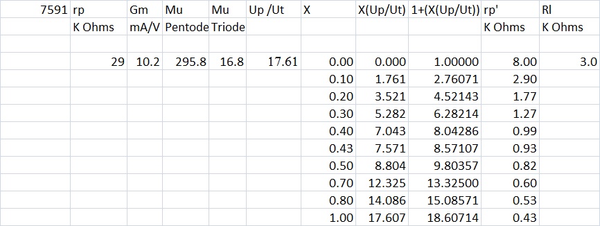

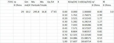

A paper by DTN Williamson & PJ Walker, 1952 on UL & cathode FB, a very good read. And some worked examples of how the degree of UL FB controls rp (plate resistance).🙂

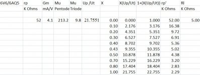

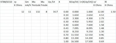

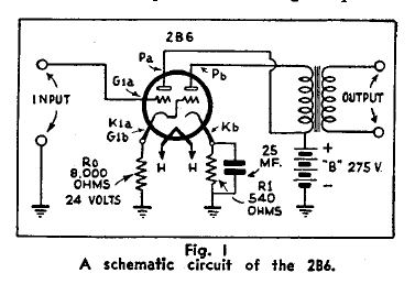

I was reading the 2B6 article. Isn't the circuit in the attached image basically a cathode follower DC-coupled to a power output triode? Or am I not understanding the AC operation of this circuit (the negative feedback)?

You are correct. Triode one is a low to medium mu triode, Triode two, the power part is a high mu triode. Many of these old tubes are easily synthesized with common tubes still on the market today at a reasonable price. The tests I did 15-20 years ago simply used paralleled sections of a 6SN7 as triode one & a 6F6 triode strapped but G1 & G2 connected together.🙂
Looking at the 2B6 yesterday, it would be somewhat of a challenge.😱

Thanks for posting that paper. Very interesting. The plots seem to be based entirely on calculations using simplified models. If there are any measurements, the authors haven't provided enough information to allow others to duplicate them. But still very useful.

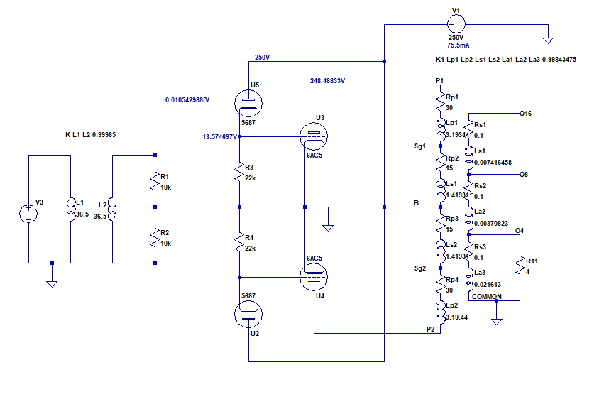

Just to see if it would work, I threw it into LTspice, using a 5687 as the cathode follower half, a 6AC5 as the output triode, and a model of a Hammond 6.6k PP OPT.
It worked!
The only problem is that it looks like it will take a lot of voltage drive to get to full power. Gain of the whole thing (5687CF - 6AC5 - OPT) to the load was well below 1. Or maybe I did something wrong.

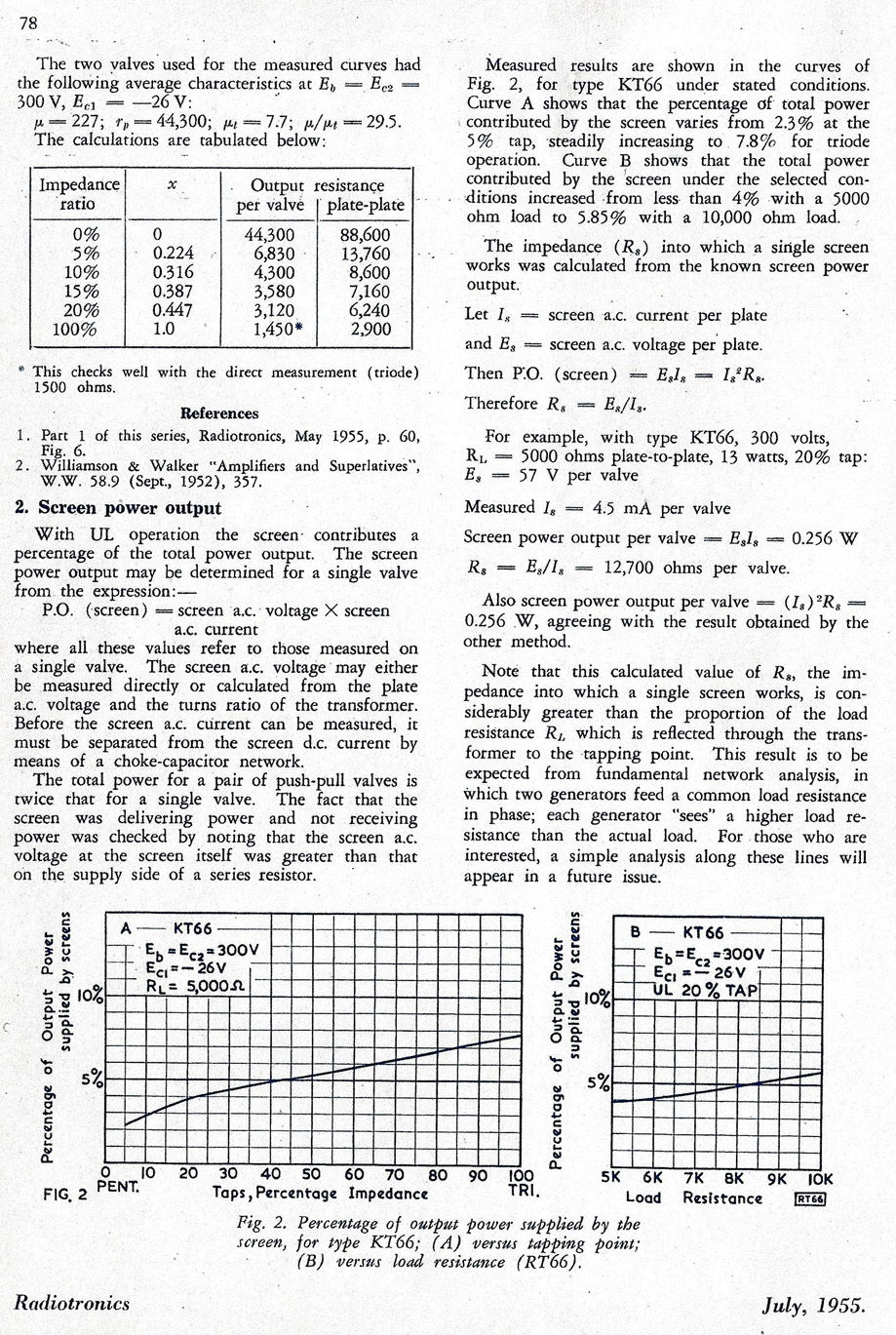

Another article by DTN Williamson, in this one he treats the contribution to the power output by the screens among other things. The rp of the tube as a voltage source drops very quickly, looks like only 10% UL drives rp down by 90%. Very effective.🙂
It worked!

jhstewart9,
Thanks for the interesting article. It made some things clearer for me.
In the article, I see 13W push pull (6.5W per tube).
0.256W per screen
0.265/6.5 = 0.04
That is 4 % "Distributed Load" power from the screen.
Of course that is for a 20% tap. Although a 40% tap would be easier for the screen current to drive, for a 40% tap versus the 20% tap, the screen voltage would have kept up better to the descending plate voltage, but that would mean there was less current from the screen to drive the 40% UL tap.
Having the author do most of the work for me, made it easy for me to
continue my original conclusion:
There is not very much power delivered to the UL tap.
And that makes me think that "distributed load" is a misleading term.
That is a little like saying that a 200 Horsepower engine delivers 4 more Horsepower when you use Synthetic Oil, instead of traditional 30 weight oil.
The real advantage of Synthetic Oil is less engine wear, not a less significant addition to horsepower.
One real advantage of using a UL tap, is that all other things being equal, it is easier on the screen, versus using the screen in Pentode/Beam Power mode.
