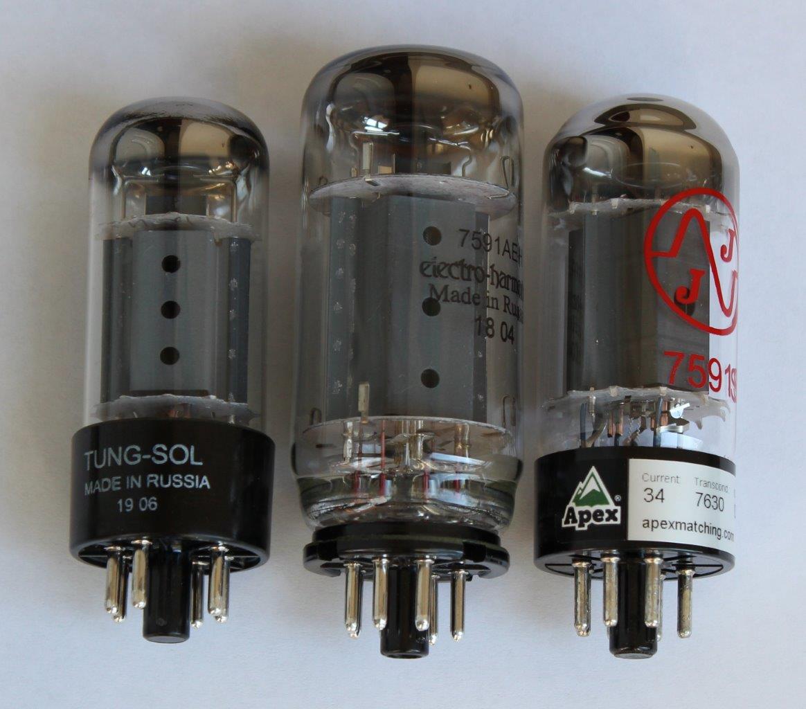

I’ve attached some more data comparing the Tung Sol Reissue 7591A and the Electroharmonix 7591A. I’ve compared the clipping characteristic for the two tubes, each driven to about 1.5% THD, and the Tung Sol Reissue clipping seems much softer to me.

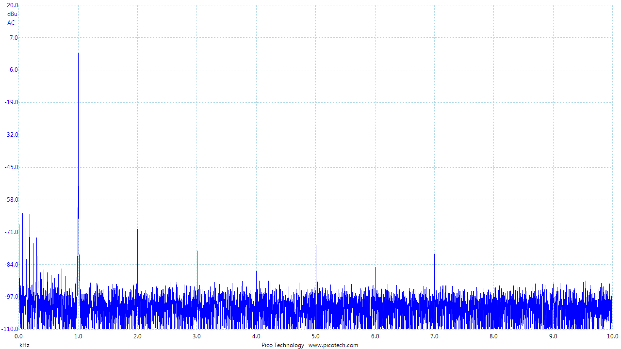

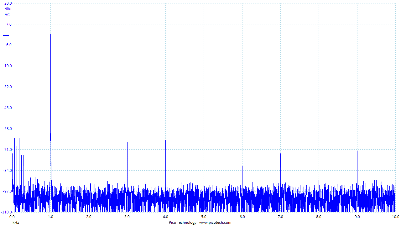

I’ve also compared the distortion spectra of the two tubes at around 12W. The Electroharmonix seems to have a higher proportion of higher-order harmonics.
So, I have mixed feelings about the Electroharmonix. It is quite ruggedly built (see the attached photo), possibly based on the Sovtek 5881. But the Tung Sol Reissue sounds better to me, as I've listened to it over the last few weeks. The EH might be a good choice for a guitar amp.

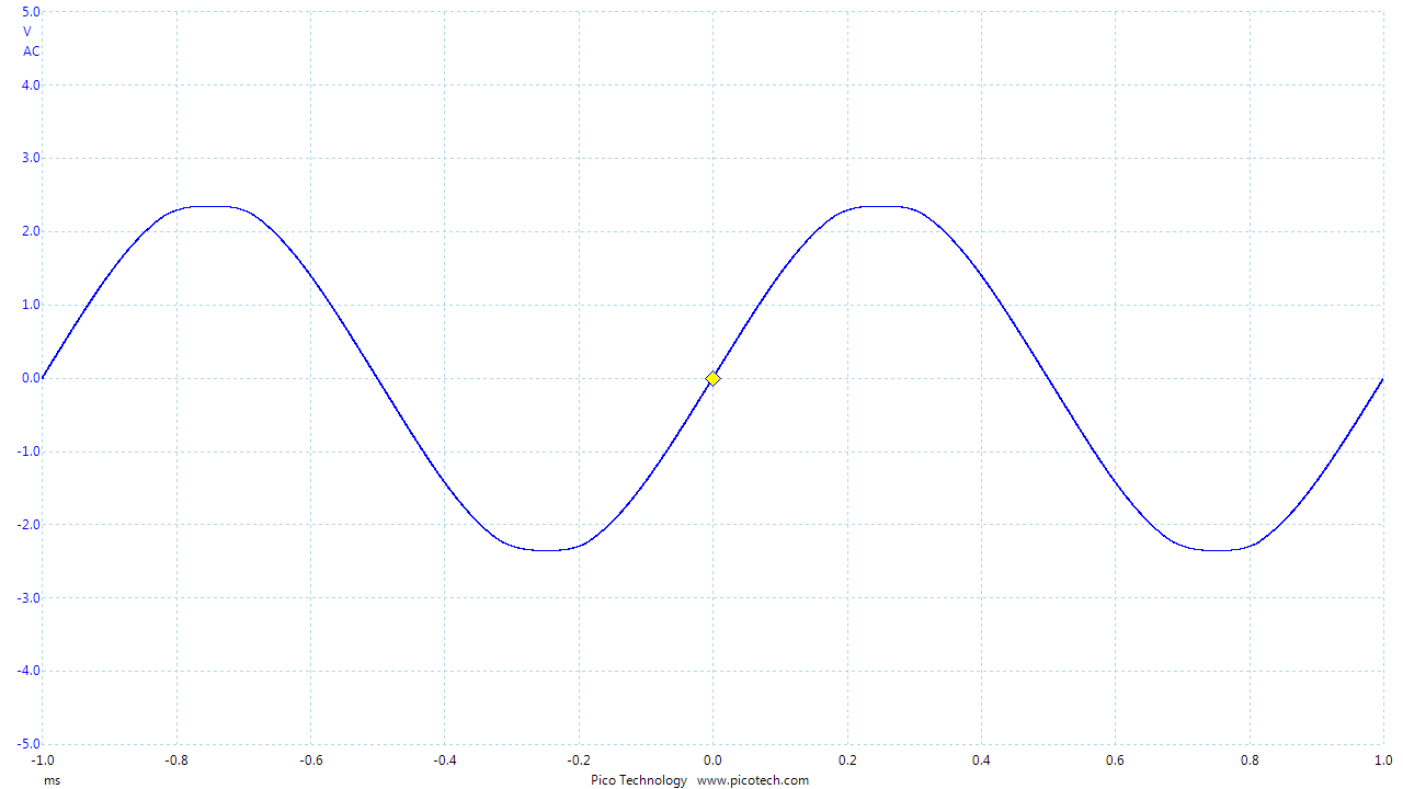

Think you are shewing in the same post some scope shots with clipping. The frequency domain traces don't agree. Also see your PS hum on the freq results.

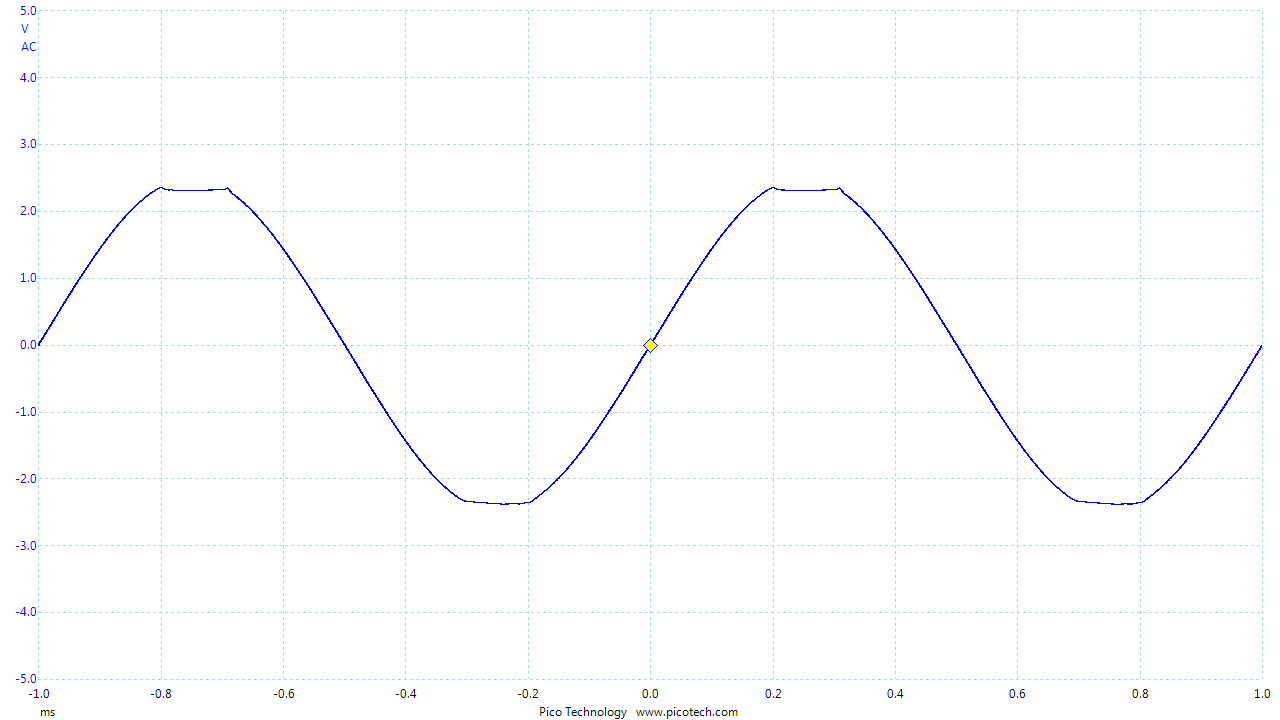

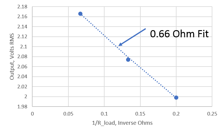

The data were taken with a PicoScope 4262. A very useful instrument, I agree; it does the work of several conventional instruments at a lower cost.
The clipping characteristics in my post #21 were taken at 1-1.5% THD, roughly 37-38W output into 5 ohms. The distortion spectra were taken at 12-13W, as I mentioned. The purpose of those was just to illustrate the differences I observed between the Tung Sol Reissue 7591A and Electroharmonix 7591A. The big difference surprised me, since they are both made by New Sensor.
The local feedback resistors R42-R43 are not used. Early on, I experimented with adding 3.8dB of NFB by making them 220k ohms, but that did not improve performance - in fact, it made it worse. So they are now omitted.
I was wondering if anyone would ask about NFB....... The measurements were made with about 17dB of NFB, from the output back to the cathode of the input stage. In pentode mode, that equates to R60 of 2.2k ohms to the 8 ohm transformer tap, and C20 of 1500pF. I didn't measure damping factor, but it's on my to-do list......... I did verify stability with up to 1uF of shunt capacitance on the output, but I'm still working on the frequency compensation. I won't really finalize the circuit for a few weeks yet.

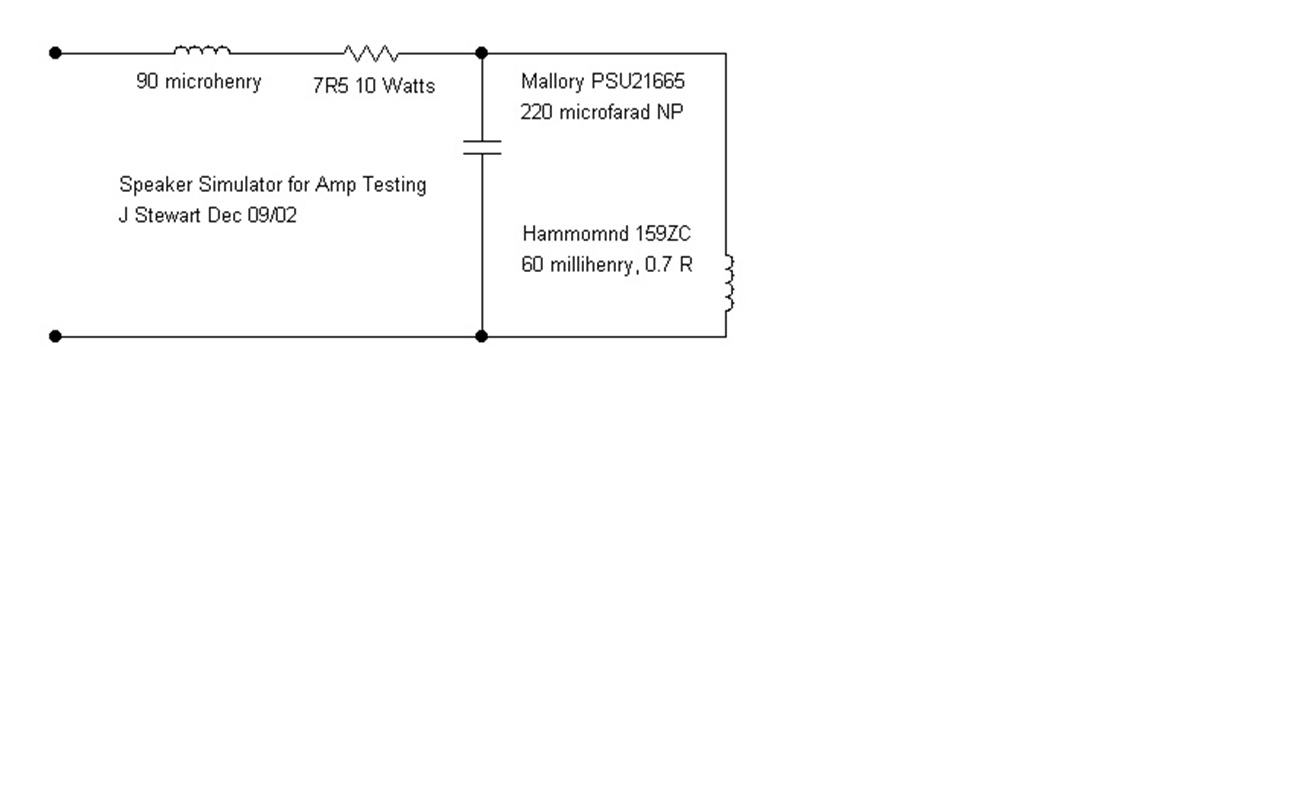

That loudspeaker model has been circulating for a while. Got my copy from the English magazine Electronics World, it was a very popular publication.
My version is a little simpler but does very well with common parts.
Not much new under the sun..........or audio!!🙂
A description emailed to cover a query in an article I authored in AudioXpress Magazine-
This is what I hook up to the amp output terminals when I want to simulate a speaker.
It has a nice peak at about 45 Hz, similar to a speaker resonance in it's box. If you need to simulate a reflex enclosure you will need another LC circuit. Other resonant frequencies can be set by changing the Hammond choke or it's resonating non-polarized (NP) capacitor.
The rise of impedance caused by the 90 microhenry choke starts at about 4KHz & is well up at 10 KHz similar to a real speaker.

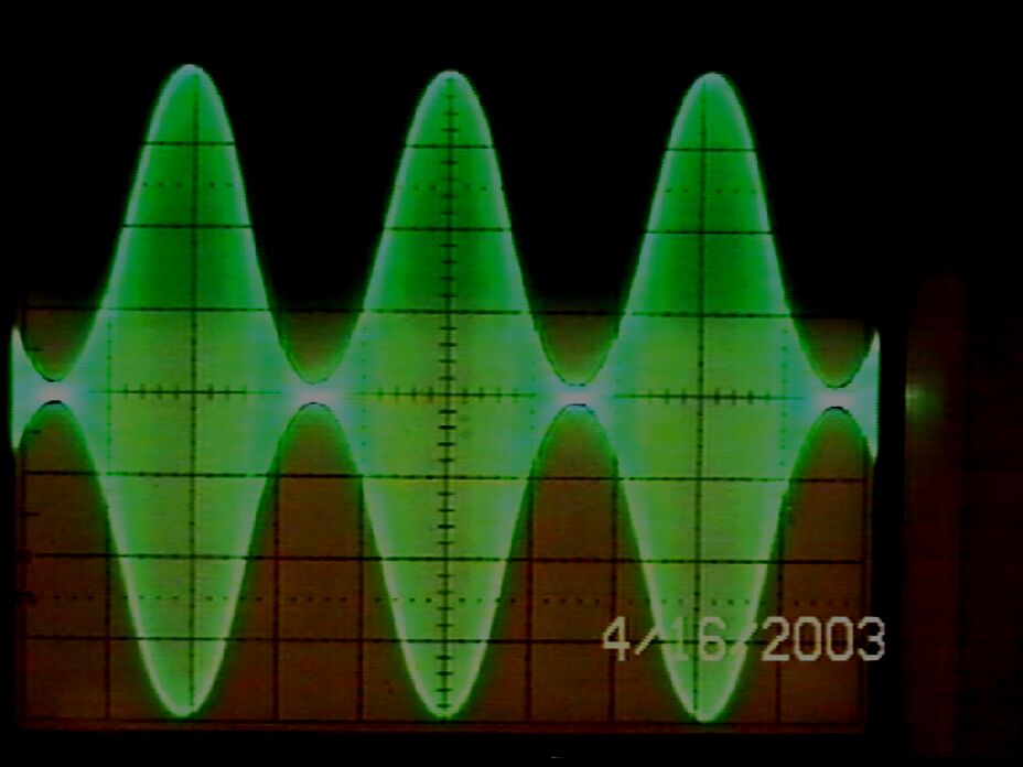

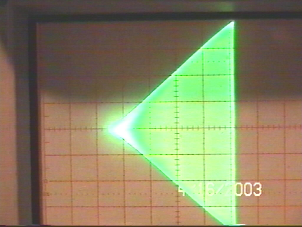

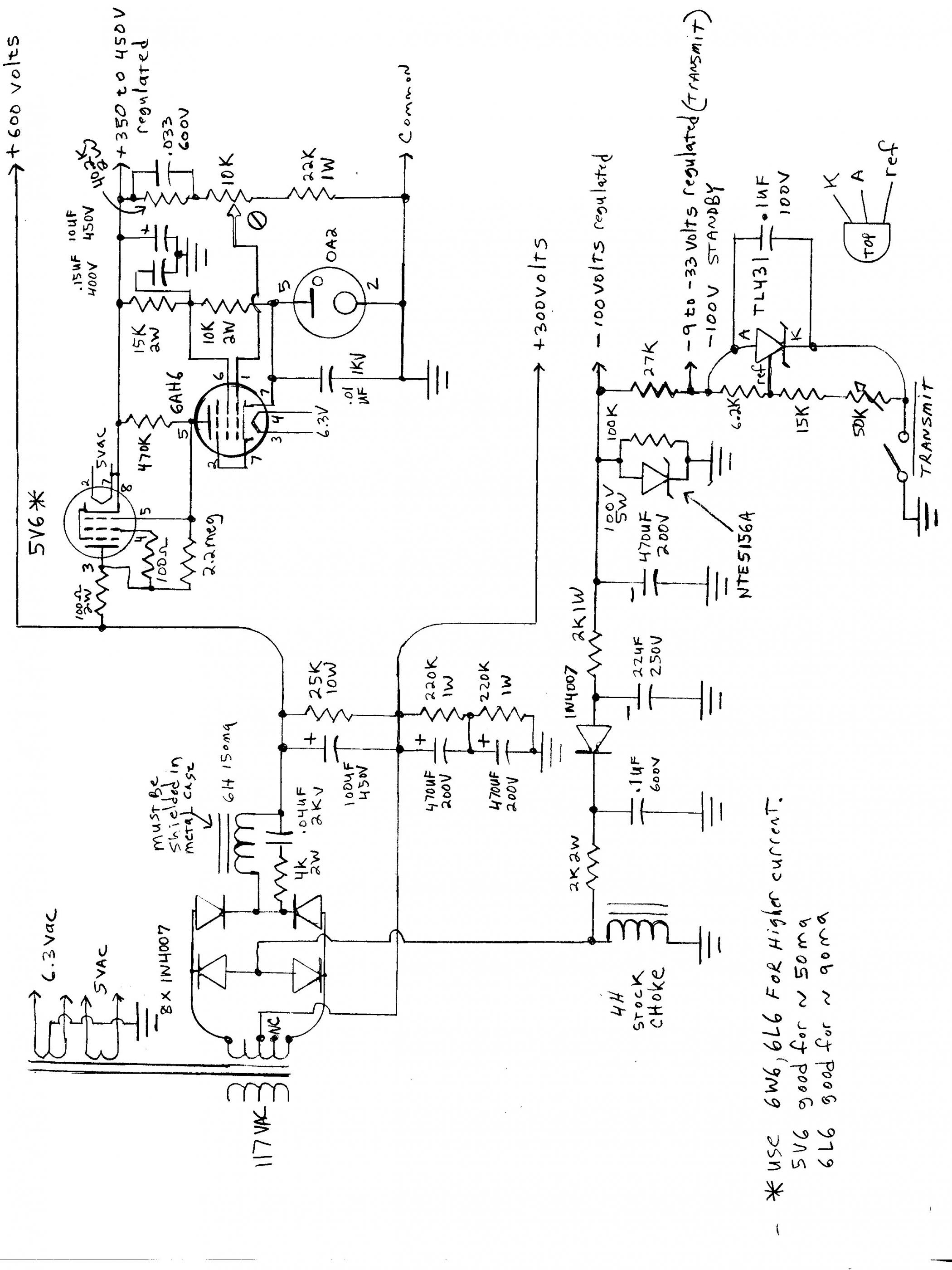

My application is as an RF Linear amplifier. The 7591A spec's say a plate to grid 1 capacitance of 0.25 pf , whereas the 6L6 variants are 1pf or more. A lower Gp capacitance, and dual G2 terminal at the base make the 7591A an attractive RF tube. A B+ voltage of 600v has not shown to be a problem. I have gotten as much as 80w PEP from a pair.
I attach scope waveforms, including the 100% AM modulated envelope pattern, and the trapezoid pattern. The diagonal sides of the Trap are straight lines indicating excellent linearity. This is for original 1960's tubes. The EH when used shows the curvature of an 'S' pattern.

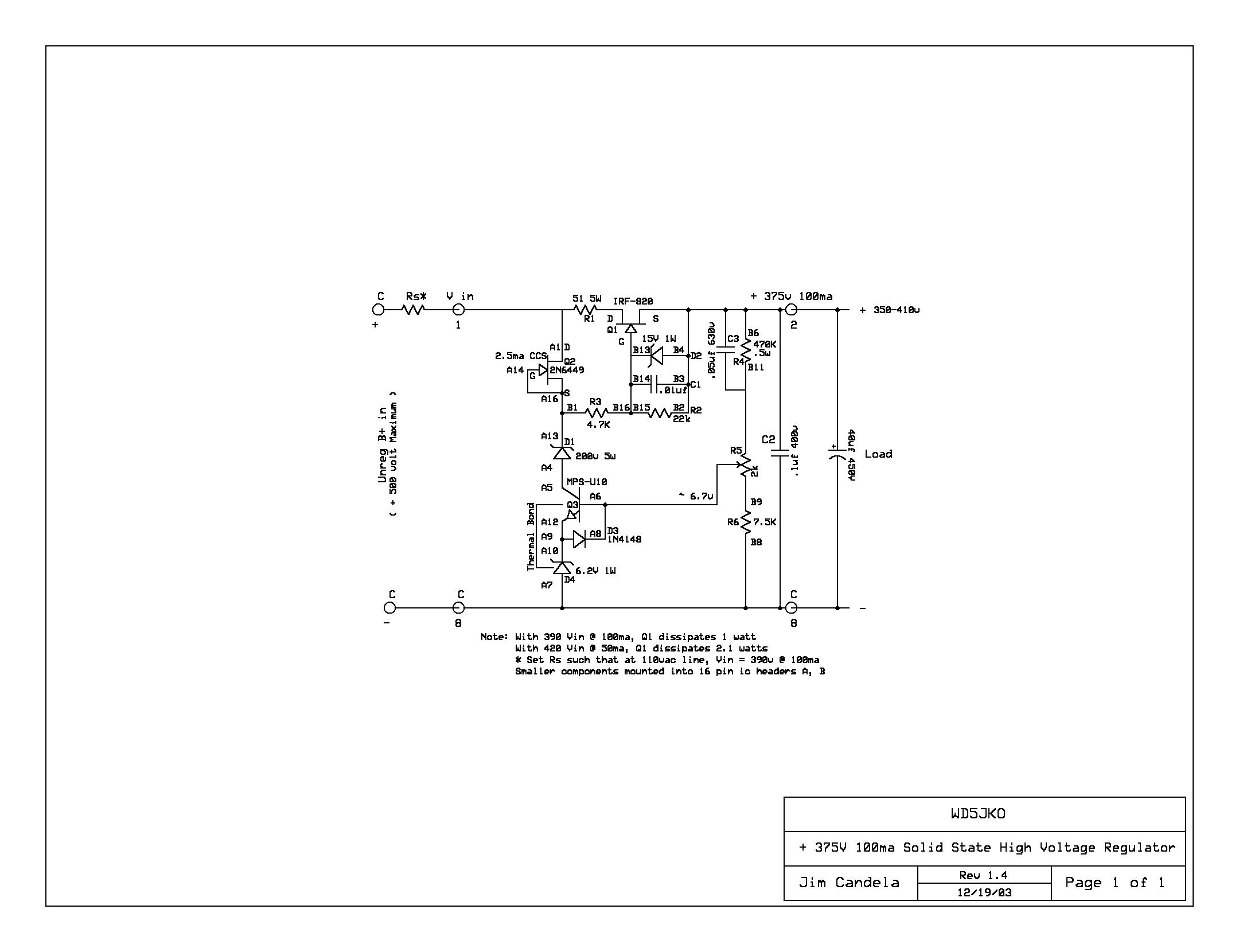

I attach two power supply schematics. The one with Tubes is used in the RF application, and the solid state FET regulator is used in a Sherwood S8000 where the output tubes are 7868's. The 7868/7591/6GM5 are the same tube with differing base type. In my schematic, over the years I put in a 6W6 instead of a 5V6, and a 6CB6 instead of a 6AH6. In the case of the 6AH6, I ended up with a dead short heater to cathode. Later finding that the 6AH6 spec's for V h-k are not well specified, and best not to use this tube for my application. A 6CB6 seemed to be better suited.
One comment about the loop compensation on the regulators is that the loop response time will have an effect on the audio, most notably on the bass frequencies. Too much compensation can lead to a boomy bass response, not enough compensation, the bass gets diminished.

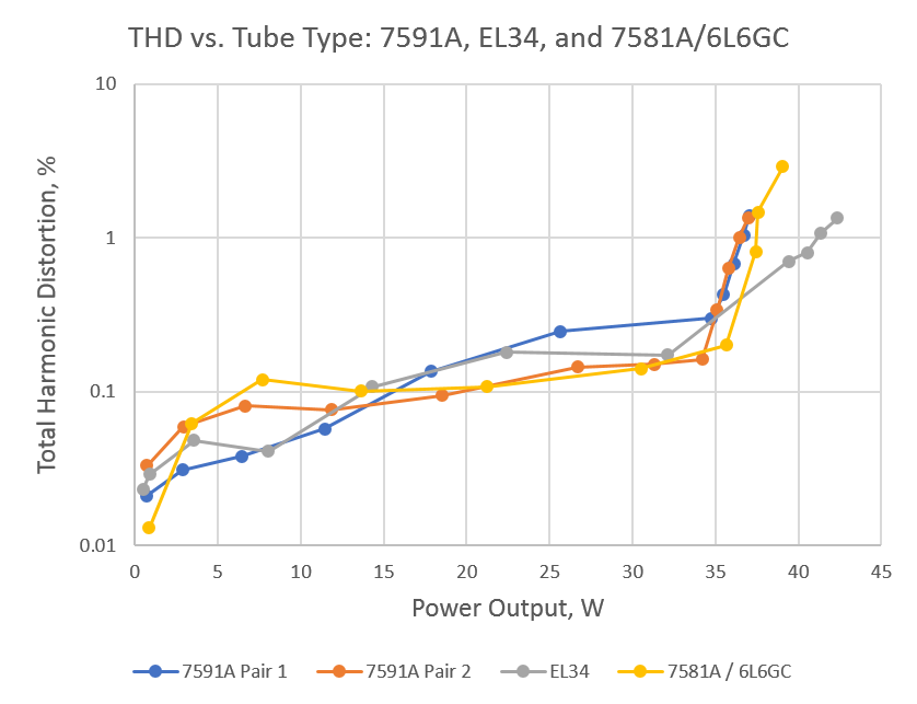

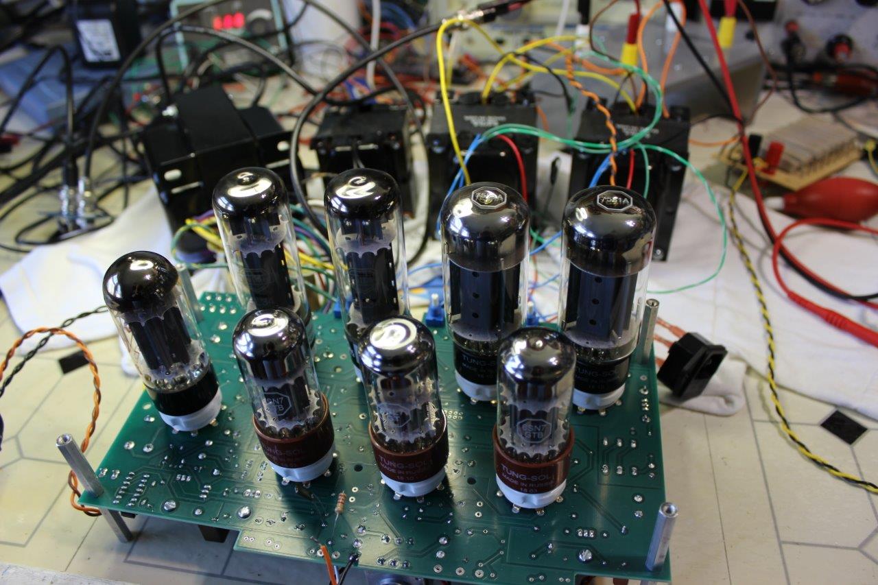

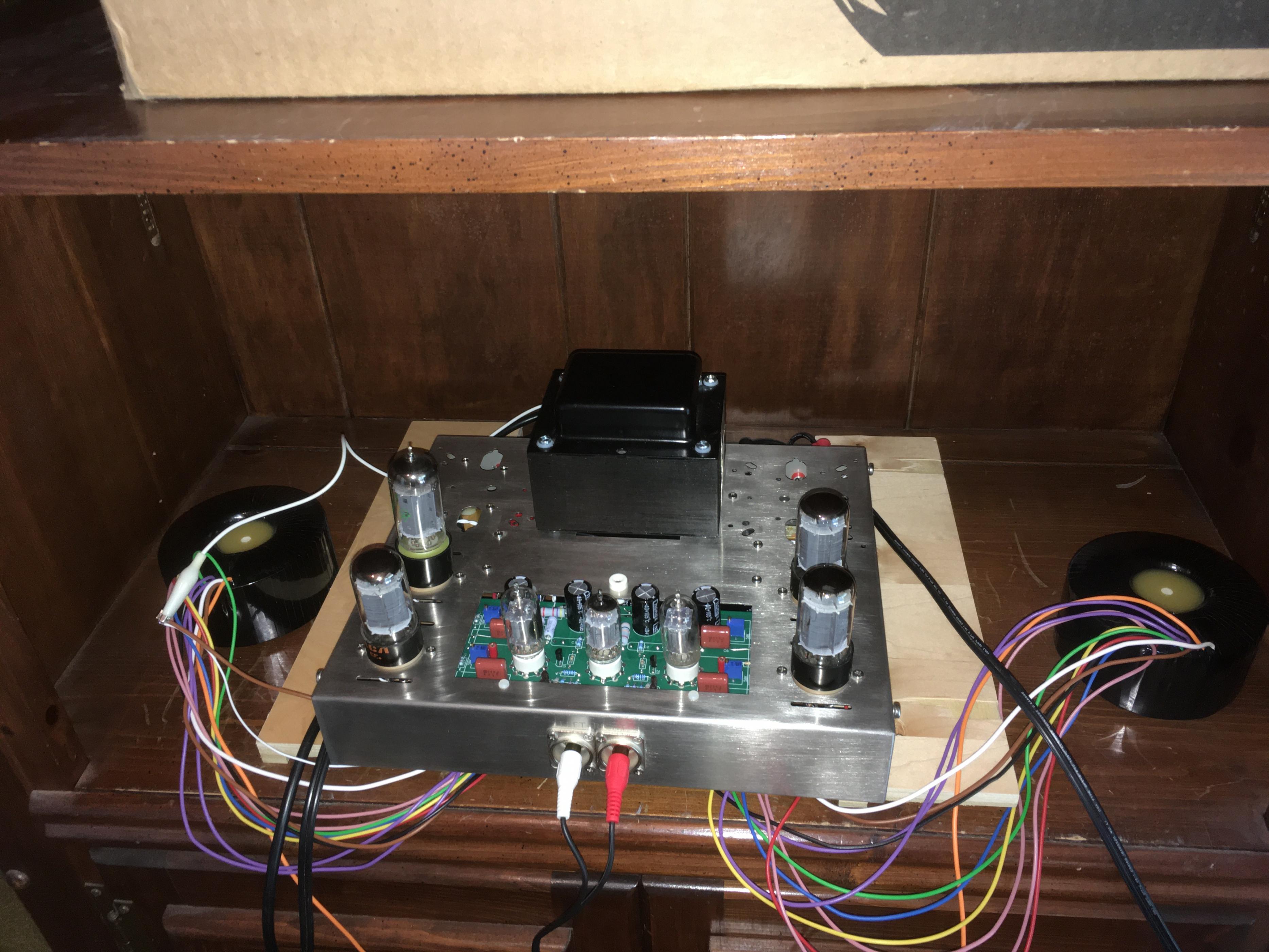

I finally began measurements on my second prototype, which was designed to accept EL34 or 6L6GC instead of 7591A. I had the idea that the 7591A were more linear than other common power tubes, but as it turns out, the three tube types I compared were remarkably similar in terms of distortion.
I’ve attached a photo of my prototype, with Mullard Reissue EL34 installed in one channel and Tung Sol Reissue 7581A / 6L6GC installed in the other. And the plot compares the THD vs. Power Output for two different pairs of Tung Sol Reissue 7591A, the Mullard Reissue EL34, and the Tung Sol Reissue 7581A / 6L6GC. The power supply, driver circuit, and output transformers were the same. All tubes were operated as pentodes with a 390v regulated screen supply, and with 17dB of NFB taken from the 8-ohm output tap. The plate supply is 440-450V at no signal, dropping to 400-405V at full output.
The EL34 has the highest plate efficiency and delivers the most power (41W). But the 7591A and 7581A were not far behind at 37W and 37.5W, respectively. And most importantly, the THD of the three types is almost the same. The tube configuration (pentode vs. UL vs. triode) matters much more than tube type. The 6L6GC does not have the reputation of being a very linear tube, but it actually had the lowest distortion at 1W (0.013%) and less than 0.2% THD at 35W.
So, in the end, I’m not sure which I like best. In listening, I think I prefer the 7591A, followed by the 7581A/6L6GC. But I doubt I could tell the difference in a rigorous double-blind test. A sensible person would have just built the amp and been satisfied with it, I suppose.
I started this thread with the observation that the 7591A produced much lower distortion as a pentode than in ultralinear mode, or as a triode, and that’s also true with the EL34! I plan to start a new thread to post those results, since they have nothing to do with the 7591A.

WB8PEP,
Thanks for the great scope shots.
You reminded me of some HF linear amplifiers I worked with from Gates (1KW), and Collins (3, 10, and 45KW PEP).
The exciters could do SSB, and AM equivalent (Carrier and one sideband).
Scope measurements taken from RF sample ports were very handy.

What is the damping factor with 17dB of negative feedback?

Damping factor is still on my to-do list. With the NFB, I'm guessing the output impedance will be a few tenths of an ohm.

I measured the output impedance at the 8-ohm tap, with the EL34 output tubes in pentode mode and 17dB NFB. I used a 1kHz output signal around 2V RMS and varying load impedances of 15, 7.5, and 5 ohms. Then I fitted a curve to the data - best fit was 0.66 ohms. The same measurement on the 4-ohm tap gave 0.45 ohms. So damping factor for an 8-ohm speaker is about 12, and 8.9 for a 4-ohm speaker. Not great, but adequate, and many commercial tube amps are much worse. Damping in UL or triode mode would be improved, but at the cost of higher distortion. I guess I'm willing to accept slightly poorer damping factor in return for lower distortion.
