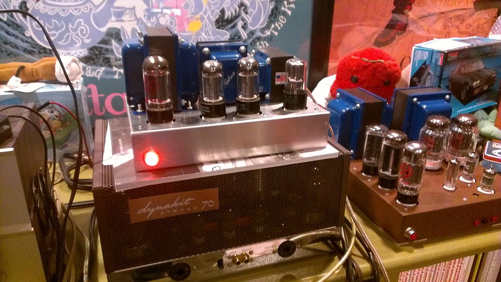

A shot of the EZ10 testing. With only one amp hard to give it a thorough testing, but I swapped out one of the EZ260 Grommes amps with the 10watt version and it sounds very clean and quiet. Less punch, but that's to be expected.
I have since taken it to my office and where I have one of those Chinese SET KT88 headphone amps (Noisy, hummy, cheep) and swapped out one channel and it sound very good, possibly a bit more punch. This is running a smaller speaker (polk audio) and smaller room where I intend to use it so just need to get the second set of transformers from EDCOR and build the second channel.
I also swapped out the GZ34 with a 5U4GB to see if I could hear anything but seemed similar, but hard to tell with only one channel. Will be trying this test again just to see if I can hear a difference.
I think the mini-monoblocks will work out nice for my computer audio system.
One thing to note is the gain is bit lower then the other amps I have, but doesn't seem to be a problem with what I'm driving it with. Some of the changes in the design may also have reduced gain a bit, but really don't think it makes a huge difference when all said and done.
Again want to thank everyone that chimed in with suggestions and help!!!!
Will post the completed amps once I get the transformers and chassis painted all up.
Sandy

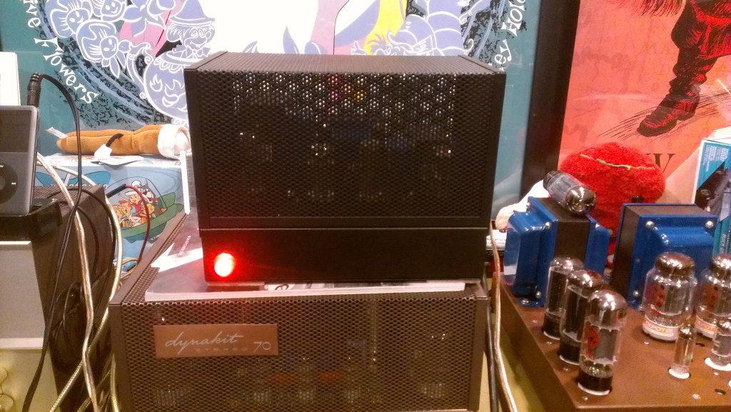

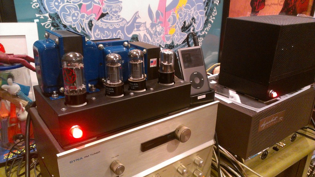

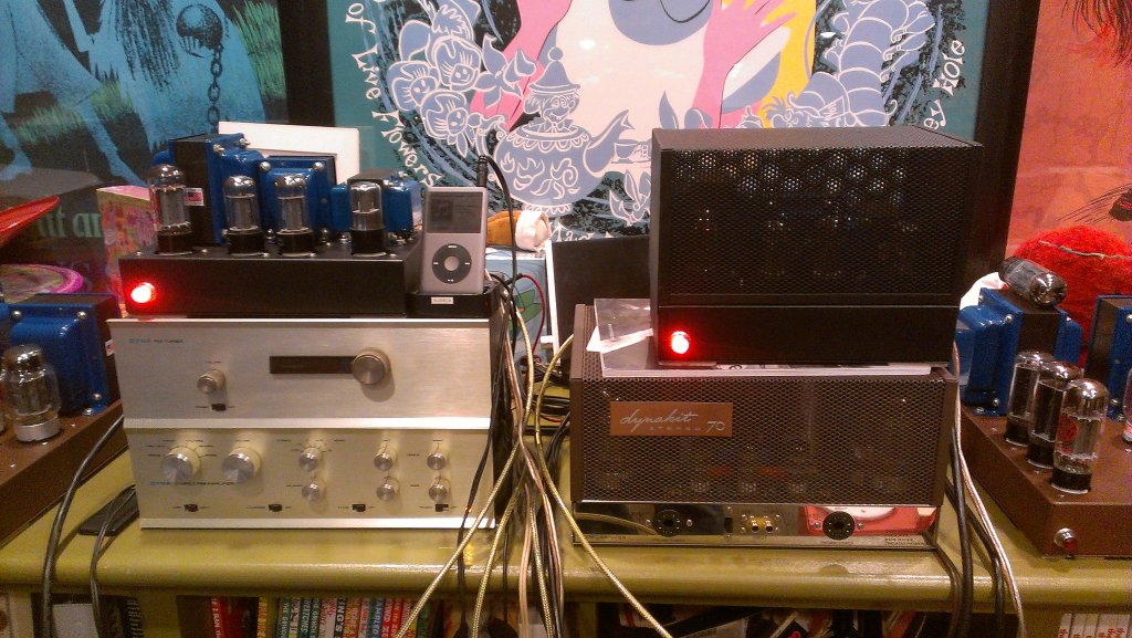

Finally finished the paint on the chassis and covers. They are painted Textured black very similar to the old Dynaco brown texture on the ST70 and MKIII's.
Paint was off the shelf etching primer with a first coat of satin black, then the texture coat (I forget the exact name on the can). The finish is very nice, better then I had hoped for.
Tubes are Sylvania JAN6SL7GT's Tungsol 6v6's (reissue) and JJ GZ34
One last change to the parts was done as I found the initial BIAS for the 6V6's were just too high. They were showing 34ma at about 350v at the each tube with the 270 ohm bias resistor (Tested with a bias tap), I changed it to a 400ohm (2x200 5 watt in series). It came down to about 28/29ma which is still a bit high but hopefully more in range. I don't like cathode bias resistor set up, seems a problem chasing the settings and I'll likely use a regular negative supply, but sounds good and was a simpler circuit.
I swapped speaker leads and played them into my Polk Audio SRS speakers and was blown away how solid these little amps sound. They lack the punch that their bigger brothers have which is to be expected. Very clear top end and solid bottom end.
