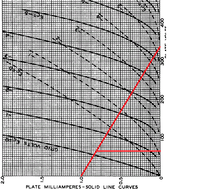

@SandyG
Plate voltage is measured right on the plates of the tubes, no resistors or anything else in the way. So on the 6SL7, the plates are pins 2 and 5, the cathodes are pins 3 and 6. The B+ is the voltage feeding the stage, so "above" the plate resistor. The voltage dropped across the tube's plate resistor will tell you the current being drawn through the tube.
So for instance, if the B+ is 325V, and you have a 150k plate resistor, and the plate voltage is 175V, that means 150V is being dropped across the 150k plate resistor. Now we can use Ohm's Law to figure out what current is going through the plate resistor (which will be the same as the current going through the tube). So...
150V divided by 150,000 ohms is
150/150,000 = .001 amperes, or 1mA
That would be a pretty decent operating point for a 6SL7, with plate volts (Vp) = 175V, grid volts (Vg) = -1.8V, and plate current (Ip) = 1mA
I'm not so much worried about the voltage amplifier (first stage). That's the simplest part. The part that would crunch driving the output tubes would be the cathodyne phase splitter. In push-pull amps, it's the phase splitter that is usually the weakest link. So I'm really interested in what the B+, Vp and Vk (cathode voltage) are.
When you draw the loadline, you take the B+ (voltage "above" the plate resistor) and divide that by the plate resistor value. So if you have a 325V B+, and a 150k plate resistor:
325/150,000 = .00217 A, or 21.7mA
On the 6SL7 curves, draw a line from 21.7mA on the left side (y axis), to 325V on the bottom (x axis).
The ideal loadline would be completely horizontal. The worst possible loadline would be vertical. In essence, the flatter the loadline, the lower the distortion.

I drew the loadline for B+ = +325V, plate load resistor (Rp) = 150k ohms.
Notice that I labeled the plate voltage as Vp-k. That's voltage from plate to cathode. That will become important when you draw a loadline for the cathodyne, as the cathode will be somewhere around 100V above ground.

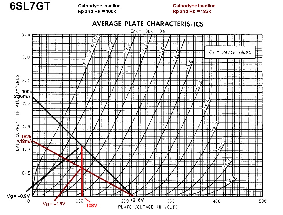

OK, let's say we have that same +325V B+ available for the 6SL7 cathodyne. We'll now want to draw a loadline for that, Let's say we have a plate load resistor (Rp) of 100k, and a cathode load resistor of 100k (Rk).
Since the current will be the same at all points in the circuit (Kirchoff's Law), then we can divide the B+ by 3, so 325/3 = 108 (approx, close enough)
100,000 x .00108 = 108V dropped across each 100k ohm resistor. (Wasn't that convenient?)
The voltage at the 6SL7 cathode will be +108V.
The voltage at the 6SL7 plate will be +216V.
The B+ will be +324V (close enough to 325 for our purposes).
As you can see, the voltage from the 6SL7 plate to cathode will be only 108V. The "B+" the 6SL7 will "see" will be from the cathode to the B+, which is 216V.
So, to draw the loadline, we use values of 216V and 100k ohms.
216V divided by 100,000 = 2.16mA ( NOT 21.6!!! 😱 )
I added (in brown) loadline for 182k ohms for plate and cathode load resistors.
These loadlines are attached.
Did I do that right??

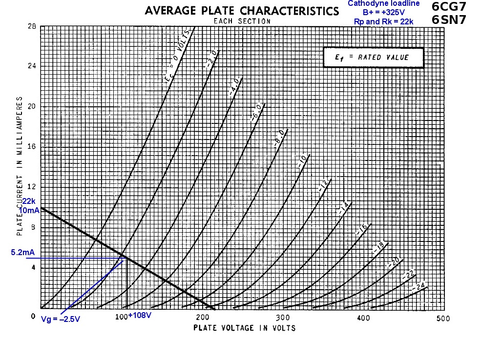

Well, I tried 15k for the plate and cathode load R's, but I came up with very little swing available. Maybe enough to drive 6V6's, though. With 15k load resistors, the 6SN7 operating current winds up at 7.2mA, which isn't bad. The only thing is I again worry about the tube needing to swing to near zero volts at its input, causing grid current, causing the input tube to go *crunch*.
With 22k (shown), the 6SN7 internal current is about 5mA (probably will be more like 4.9mA), which isn't as good, but isn't horrible. It swings more volts this way.
Swapping in a 6SN7 instead of the 6SL7 opens a new can of worms. The problem is that the gain of a 6SN7 common cathode stage with resistor plate load will be about 15x. So, with only +325V B+, the grid bias on that first stage 6SN7 is bound to be kind of low. So let's say it's -2V and the highest peak input (AC signal) voltage will be 1.7V. 1.7 x 15 = 25.5 volts out, but the cathodyne has actually less than 1x gain. Let's say 0.9. So, 25.5 x 0.9 = 22.95 volts out to drive the 6V6's. That's just barely enough, no headroom to speak of. That's the problem with swapping in the 6SN7 in place of the 6SL7.
In the end, I think Bigun's suggestion of a 6SL7 for the input voltage amplifier stage and 6SN7 for the cathodyne is the better way to go. The trick is to get the grid bias of the 6SL7 to about –1.5V, both so that you can give it enough input signal and so that it doesn't draw too much grid current (if too close to zero bias).
