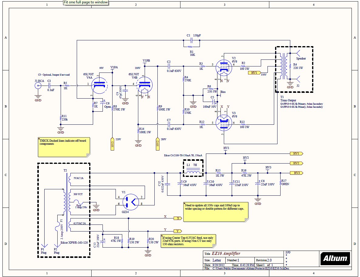

Ok, made it back for a bit of testing with some interesting results.
Current values for R8 is 150K as changed in a prior test. R7, R8, R9 and R14 are the measured drop across the resistor. Amp was tested with no signal on input and 8 ohm load on at all times.
Test 1 was the baseline that was pretty much as built except for the change of R8 from 270k to150K. This configuration was also tested with a different brand of 6SL7, results were just about the same. Just to make sure no tube issues. Original tube replaced for all test. Output into 8ohms was about 8.5VRMS before clipping
Test 2 was to just replace the 5U4 with a GZ34. Output into 8ohms was about 9.0VRMS before clipping.
Test 3 was with the GZ34 and R16's value dropped from 47K to 4.7K. Clipping before output dropped to 8.75VRMS a drop in output.
Test 4 was back with the 5U4 and R16 at 4.7K Just to see what would happen,
Clipping before output dropped to 8.0VRMS a drop in output
It seems that raising the plate voltage on the input stage causes it to clip earlier.

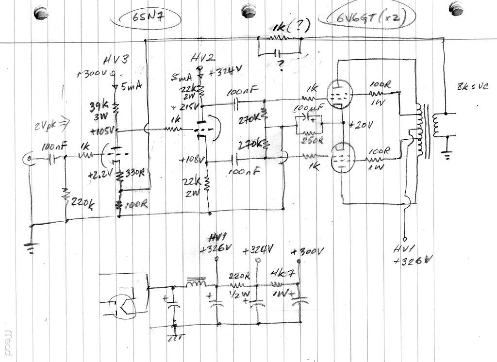

I think your results reinforce the opinions that the problem is insufficient grid bias on the cathodyne phase splitter. Raising the B+ on the first stage (changing R16 from 47k to 4k7) would increase gain from the first stage 6SL7, making it easier to overload the second stage 6SL7 (cathodyne).
Remember that less than -1V grid bias on a 6SL7 will often cause grid current to flow. I don't know what the effect of grid current would be on the cathodyne stage. I suspect it is not a desirable feature. I'd try to get the grid bias on that cathodyne up to -1.3V.
Just out of curiosity, what is the voltage at pin 8 of the 6V6's?
Part of the problem is that 6SL7, like most high mu tubes, has a high plate resistance, so really wants to work with a high plate voltage. A B+ of only +285 to the first stage is pretty low. More serious (IMO) is that there's only +325 available for the second (cathodyne) stage. You typically want the load resistors to drop a third of the B+, and the tube will drop the last third. In that case, it would be 108V across the tube. A 6SL7 just won't swing many volts with a plate voltage of only 108V.
You could try 6SN7 instead. With an input RMS signal of 1.5V, and the usual gain of about 14 for a 6SN7 common cathode stage, 1.5*14 = 21Vrms. Subtract the slight gain loss through the cathodyne, so 21*0.95 = 19.95. 20 is close enough. To convert back to peak volts, 20*1.414 = 28.2.
So you have 28Vpeak to the 6V6 grids. That will work. It's slow right now, so I think I'm going to scribble some lines on paper and see if I can come up with a 6SN7 based version of this circuit. Should be fun...
WAIT... There won't be a lot of gain for negative feedback if you use a 6SN7. 2Vpeak output from your sources might be required. This would be OK if you have a preamp with gain, but not if you have no gain stage before the power amp.
Quick 'n dirty...
OK, here's a quick and dirty sketch of the circuit using a 6SN7 instead of a 6SL7. Please forgive any mistakes, I did this in a hurry. The idea was to see if a 6SN7 would even work. I think it will, but not optimally. 6SN7 gets really linear with plate current of 8mA or higher. I couldn't pull more than 5mA per triode with this low a B+, so 5mA it is. Maybe someone else can figure a better way. I hope this is a decent start...
My apologies for the sloppy drawing.
I see that I forgot to bypass the cathode bias resistor for the first stage 6SN7. 220uF should work across that 330R.

The grid bias on the 6V6 defines the limit of the voltage it can accept at its grid before overload. In other words, you need the driver stages to give you 21V peak (about 15Vrms) AC audio signal at the 6V6 output tube grids. That means your input tube needs to deliver that from the voltage it gets at its grid.
So if you use a 6SL7 with -0.5V grid bias, and supposing you get a good 50x gain from that 6SL7, that's 50*0.4 = 20V peak at the 6V6 grids. Not quite enough. :(
Remember that today's sources are supposed to deliver up to 2Vrms (2.83V peak) audio signal. A CD player is supposed to output 2Vrms at 0dBFS (full scale). You could design your amplifier to accept up to 2V at its input. Now remember that whatever negative feedback you apply will make the whole amp less sensitive -- adding negative feedback will make it so that it will take a higher voltage from the source to drive the amp to full power. 6dB negative feedback means a 2x drop in voltage sensitivity. In other words, if it took 2V to drive your amp to full power before negative feedback was added (open loop), it will take double that -- 4V -- to drive the amp after 6dB negative feedback has been added.
If you use a 6SN7 with -2.0V bias, and you figure your 6SN7 gets 14x gain, that's (being conservative here) 1.7*14 = 23.8V peak (about 17Vrms). That gets you there with just a little room to spare. :)
The resulting amp run without negative feedback would clip with 1.5V peak (about 1Vrms) at its input. If you apply 6dB NFB to the amp, its sensitivity will be halved, so it will now take 2Vrms to drive it to clipping. Conveniently, that is the full possible output from a CD player.
It looks to me that the simplest fix would be to abandon the 6SL7 and go with a 6SN7, and apply no more than 6dB NFB to the amp from the OPT secondary to the input tube cathode.

Had a sliver of time. Some oddly interesting findings!
I ran the PI's resistors R9 and R14 to about 75k down from the 103k's that were installed. Clipping resulted at about the same 8.3VRMS. This is with the 5U4. The initial test with 103k seems slightly better. Didn't have time to capture all the data points.
Then got the iron out and pulled out R7 and changed it to a 1.2k
R9 and R14 to 33k
R8 to 47K
And put in a fresh nos GE 6SN7
Code:
Voltages -
HV1  : 343
HV2  : 335
HV3  : 317
Bias  : 22.9 (measured bias current with adapter and right at 37ma with 300ohm)
V1PA  : 134
V1PB  : 200
R8    : 182
R14   : 134
R9    : 135
R7    : 4.1
Clipping again starts at about 8.7VRMS with the 6SN7!
From the other days test with the GZ34 and the 6SL7 ran right about the same. I'm watching the signal on the scope in the input and output and driving with a good signal source. Also looks like the 6SN7 requires about double the input for the same output. (Didn't mess at all with the FB loop).
The questions that I have could the 8K output transformer be a problem here, I had seen 6V6 output transformers run from 5K to the 8K range. The GE 6V6GT data sheet shows 8K Plate to Plate for PP AB1 amp with 285 Plate voltage. Might be a stretch, but figured I would toss it out since these are running HV1 (B+) right close to 350vdc. Hope that rating was what is to be used for the output transformer (Using Edcor GXPP15-8-8K)
That's my quick testing. Would have loved to see better or worse results but coming up similar, well leaves more room for exploring :)
