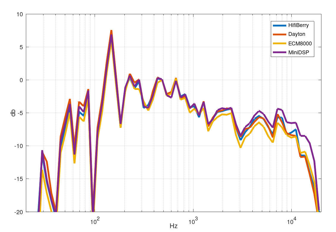

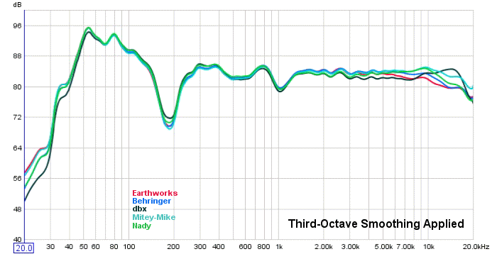

Normally I use old Clio with calibration file for their microphone, but also have 1/4" RST prepolarized free field mic that runs on CCP power supply. The RST has slots cut in capsule to correct the freq resp above 1k. The Clio and RST are within 0.5dB up to 10kHz, to 20kHz within 1dB. Even without Clio calibration they are very close to 10kHz. I guess, I got lucky.
Anyway the most important is that your microphone is flat within the most important 20-10kHz to have good data for crossover work. Also there is measurement system by Dayton but again it's a few hundred $, but I never seen one in action so I won't comment.how it works.

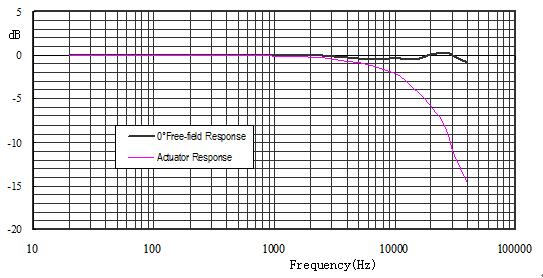

Measurement microphones traditionally fall apart in three categories: free field, pressure field and diffuse field types. For our purposes it actually isn't that important which type one uses. What is of importance is to know which correction should be applied at the various angles of incidence. We are mainly interested in free field measurements (unless you are working on room acoustics or with elaborate instruments like the Klippel NFS). The major brands offer correction curves at various angles and even the cheaper alternatives do give you 0 degree and 90 degree incidence correction. But you only have to point your mike in the direction of which you know the correction data.
