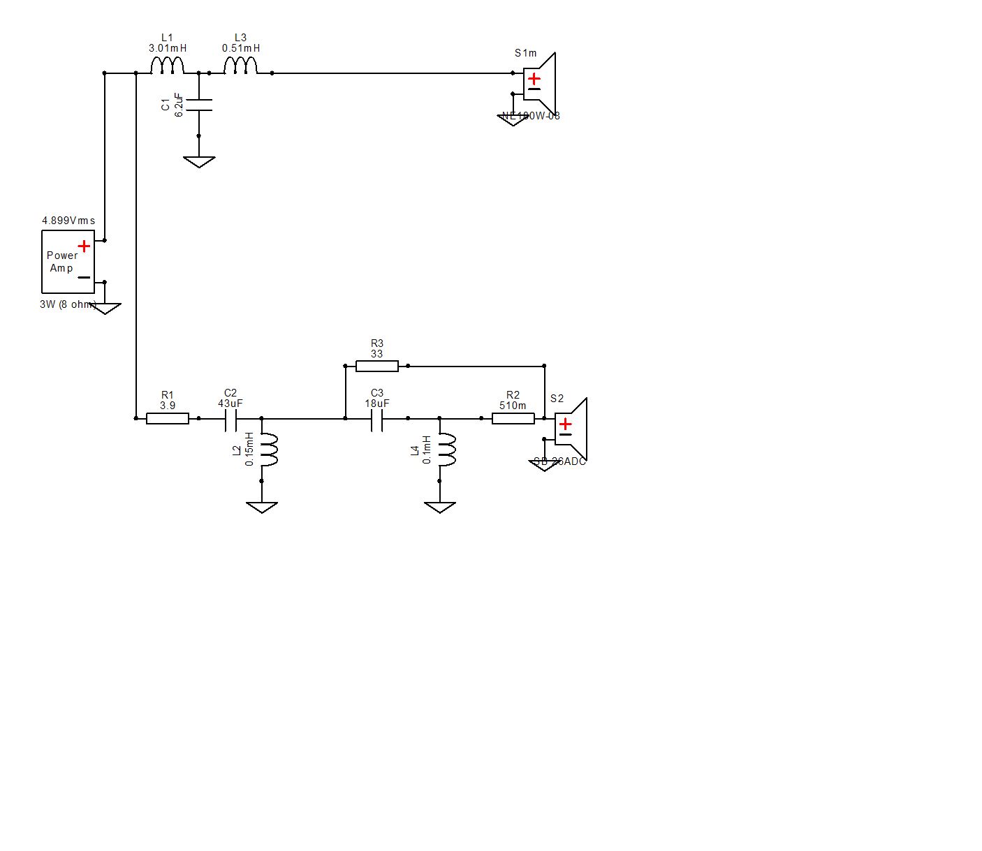

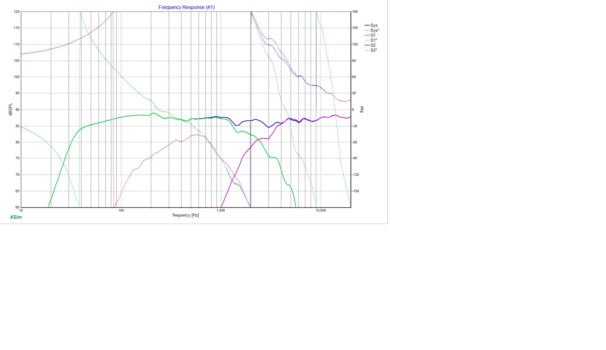

I reworked on the acoustic offset again and came up with this crossover as below

I think the tweeter branch could possibly be simplified but with a risk of low impedance making its presence known. At the same time you could save some money by using smaller capacitors. How does 8.2uf with a 200-300mH inductor and another 8.2 - 15uf plus a resistive L pad measure. You may have to flip the tweeter polarity to get something sensible ?

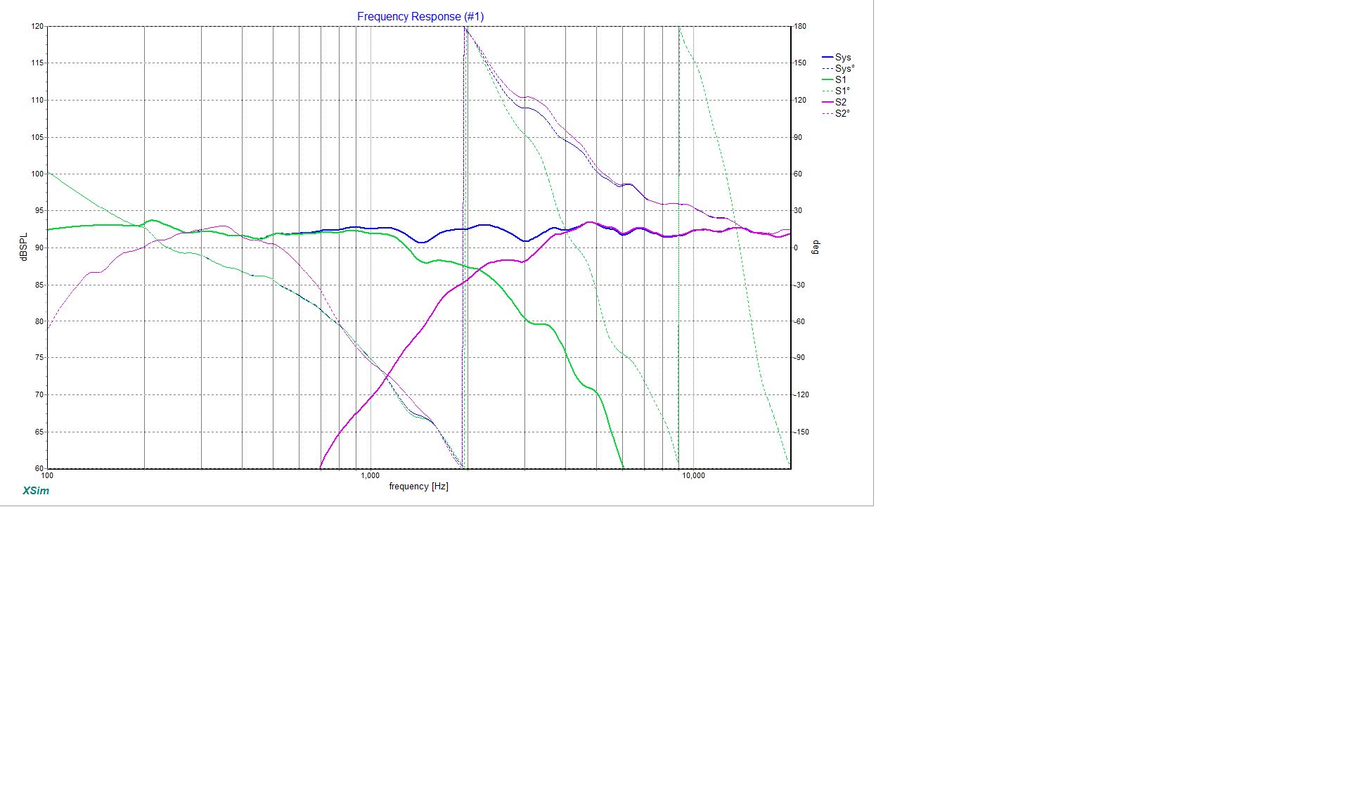

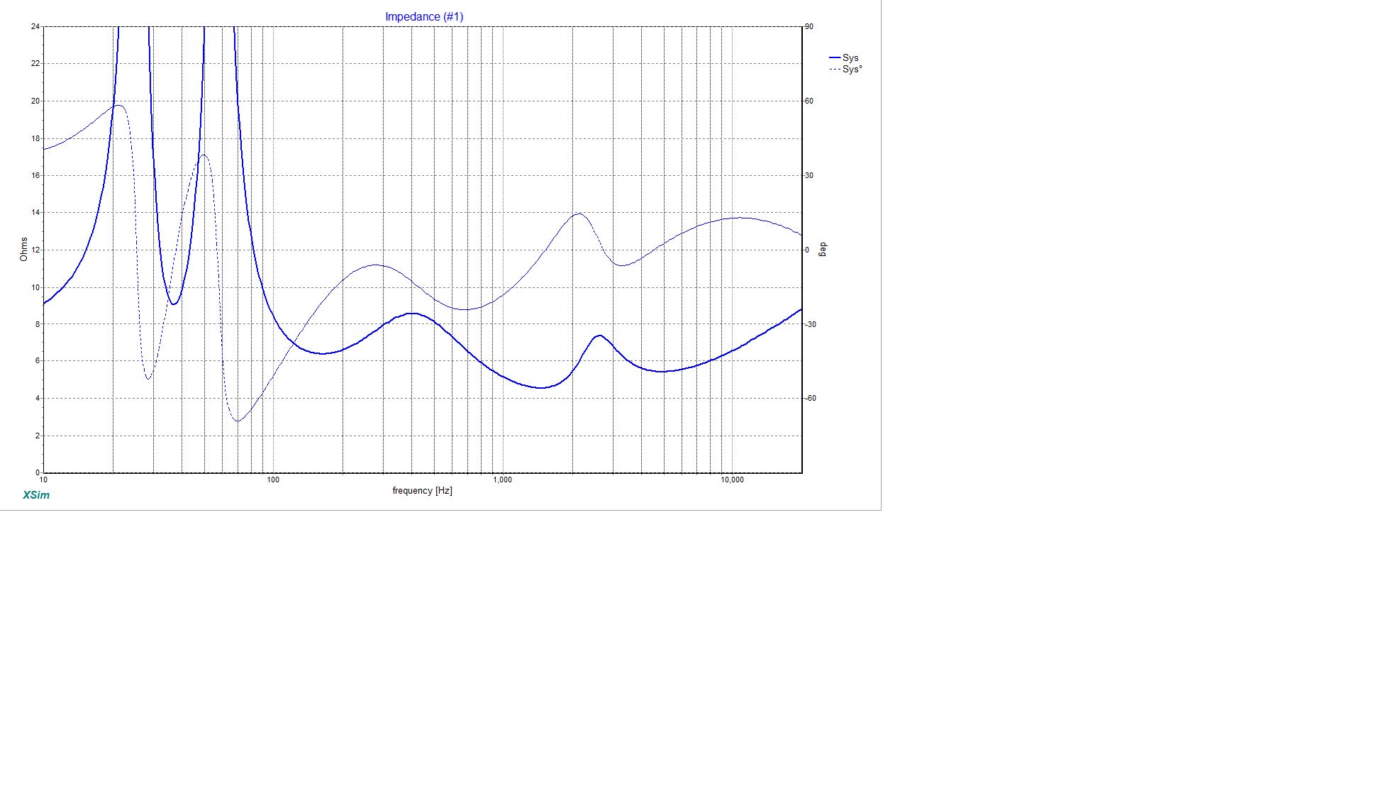

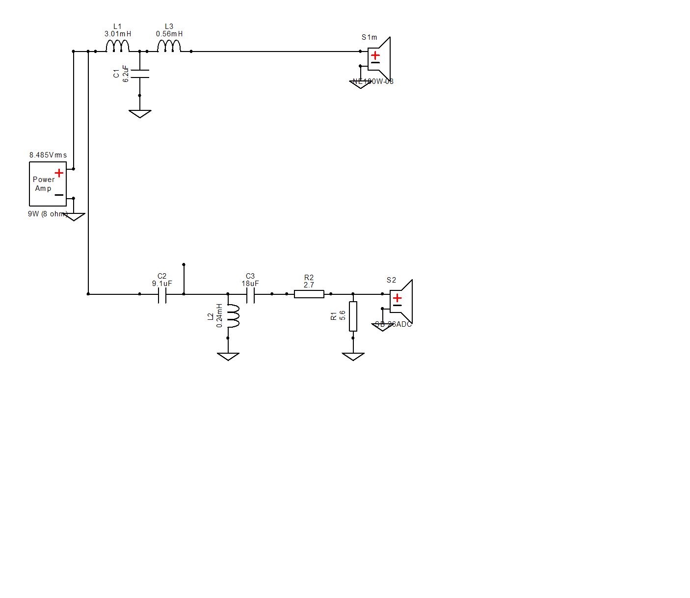

I followed what raymondj suggested. Here are the results. I am not very positive about the Impedance that resulted. What do you guys think? I am also attaching the .dxo (Xover file in Xsim) for tweaking. Thanks
I just tried following your suggestion. Please see the results and opine on the same. What do you think about the system impedance? Thanks
Yes your data is what I expected, and I did foresee the low impedance.
It's at a frequency where most amps should cope. I imagine you have used the L pad to help stabilise the impedance?
I think wait and see what others can do with it or what they next suggest.
Your earlier design would work, this one would work. I think you are getting close to a build and tweaking to what you like. Tweaking the L pad for variations on tweeter level should be easy and cheap. Do a few Sims with slightly more or less level and make a note of the values and buy them so you can easily adjust. The ones you don't use can go to building up your parts collection. I won't be able to do any Xsim for 12 hours or so until I get home tonight.

I understand what you are trying to mean. The system impedance is the issue with the XO. I shared the XO files in .dxo format(Xsim). Values of the components are also there. Please help me with an alternative XO design if you have spare time at hand.
I did have a look at your file and I really couldn't improve on the flat response that you have achieved. The impedance shouldn't worry any reasonably specified amplifier these days. I am fairly confident about the tweeter values and during listening tests you can play around with them to your hearts content.
Ideally I would like to have better phase info and I would like to know more about the NE180 it would be really useful if somebody could give us a frequency response on a known baffle.
The values that Xsim currently gives against the frequency response are quite large in terms of inductance and I cannot help but think it is overkill for such a well designed drive unit. Hopefully others will know better and add their comments. Infact If you look at Pliedka's information in post 20 you can see his 4th order Xover values and they are a fair bit lower than what we are using in the sim. Maybe he could share some further info?
