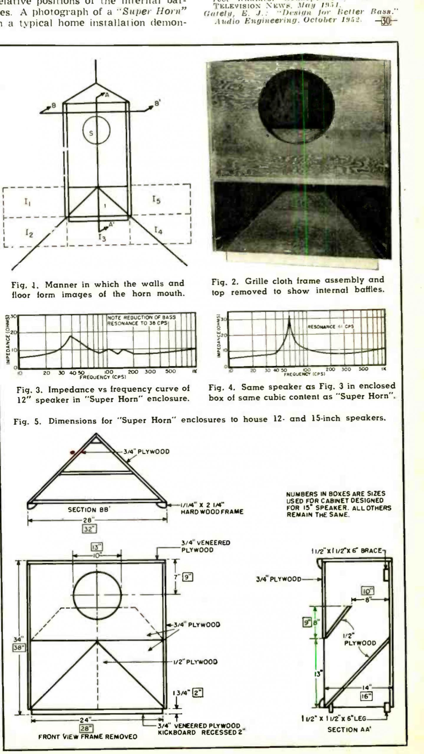

Finally weakened and bough a Fane 15-300TC.
I am building a W bin for it so some of the top end will be wasted but should still sound OK.

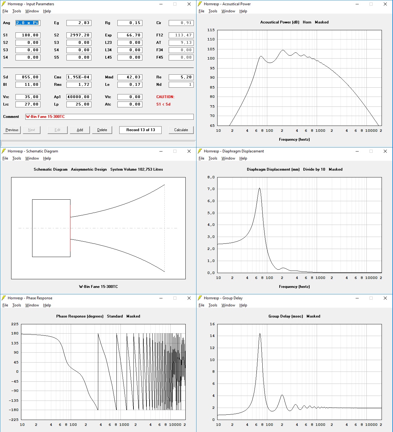

I am not entirely certain how to do w bins in hornresp. Really nice sensitivity, looking good. Solid to 70hz, but there's a delay peak there.
But the end result might look a little bit like this?
Edit:
Do note the excursion chart says to divide by 10. so it's 0,7mm not 7mm.

I don't have a setup for measuring the response.
I don't think the treble is as bad as the diagram says about 1KHz tops.
I have a W bin with a Fane 12-50WRMS driver and the treble on that is good.
