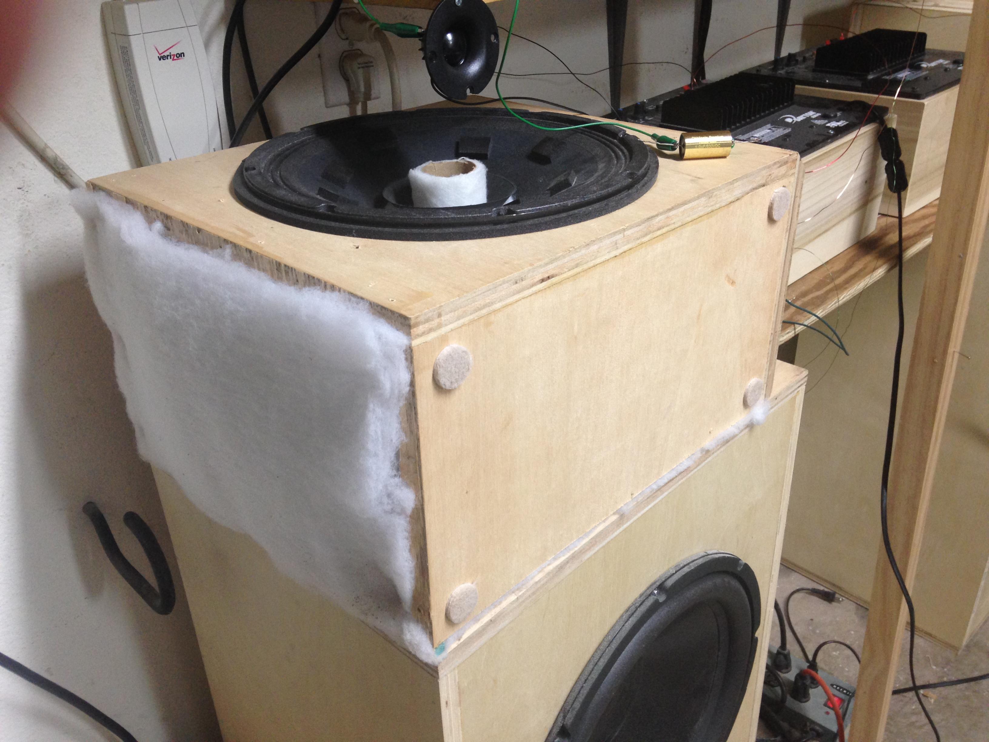

Not to sidetrack this thread, but has anyone tried these in an omnidirectional setup?
Through a series of events I ended up with my eminence beta 12lta's in a horizontal/Omni setup and then placed a dome tweeter vertical over the pole piece. Think Siegfried Linkwitz Pluto speaker with a 12" full range and tweeter. It seems to work well with the rising frequency response. Nice big and open sound and pleasant highs. Adjust tweeter to taste.
Thought it was worth sharing.
Do say more kind sir!
I've got me ol' beta12LTs and was wondering what I could try with them.
Cab size / shape? Pic?

I brought this up because so many people mentioned how good the Fane sounded off axis.
Disclaimer: This is a Garage system and it is in development. Alway. I guess that goes without saying.
It was by accident that I came up with this. I hooked this up so I would have something to listen to while I worked on another speaker box in the garage. It is a five sided box open on one side and this is the left box. It is stuffed with polyfil and has some on the side. ~1ft3. It is on top of a sealed 15" woofer per channel. The right speaker is mirror image. And tweeter has first order xo. 1uF cap.
The combination of horizontal driver and open box has a nice open yet full sound. And I can put it near the wall which is important for floor space.
My wife's comment "it sounds musical". A good endorsement.
Now I need to tweek the concept and make it look better which should not be hard.
Photo attached
It ain't pretty, yet. But it sounds good.
Well, you should have glued the damping blocks on the membrane to the back of it.
What tweeter is this? I can't imagine the dome tweeter does around 100dB at 1W.
Scott: do you have a picture of your setup? Pictures are good. 🙂

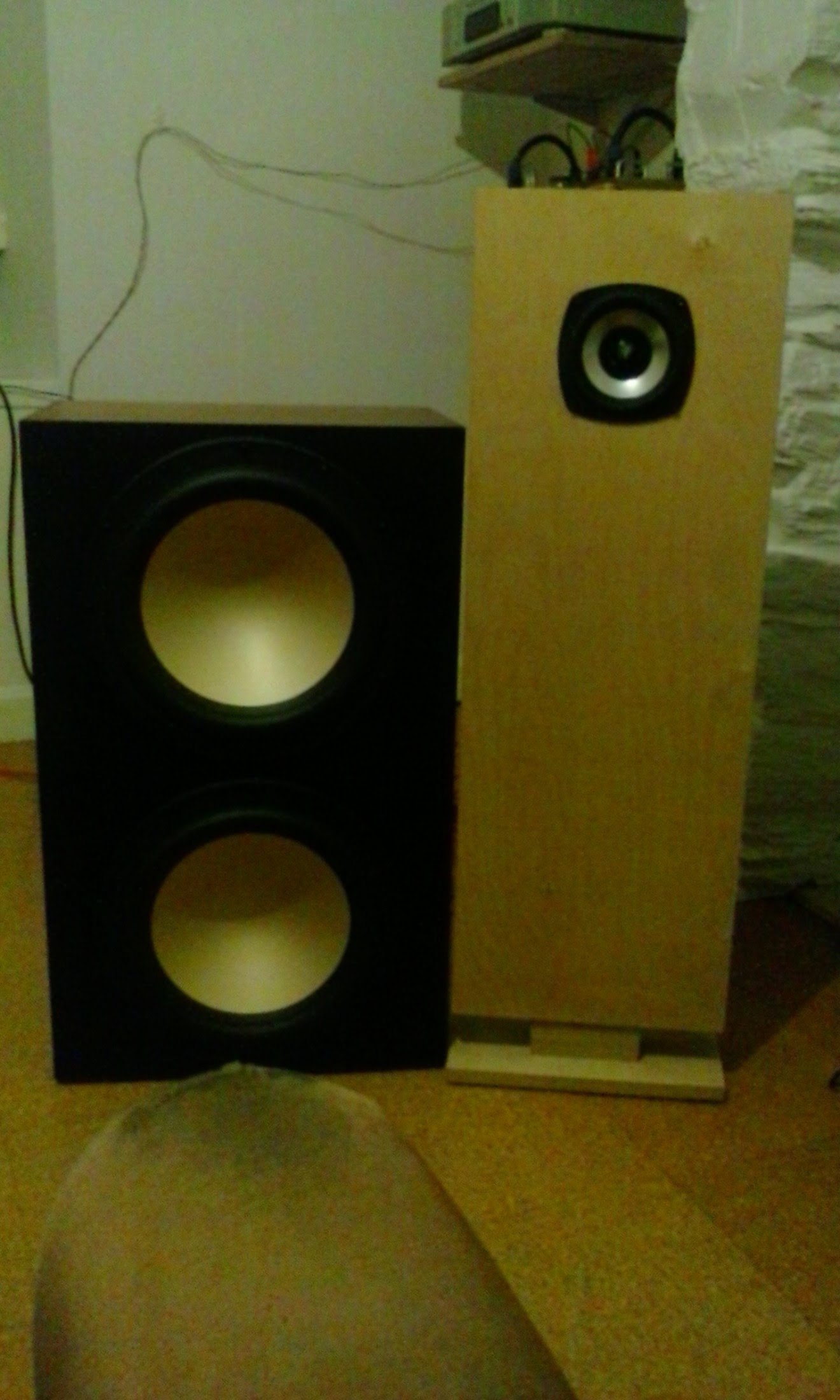

Have you tried crossing over higher, and without summing a mono channel?
Those drivers look nice, what are they?
... Alu cone and butyl rubber surround?
Up until recently I had the crossover a little higher and in stereo, I'm trying to kill two birds with one stone, effectively using them as multiple mono subs to help fight room modes. The widebands are Jordan Eikonas, and the woofers are HiVi M12's

Scott: I've never had much issues with room modes in OB. Maybe something else is "off".
Tried placing them closer to back wall instead?
Sometimes bass in OB sounds better close to walls, depends on the room.
With qts 0.33 and fs 27hz I guess you use some EQ down low.
