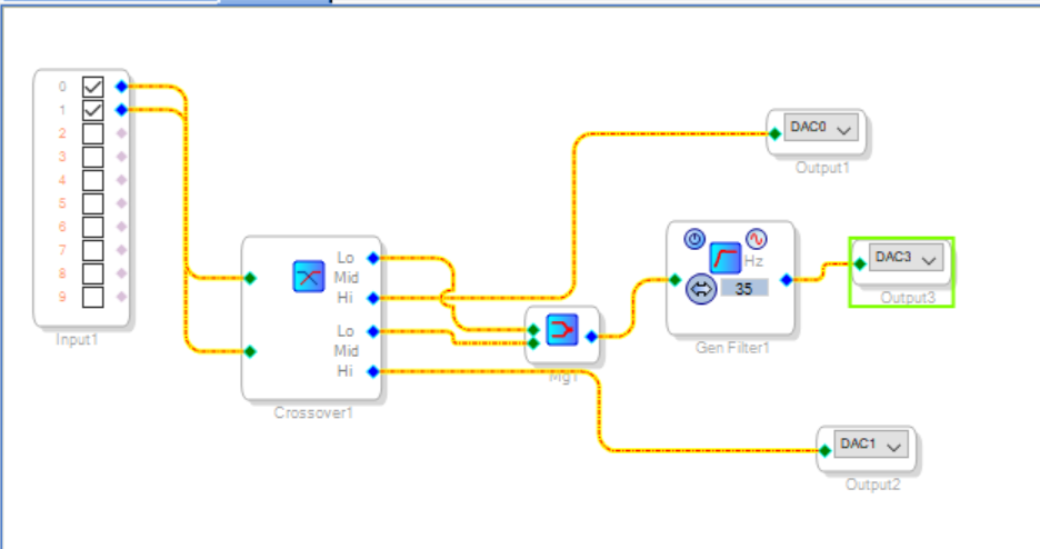

This is my DSP in Sigma Studio - separating lows and highs at ~130 Hz, and high passing with a first order filter at 35 hz the sub. I have no clue what i'm doing; it's working but could it be better? Probably.

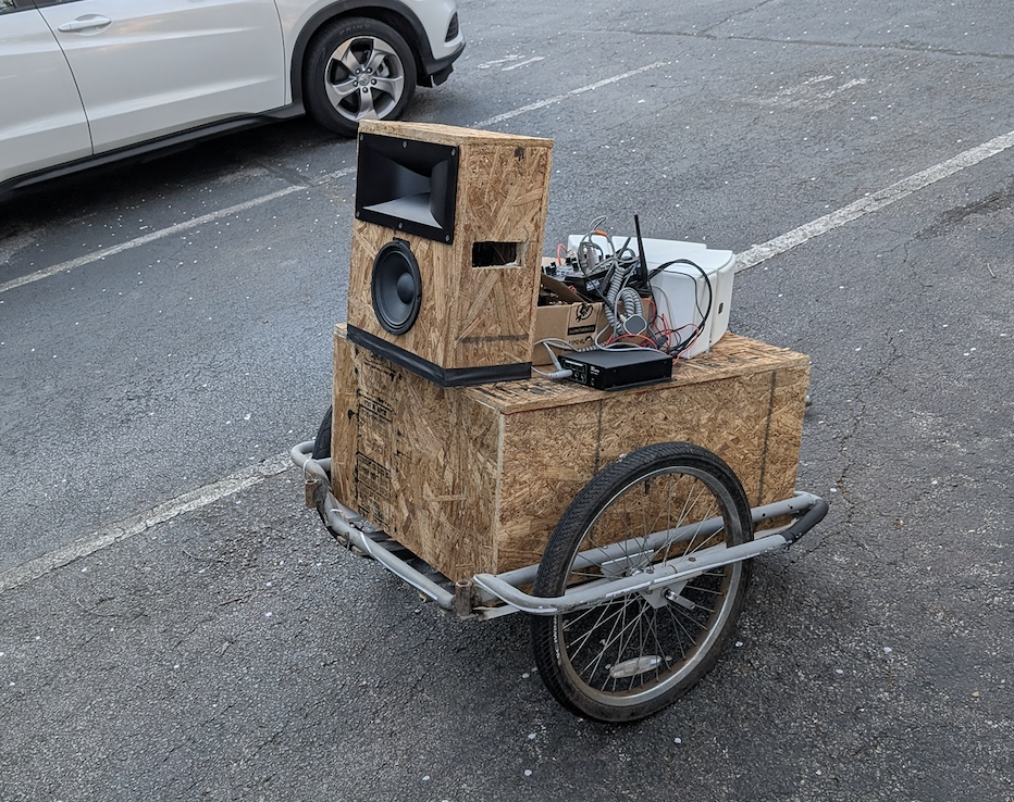

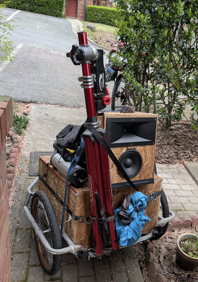

I gave it a first minor ride (and used it at my friend's birthday where we kept it below 50% power for noise reasons) - check it out below 🙂
the two white things are off the shelf outdoor speakers (polk audio m3 I got used) while the other one is obviously one I made. I do have a second that needs to be rebuilt (I made two different designs only one of which I liked).
I ran it for about 7h at 50% volume and still had over half my battery left (and I had a spare ready to swap out)
Now to see how long I leave these in their temporary OSB boxes/till I make them into proper quality plywood... and better build quality. These were my first time using a nail gun
Gravity is all that's holding the subwoofer box in place, with the top ratchet strapped to it... and some janky controls elsewhere. The amp/control box (also does voltage conversions) is in a literal cardboard box while I figure out the best way to do it.

Great work!
Importantly, how does it sound and are you happy with the outcome?
The hardest part will be deciding if you want to rebuild the setup or just use it as-is, since once the fun starts it's hard to get back in the workshop again
I am quite happy with the outcome - other than still having noise issues. Great bass, and works amazing on the bicycle trailer - plus since it's pointing down I can use the sub to hold things; strap things to it; etc.
I definitly will be taking apart one of the tops - I like the design of the one in the pic but have a second design I had made that I don't like. But yeah... we'll see how long the OSB lasts... I do definitly want to redo it because the construction is... iffy.
One thing I did as a modification to improve it which I really like is having threaded rods going through it pulling the front and back together - it really got rid of the vibrations in the front and back with a negligible amount of extra weight. And provides spots for things to be held on top.
But I also want to upgrade the tops to 8" drivers... probably... and 100% need to upgrade to a new control box to replace the cardboard... and add lighting to the trailer... so who knows how long a rebuild will get delayed 🙂
Yep! Ultimately the deciding factor was being able to easily customize the ratio/shape to fit the trailer design - so it fully covers the footprint trailer minimizing how tall it is, helping to keep the center of gravity low and prevent tip over... and especially keeping the driver near the bottom to further concentrate the weight at the bottom.
