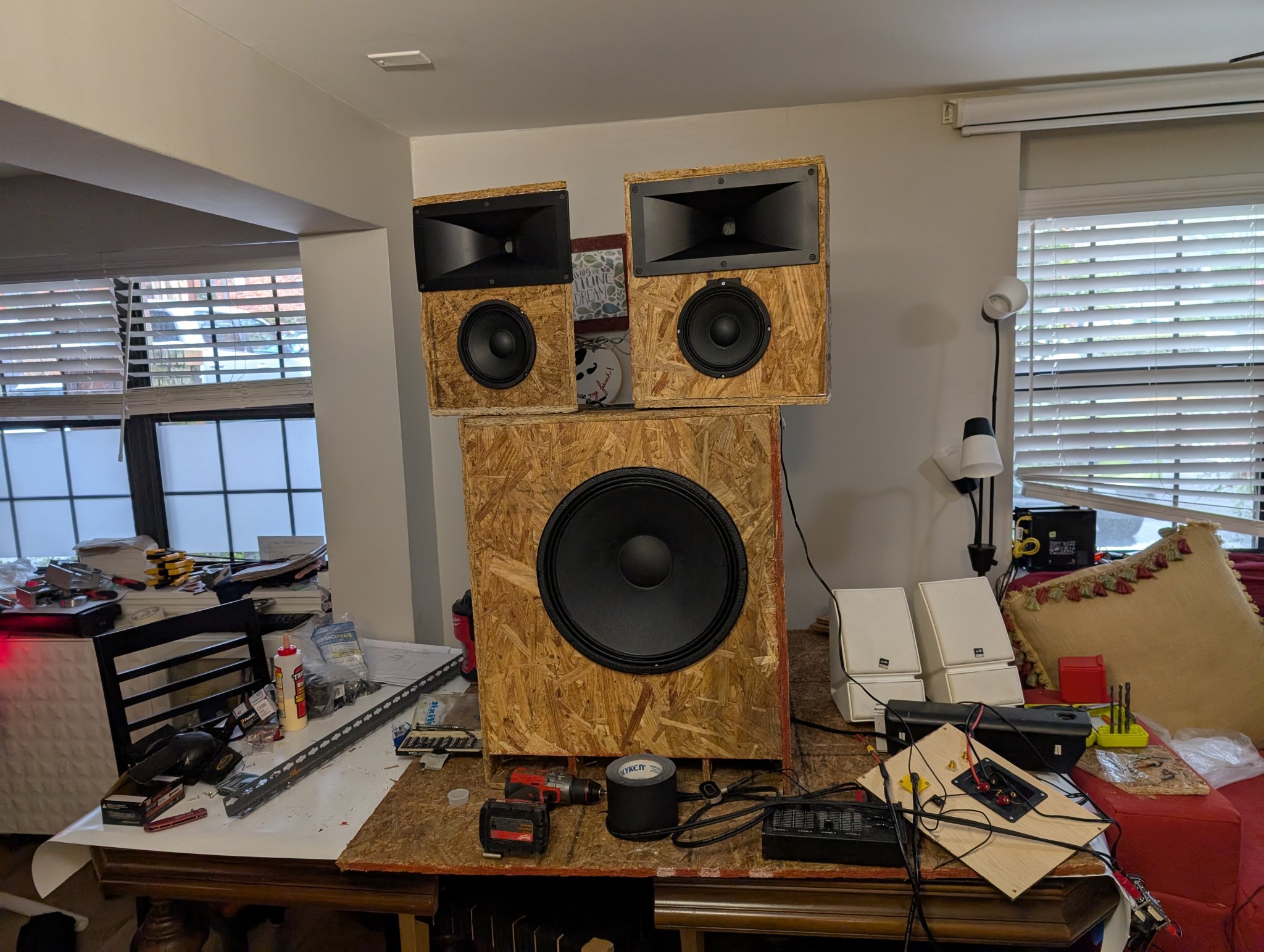

Got a first draft of the sub and tops. A few necessary design changes:
At some point the width went from 22" to 23" and no longer fits in the trailer.
When designing I threw the driver cutout circle and went 'i'll center that later' and never did... but built to the plan.
More importantly this is far quieter than I want it to be. I'm hoping part of that might be input related - I had previously had a pre-amp between the mixer and the amp; but using DSP now, that took the pre-amp out of the path (and now I need a 3rd preamp channel; it was previously a passive one).
But I'm running 8 amp speakers which is going to be hard to run regardless. With 50V input voltage, I think I might need to change my amps (despite my assurance at the previous step). Or change my design - I was pondering returning the 15" driver and getting two 12" drivers... but don't have particularly good ideas for which to do. (Driver weight should be kept below 25lb total (and 15 lb is ideal). And $350 total ($250 preferred)).
Open to suggestions!

The sub is ridiculous, I mean...
The driver itself doesn't look like a sub...first rule of a sub is that it's got be in-efficient, more on the 80-85 dB/W than 90-95 dB/W figure, so a heavy cone, the suspensions ( spider & external roll ) and a long throw ( at least 10 mm...) that are requested for heavy duty operation at low Hertz.
The cabinet should be heavy and sound proof, because you'd want only the cone to move.
I don't see a subwoofer driver nor a heavy cabinet.
The boxes...I would have taken a 8"...dunno, the proportions are for the eye...and the ear.

Hey @cycrev I feel like I'm obliged to contribute, but apologies for not following along... let's talk about the where you landed with the build, which you seem to be disappointed with
What driver did you use for the bass box?
And after the dimension error, have you confirmed the box volume and tuning as a "sense check" based on the build?
I would expect a pro audio bass driver, in a ~100L box tuned to ~45Hz, should make a decent amount of noise with the amps you have...
Maybe the signal path needs some attention, especially since you mentioned addition of DSP and removal of preamp
At a guess, I would suggest the amp isn't getting a hot enough signal for it to drive the speaker as expected
Can you list the components in your signal chain and how they're connected?
And maybe strip everything down to basics, do some testing with a AC RMS multimeter and see what you can do to get a 10V sine wave out of the amp and run the speaker with that. Once you can get it outputting to a level you expect, you can add back the DSP and tops to build out the system

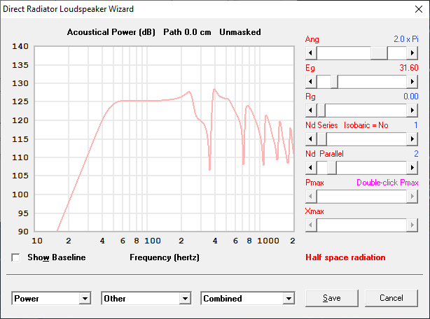

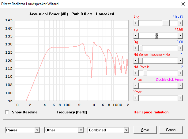

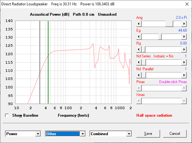

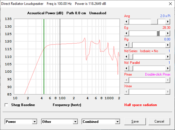

Do you go with the 113 L box tuned to 45 Hz with the Odeum 15N driver? If so, at 250W the output should look like the following, with lots of upper bass:
That level should be noticeable.

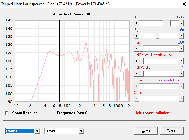

@100W, the response should look something like this. 118dB is loud, but it's not as loud as it would be at 250W 🙂
To go louder than that with that driver, you'll need to use a higher-order design like a TH, but that's likely going to require a larger box.
e.g. a simple single-expansion TH (like the MTH30, sized to fit your driver), will get you a few more dB with the same 250W input, but will require a box that's twice the volume (once you take the volume displaced by the internal panels into consideration):
However, given that amount of volume to work with, I'd consider just adding another driver in parallel in a vented box taking up the same volume as the TH. The total impedance will drop to 4 ohms, allowing your amp to deliver more power (theoretically double the amount), which will result in this:
If we're stuck with 250W, then the result with the two drivers in the same volume occupied by the TH should be something like this:
If you do want to try the SS15 TH out, check to see if your existing driver will work in it (just plug your driver's parameters into the corresponding Hornresp model). Alternatively, you could use my BOXPLAN workbook to design an "SS" type TH of your own. Size however will likely end up being over 200L net, almost double the volume of your current vented box.
