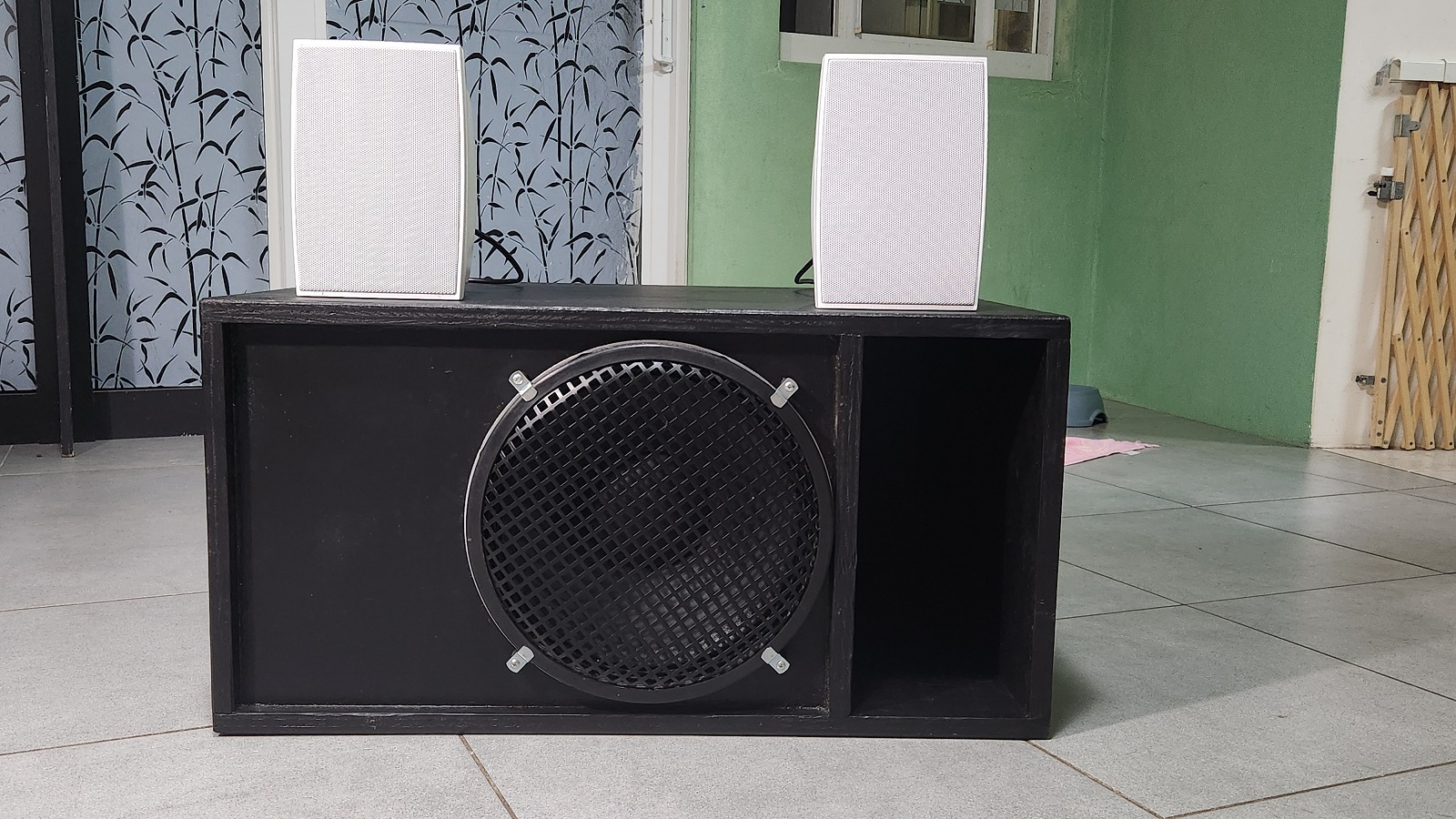

As I proved with my "Plan B" build (see image) at the hash this Saturday, the more the bass speaker can reach into the midbass region, the smaller the tops can be. The end result is less weight and less "pack" volume to worry about for what is obviously meant to be a small mobile build.
There's an additional advantage crossing over high that I just proved with some measurements today - any "floor bounce" effect is basically eliminated.

Someone at the hash actually asked me if the tops were Bose speakers, LOL. Monoprice was offloading them for $60 a pair, so I couldn't resist buying a pair of them to mess around with. Their measured frequency response was... not good, and a look inside showed why - no LP filter on the woofer and an NPE capacitor on the tweeter. To improve things a bit, I added a .67mH coil in series with the woofer and replaced the NPE capacitor on the tweeter with a 2.5 uF poly cap. The result was a smoother but still upward-tilting response - my idea was to fix that with DSP if I ever put them into use. Then I put them into storage, about a year ago. If I knew then what I'd eventually end up using them for, I would have bought a few more pairs, LOL. Maybe pole-mount a stack of four, one facing each direction, for omnidirectional coverage.
At the hash, I used a 24dB LR x-over at 150 Hz between them and the bass speaker. Next time I'm going to try a 12dB x-over instead, which should allow me to push up the bass a bit more without it sounding too weird. Oh, and being designed for outdoor use, they're waterproof. The bass speaker, not so much ...

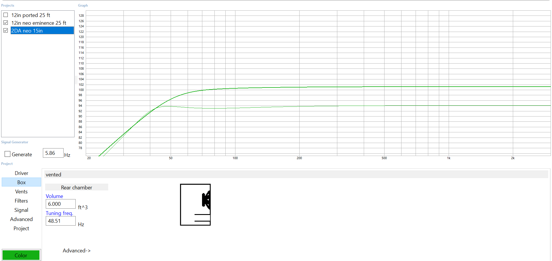

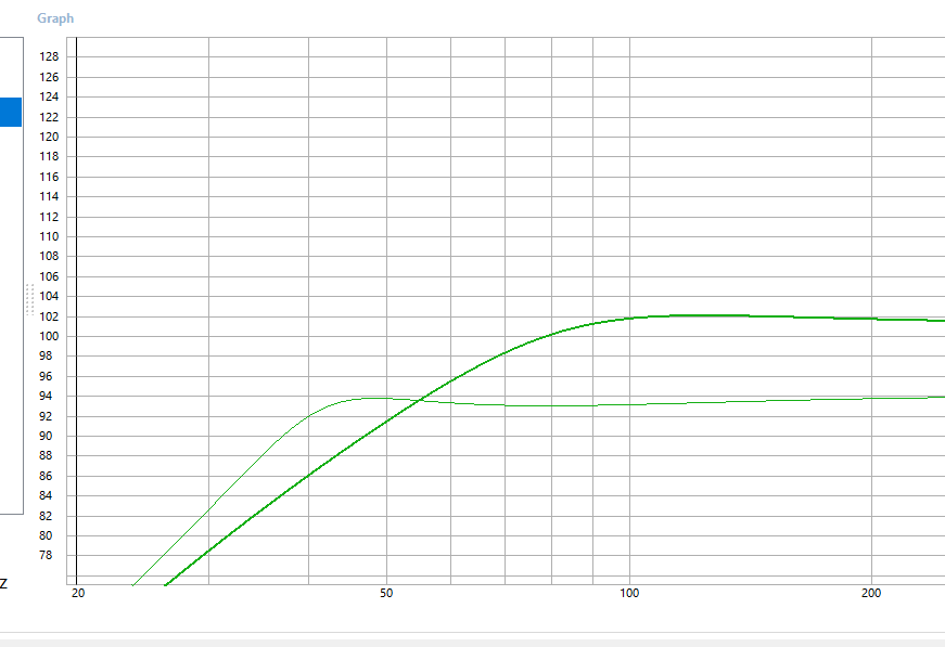

How about this - Dayton Audio Odeum 15N, a 15" neo driver designed for midbass duty, but the specs suggest you can get down to 44 Hz with it with a bit of EQ at the low end. $153 for one, weighs 14 pounds. Use two in the largest box you're comfortable using, tune to 44 Hz, fix the response at the low end with DSP / EQ.
@Brian Steele

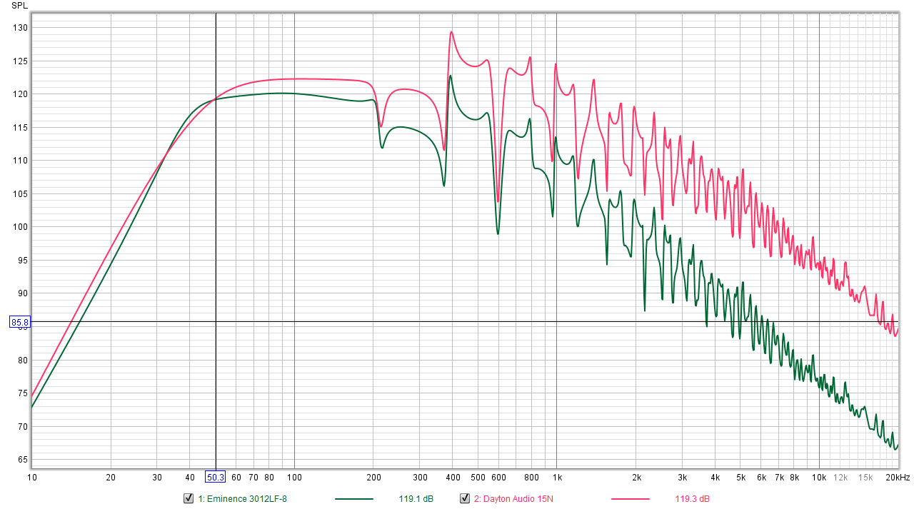

Putting 2 in a box means the box wants to be double the size. Comparing the 12" eminence neo sub driver to 2 of the DA15" drivers; the 12" in a 3.5ft box; the DA in a6ft box; the have the same cutoff. But 6 ft is too big. (1W each)
Putting them in the same 3.5 ft box; the eminence with 1 driver is clearly better at the low end.

It looks like I am making mistakes with winISD then. That's what happens when I try using the easier software.

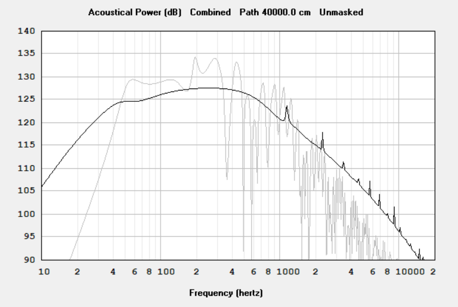

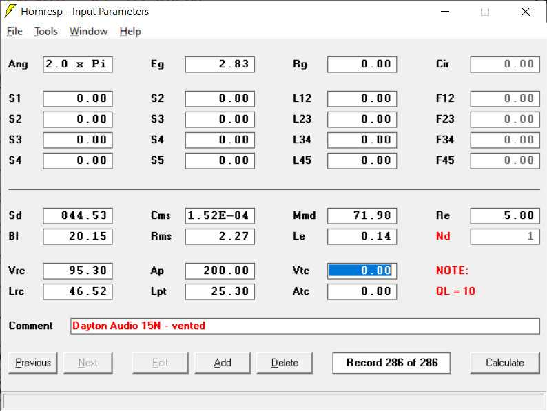

Hmmm. 250W in a tham12 vs a 1 DA driver in a 99lboxThis is what I'm getting in Hornresp, both drivers in 100 L tuned to around 44 Hz, driven @250W into 8 ohms. The 15N provides more output (and more importantly, more output where it counts), except for around 2dB near Fb.
And here's the 2 DA driver in a 99l box
So I do see what you mean; the tham12 isn't really offering much more... though somehow after doing that I am no longer getting the same simulation results.
Any clue why I was getting the same as you but now can't get it to give the same results at all?

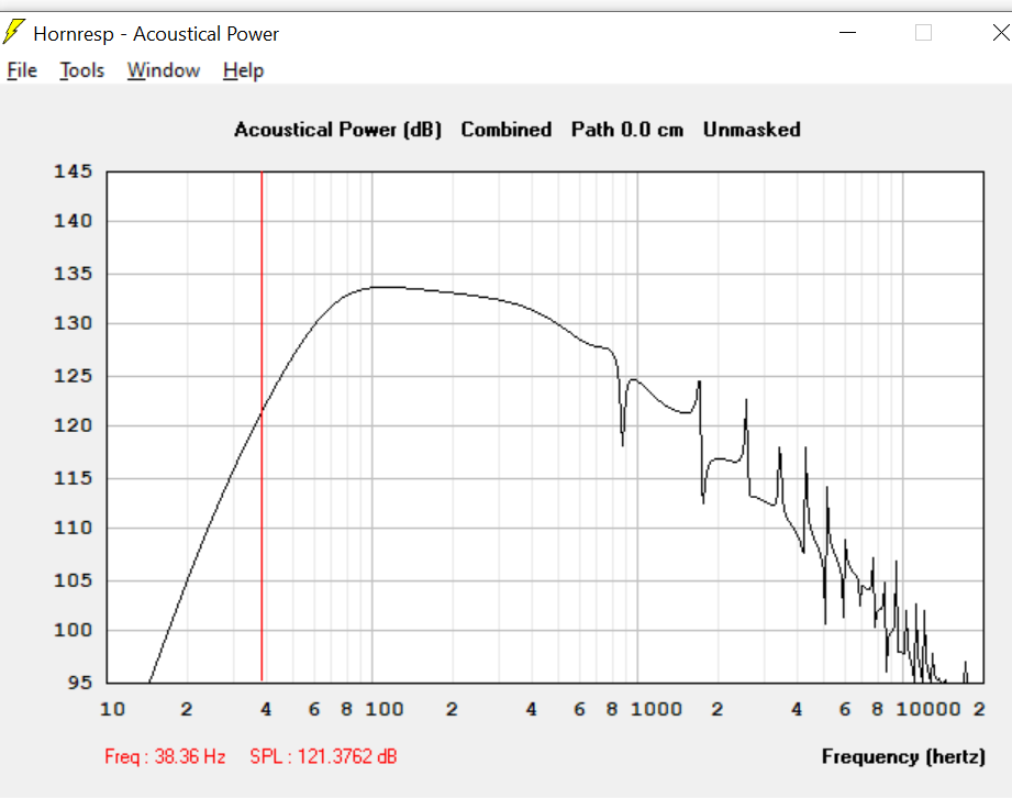

Here's a sim with the DA driver in a 100L (total) box tuned to 40 Hz.

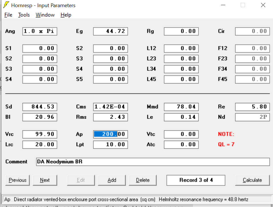

Note that the "Ang" parameter should be set to 2xPI for comparison with other box modeling programs
I think the main difference between your sim and mine is the setting for Ang and that you didn't extend the vent ("Lpt") to lower Fb. I also assumed Ql=10, which means a well-built box with good bracing and no leaks 🙂.

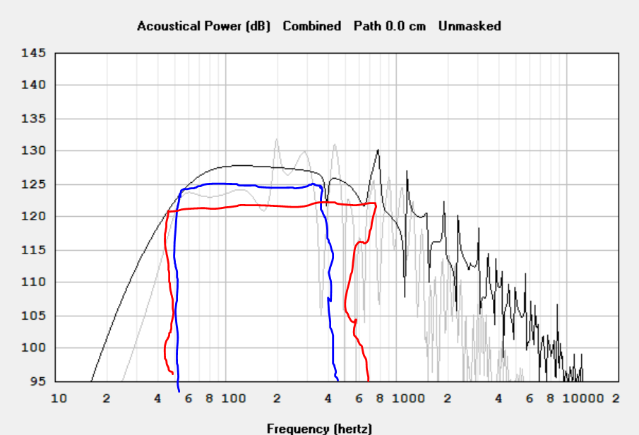

To confirm I understand your suggestion - you say build the 2 DA neo woofer in a 100l box tuned to 40 (pictured) and then use agressive DSP to bring it to the blue or red lines (so cutting 5-8db to keep it flat).
That does let me have a much higher transition to tops, right? At about 400 hz? (The gray is comparing to a tham12)

If I was going for 2 of the 15s, I'd try to go for a larger box, e.g. 150L, but you got the rest right - just adjust the response with DSP. I'd use the DSP to boost the bass @40 Hz at lower power levels and back off the boost at higher volume levels, for example.
I wouldn't cross over as high as 400 Hz. That would be really pushing it, LOL. Stay below 200 Hz. the closer the main speakers to the subwoofer, the higher you can cross them over.

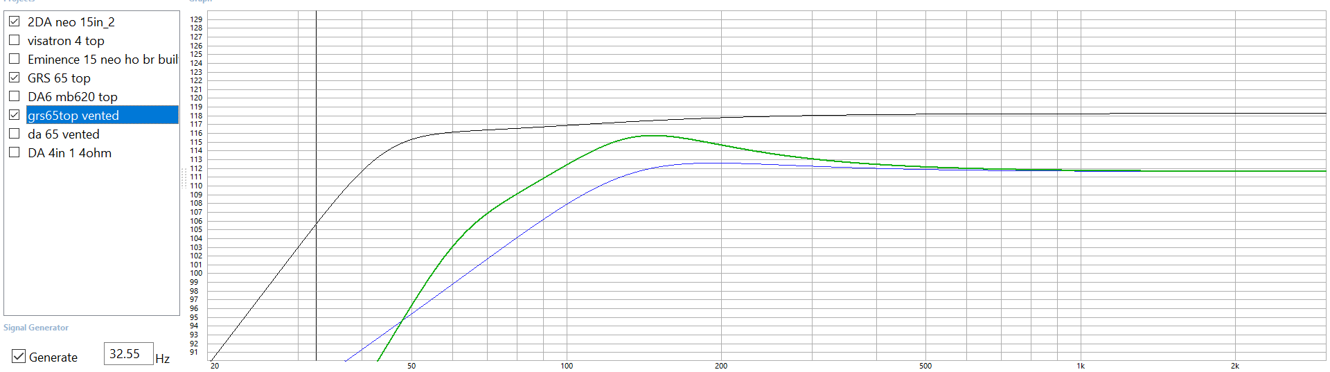

I've got the below tentative designs for my top (green (vented) and blue(sealed)) comparing to the sub (black). Where I would be crossing over about 150.
And my physical design of the speaker 🙂

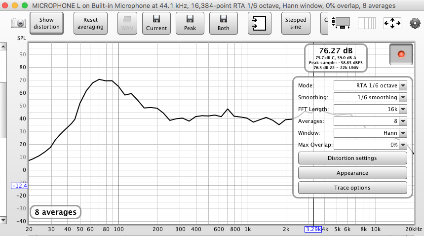

The typical low end playback "haystack" can range from ~+10dB to over 20dB above the >150Hz range.How should the SPLs of the music for sub vs higher end be? I've heard subs tend to need to be louder, while higher frequencies should be softer.
I'll give that question for psytrance and for pop/rock.
You can play your music through a RTA like the REW example above to see what it looks like.
Wow, 20dB down @ 50 Hz from the bass peak. What's that a measurement of?
