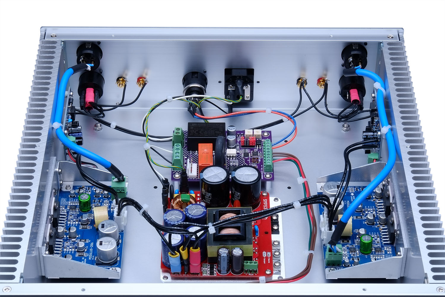

My latest project: Stereo Modulus-286 with Guardian-86 speaker protection. Powered by the Connex SMPS300REh power supply controlled by my ISS Rev. 2.0 prototype (which will be replaced by the production version once it gets in).
I'm building five of these. One has sold already ($2500).
Tom

Tom,
Nice unit, congratulations! Is that a natural anodized aluminum, or has a little bit of white anodizing been done?
A question - doesn't the SMPS already have a built-in soft start? Also there is no transformer and large capacitor banks - so would there be strong inrush currents?
Holy, that purple PCB is absolutely killer.
Yeah. I'm using OSH Park for prototypes now. I've often thought of asking them if their founder went to University of Washington. Huskies are purple and gold. 🙂
The production version of the ISS will be Neurochrome Blue as always.
What panel connector have you used for the trigger input, it's not from Neutrik is it?
Nope. Switchcraft. It's a 3.5 mm stereo jack.
Where is the power lead coming from for the Guardian-86s?
I soldered it directly to the power connector on the MOD286 on the bottom of the PCB.
As far as I know it's clear anodized. I think it's the surface finish that gives it a brighter look. It's a very, very light hairline finish. It's smooth to the touch. I really like it.
It does. I'm using the ISS mostly as a fancy power switch. I wanted the LED dimmers as the LEDs in the PV6-series power switch are quite bright. I also wanted to support 12 V trigger. Further, the low-voltage control opens up a wide array of options for power switches. So that's why I use the ISS.
Tom
