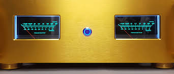

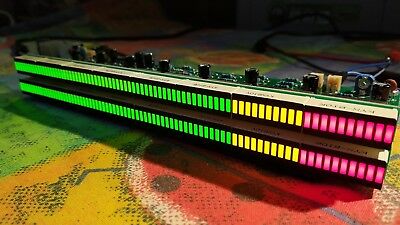

Hello Forum Members
I am new in this forum and new to high quality amps. I do analogue and digital electronics since years but nothing high quality like this. Now I think about building this amp.
I read this thread from the beginning to the end and it's very interesting.
What I didn't see are any ideas about VU-Meters on the front panel. Is that something that audiophiles don't like or is it no fashion anymore or are there technical reasons why nobody in this thread (and other threads) even mentioned it.
I have something like this in mind. It might be analoge, LEDs, or even an Arduino with an OLED display. What do you think about them?
