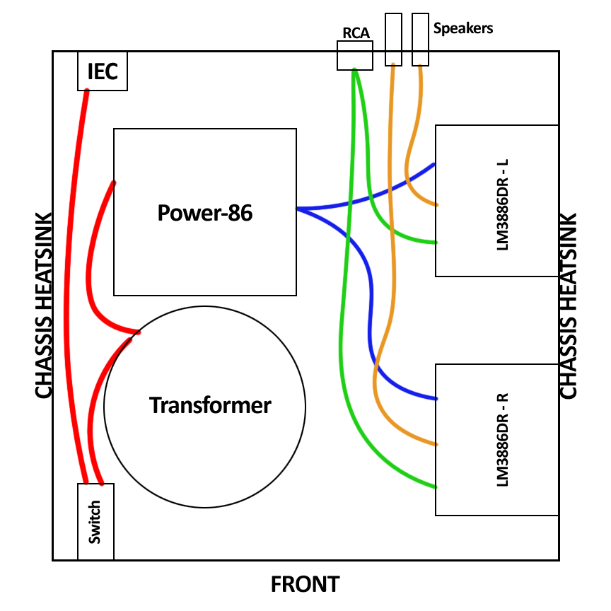

So, with the wait until some of the remaining components and connectors arrive from Mouser, my mind has turned to the chassis since I can get on with this in the meantime.
I've gone for a Mini Dissipante chassis from Modushop. This has the heatsinks built in to both sides. The variant I have gone for has internal dimensions of 10" x 10" (250mm x 250mm). I think I could have squeezed it into a slightly smaller chassis, but space isn't an issue particularly so I thought I've give myself a little more breathing space.
At first glance, the obvious way to try and lay things out is to place one amplifier board onto each of the sides. However, since the IEC will be at the back running to a switch at the front, this means running the mains power either beside one of the amplifier boards, or down the middle of the chassis.
Since the chassis heatsinks are rated at 0.47 °C/W, it seems that just one of the heatsinks could cope easily with both amplifier boards. With that in mind, I've come up with the attached layout (pretty much to scale I think). Does this seem sensible or should I revert to one amplifier board per heatsink?
Check out blackskull's Modulus-86 build in the other thread. He used the 300mm depth version of the mini dissipante, but went for the same layout you are proposing. Presumably works OK.
I think it makes good sense to put both amp channels on the same 0.47K/W heat sink. The overall chassis layout seems fine to me as well.

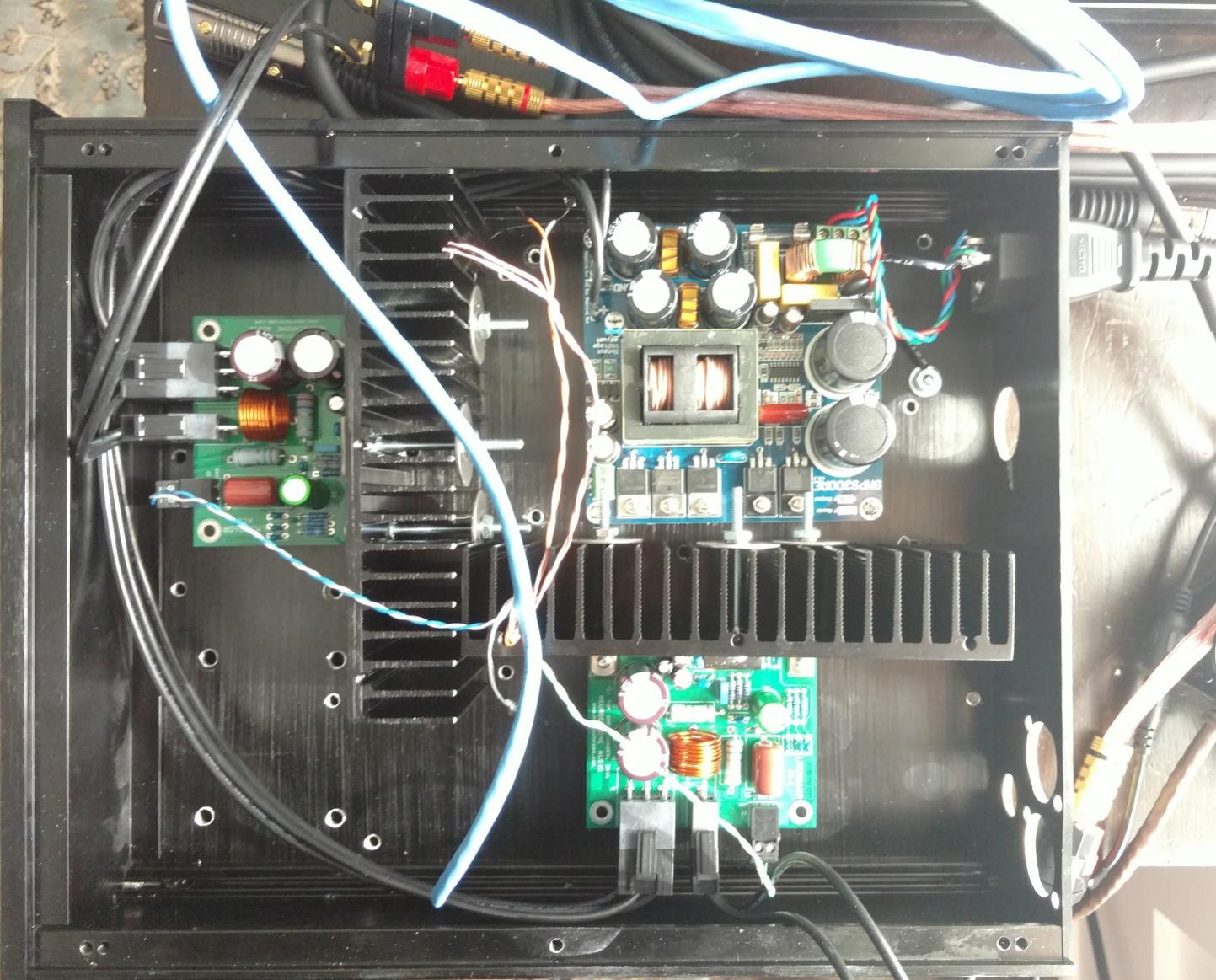

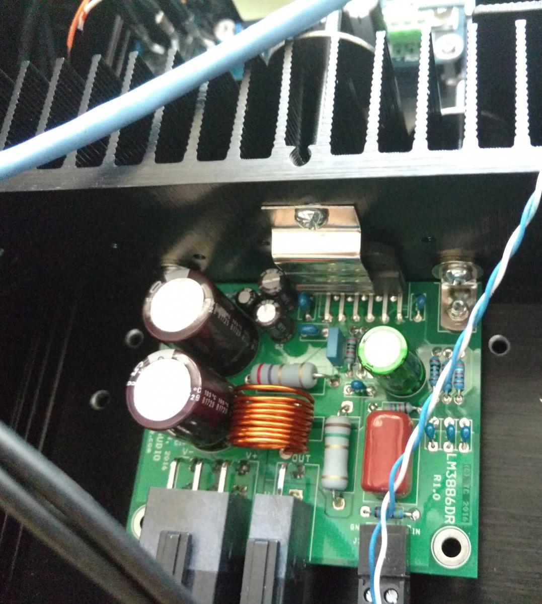

I've been using the my LM3886DR amp for almost a year now but unfortunately I have to come back to addressing a hum/noise issue I am having. There have been a few suggestions from Tom and scottjoplin (thank for pointing me to Earthing (Grounding) Your Hi-Fi - Tricks and Techniques) and I have done my best to go through all of it - unfortunately no success so far.
I'll try another shot at this and would be most thankful for your help.
The current situation:

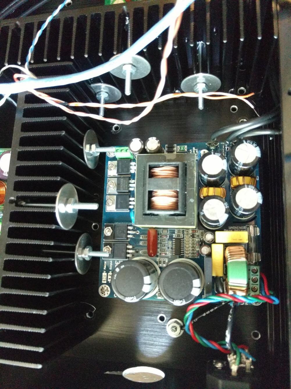

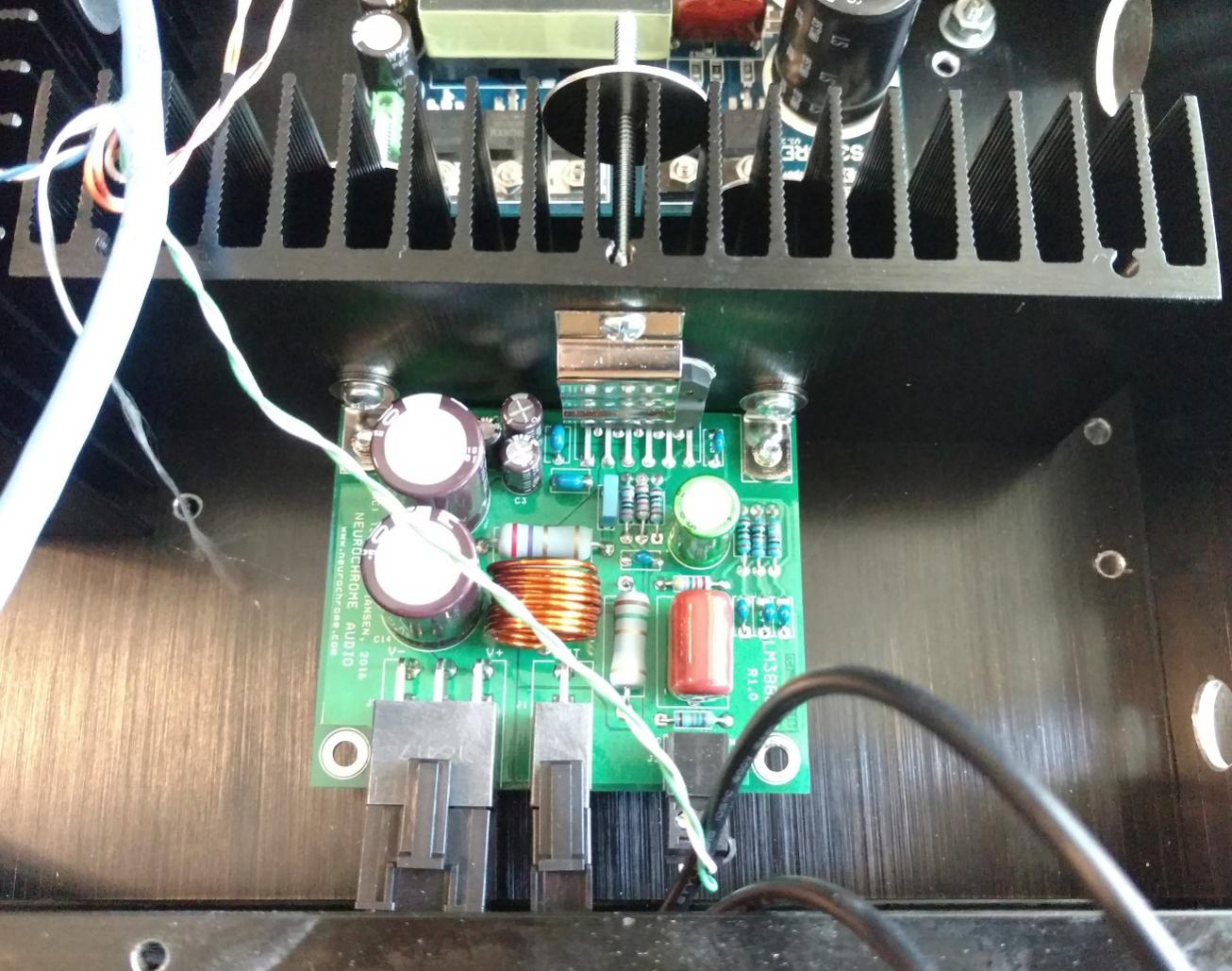

The LM3886DR is installed in an enclosure together with an SMPS86 power supply. Grounding according to Tom's manuals. I used to have a volume pot in there but removed it recently to control volume with a Pass B1 preamp. I thought the Volume Pot might have been the culprit but removing it didn't change anything. Actually things got bit worse as now the hum/buzz is louder. It seems the hum/buzz originated from somewhere "in front" of the pot as it was then attenuated before it got to the 3886 amplifier. Now that there's no pot the noise floor is at full volume all the time.
The hum/buzz gets louder the more I connect to the amps input. For example:
Amp turned on, nothing connected at inputs: very faint noise.
Amp turned on, RCA cables plugged in (loose ends, no source): noise gets louder.
Amp turned on, source connnected: noise gets even louder.
For the last point (source connected) it will make no difference whether i plug in the B1 preamp, a phono stage, iPod, etc.... the noise will increase by the same amount. The noise will also increase if the source is switched off.
Earlier on Tom suggested lifting the ground. I tried that without success. Although I am not sure if it would be enough to remove the cable that runs from the grounding lug to the chassis. I suspect that the chassis is also connected to ground via one of the mounting screws. Tom, can you comment on that?
As mentioned earlier I read through the grounding article on the ESP site and this comment on SMPS really grabbed my attention:
"Switchmode supply noise and any high frequency noise on the mains now flows in the shield of the interconnect. This is not really an earth loop as such, and the result is more likely to be a harsh (grating) hissing sound. It is quite distinctly different from normal thermal noise, and is also more intrusive."
Could this be the issue?
I know this is a very long post and I thank you guys in advance for any suggestions you might have.

If the noise is present when you short the input (i.e. connect the RCA shell to the centre conductor), the problem is in the amp. Is this the case for you?
You can check out a ground loop breaker (usually a diode bridge). I'm generally not a fan of loop breakers, I'd rather fix the loop, but they may be a good fix for you. There's also a neat circuit in the Pass F5 Turbo power supply that uses an NTC resistor. Google "F5 schematic" and you'll find it.
I have had one shorting plug for a few month and if i plug it into the output the channel will be completely quiet. BUT: today i made a second shorting plug and if i short both channels at the same time the noise returns on both channels. 😕
Problem is in the amp then. I know for sure that it's possible to build the amp as a stereo amp and have it be completely quiet, so I'd look at any potential for current to flow in the ground connections to the input of the amp.
Note the little blurb in the design doc that the RCA shell must be isolated from the chassis. Heed da warning.
