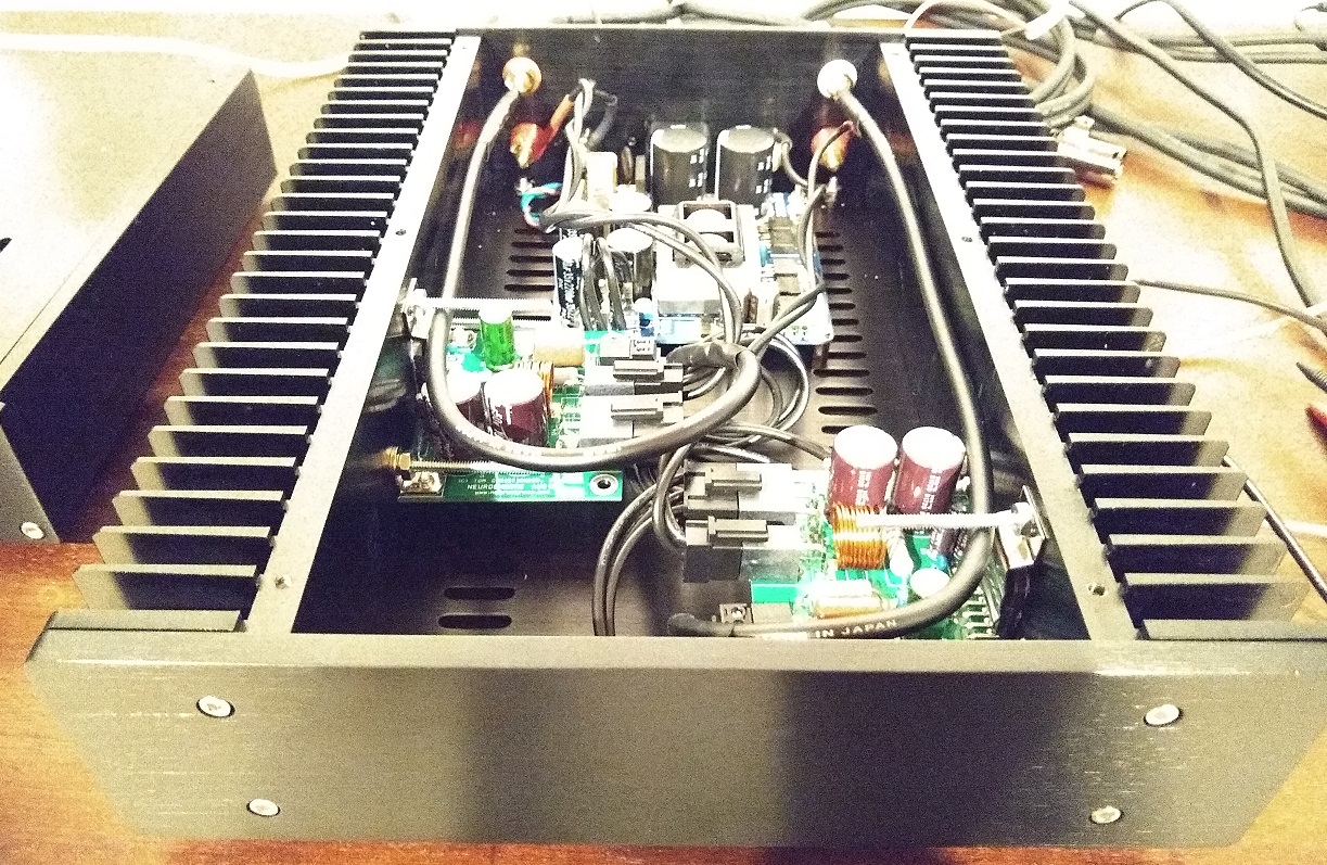

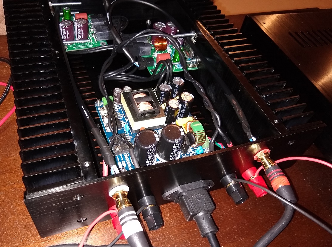

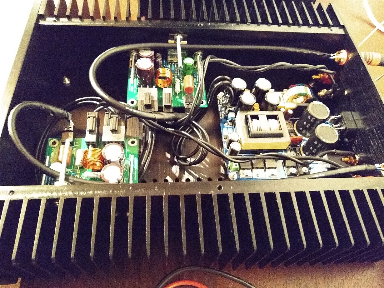

Update to post #305 above: I liked this amp enough to rebuild it in a nicer case, and do a clear job on assembly. It could still use a few finishing touches: inline mains fuse, power-on LED, and some right-length black screws for actual LM3886DR mounting. But it's way better than it was. Sorry for the lousy pics; there wasn't much light and I don't like flash photography, so opted for noisy low-light settings instead (except for the rear-end pic, I settled for flash on that one).

I like the slim form factor. That's a pretty nice desktop amp there. Those are some rather phallic mounting screws for the LM3886es, though. 🙂 If you don't have the ability to drill and tap, I'd consider self-tapping screws. Just a suggestion.
You might not need a fuse. If the IEC inlet connects directly to the SMPS, you should be OK as the SMPS has its own fuse. If you have a power switch in series, I'd add a fuse at the IEC inlet.
I'd leave it the way it is. Enjoy it! Thanks for sharing.
