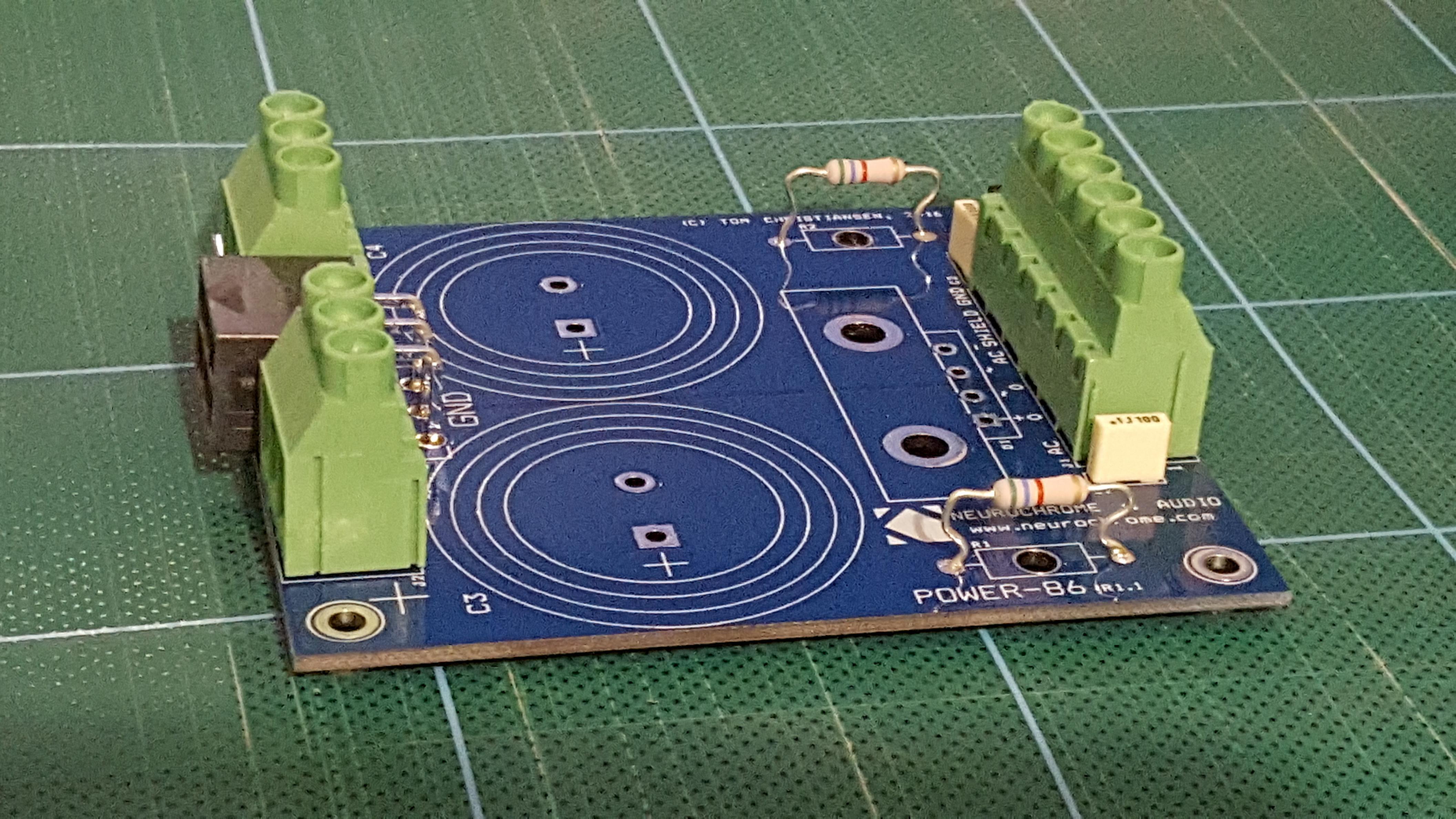

As I mentioned previously, I'm pairing the LM3886DR boards with a Power-86 and that is where I started this evening. This is the progress so far...

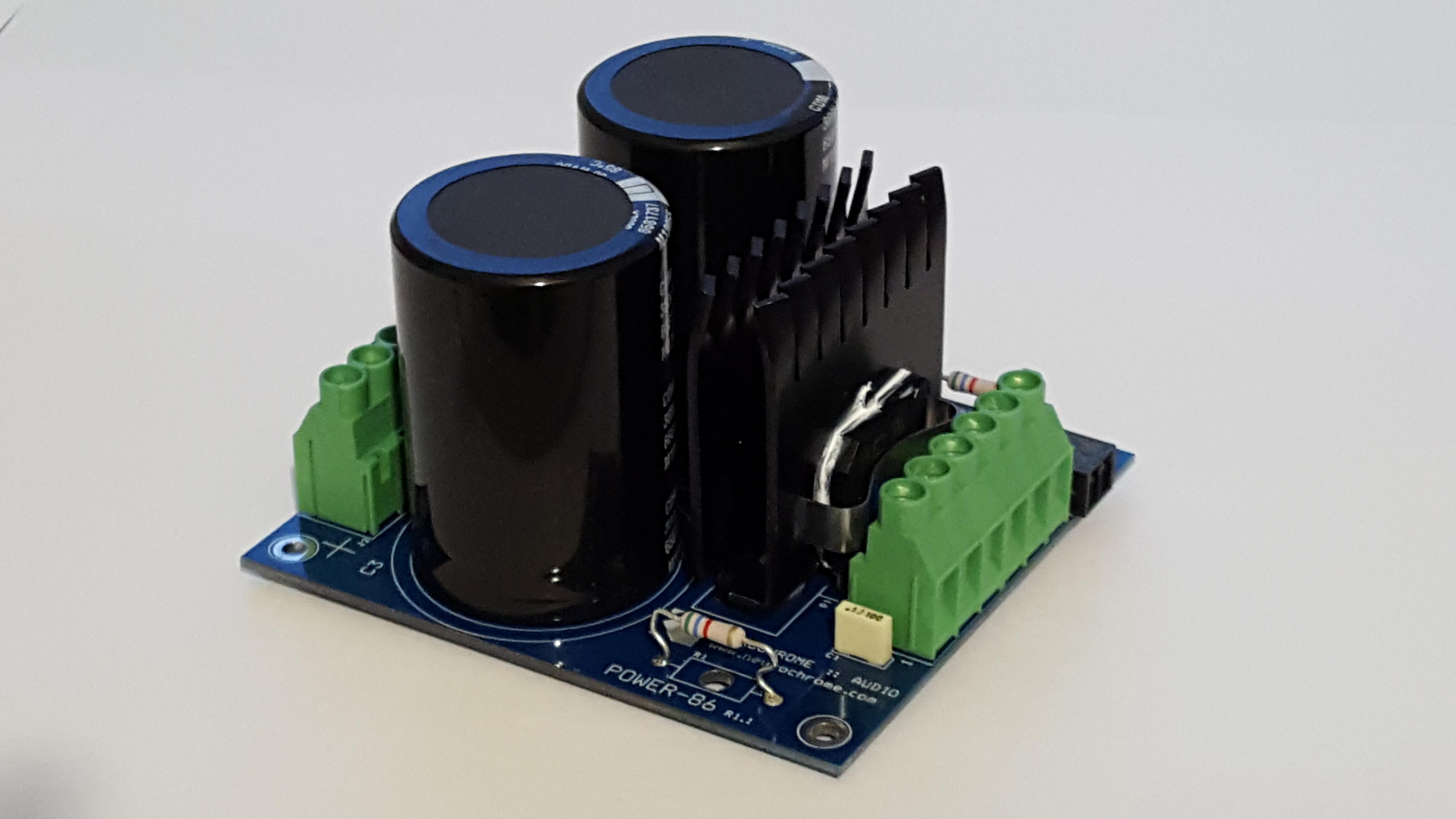

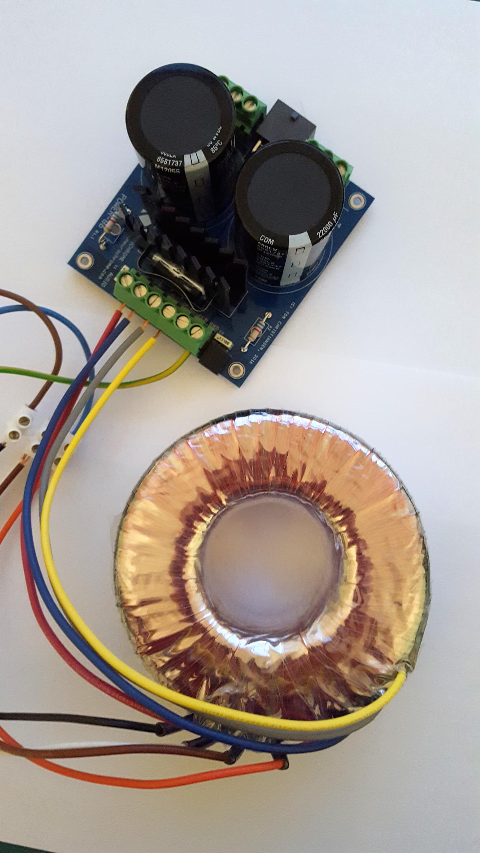

So, a bit more progress over the last couple of days...
Power-86 board completed. Soldering looks OK. I worried a bit that I'd have issues with being steady enough with the soldering iron. Turns out my hands are perfectly steady. My eyes on the other hand have definitely deteriorated since I last did any soldering...
The Power-86 documentation suggests Antek transformers. Since these are difficult to get in Europe, it also suggests a Hammond alternative, which I was able to add to the Mouser order. Very impressed that the documentation acknowledges that not everyone is in North America and provides options for us Europeans. 🙂
Powered it up this evening with no load attached. As detailed in the documentation, the output voltages are a little higher when there is no load, but well within expectations (±33V).
Only slight concern was that the transformer hummed slightly. I'd welcome thoughts as to what might be causing that.
Neil
