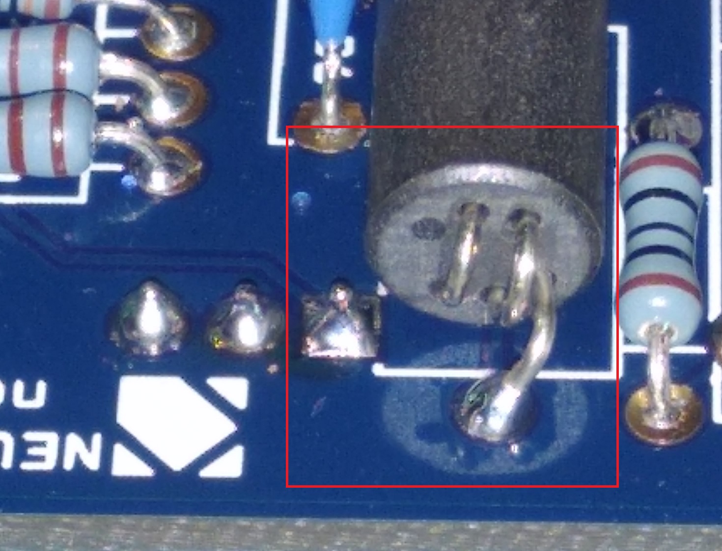

Today I soldered the parts to the PCB.
One thing which Tom does not mention in his otherwise excellent documentation is that we should be careful to place the ferrite beads in the exact location where they should be.
If they are too much to the side, which is easily possible, then it is difficult to later solder the jumper to the board.
Here is the critical area.

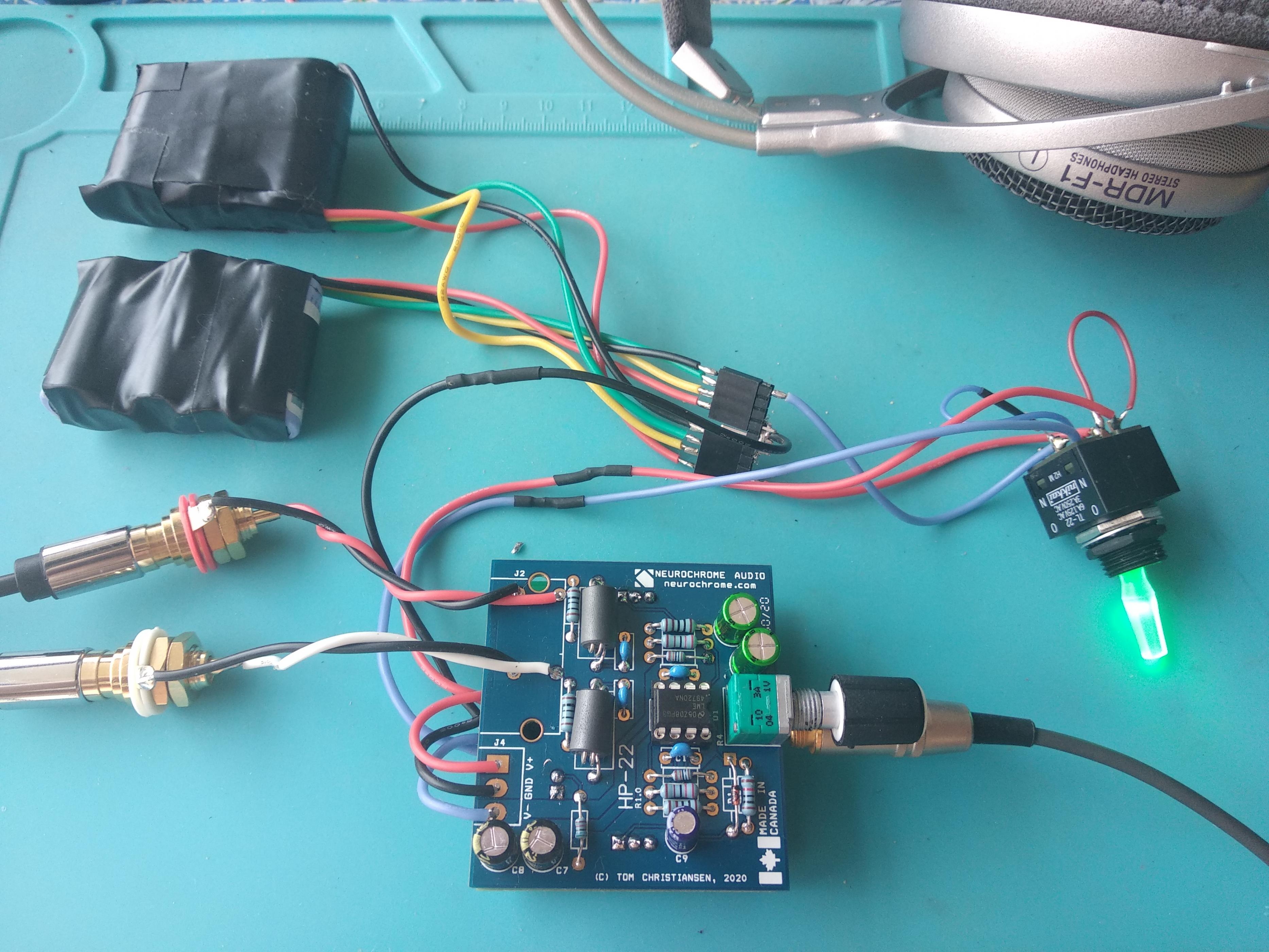

I just finished soldering everything together and it works. 😉
The picture contains all parts. The connections are temporary, and I have to put everything in the small box. I know already it will fit but I need some precision tools before I put things together.
I used separate RCA connectors to fit my box.
For the power supply I used 2 x 3 x 16340 rechargeable lithium batteries. I will charge them with a RC hobby charger which I have already. I chose the 16340 because they are relatively small and powerful enough.
I followed Tom’s excellent documentation, and all works as expected.
Here are my first impressions
The HP-22 sounds very good, and the maximum volume is high.
My first test was with my mobile phone and my SONY MDR-F1 headphones.
When I switch the amp on or off then I hear a switching noise. But this is low volume even if the potentiometer is set to max.
Tom suggests a test procedure with a test tone in his description. I did what he suggested but my phone is not able to output a signal with the suggested amplitude. I will not only use this amp with my phone but I will also use it with my phone and I want more than enough volume. For that reason I will increase the gain a little. Tom also describes this in his documentation. It is only necessary to change two resistors.
That’s my first impression. I can definitely recommend this little amp. Thanks Tom.

Very cool. I'm glad you like the li'l amp.

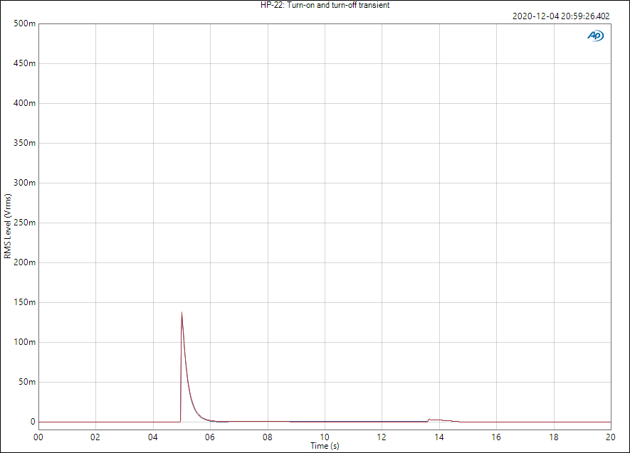

About the turn on/off transient: It's pretty small but, as you point out, it's not zero. I did the best I could given that I didn't want an output relay for cost and size reasons. I did test it with a pair of sensitive IEMs and didn't find the pop to be objectionable.
Unlike other manufacturers I actually characterize this. See attached measurement.
