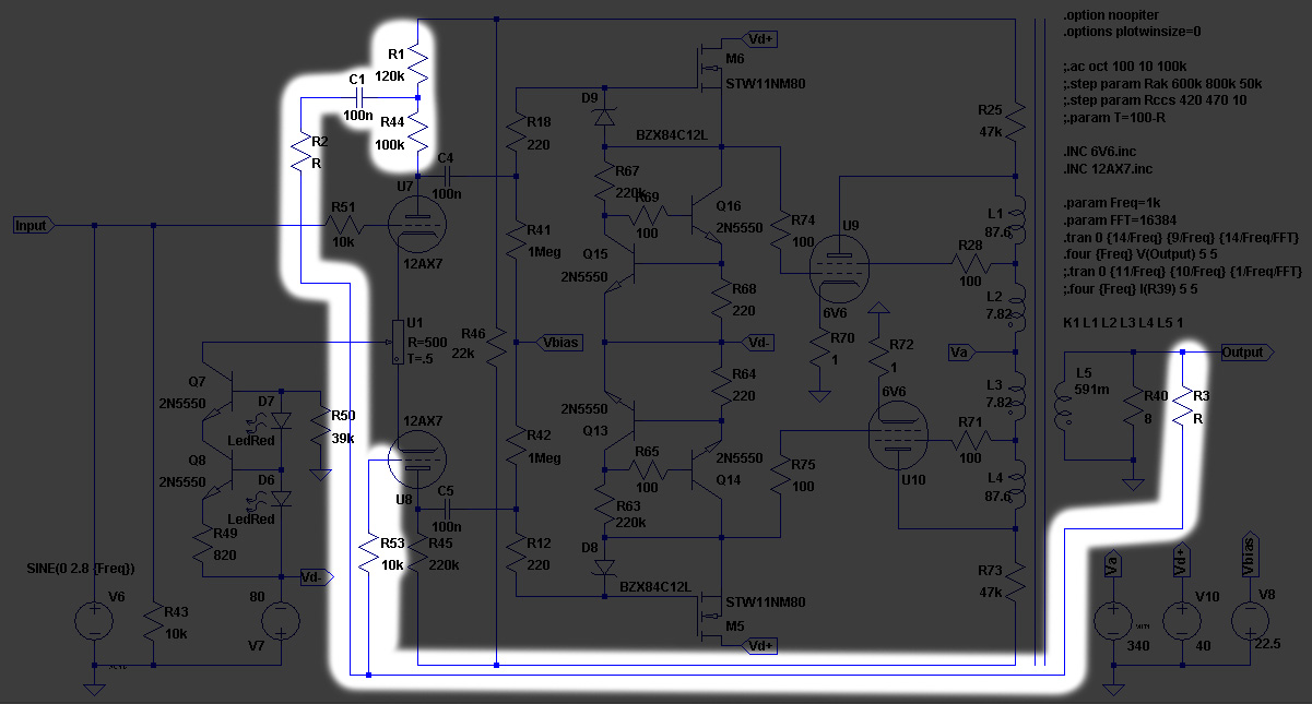

A modest improvement to the ODNF scheme seems feasible. (well, uPID might do even better)
Instead of attenuating the output signal and subtracting the input signal to get the error signal and then amplifying back up. Leave the output signal as is, and Op. amplify the input signal up to it. Then do the subtraction. Now the error signal will be larger, so will need less gain B to lower distortion, or using the same gain B will lower dist. even further. Just an idea.
Once one has a super low distortion Op Amp, like the LME type, one could try the Yamaha ZDR (feed-forward) scheme. Drive the error signal with the Op Amp and sum with the output using a -very- low output Z xfmr (likely ferrite, one turn secondary) in series. The Op Amp only has to supply distortion correction power. Very low if the main Amp is already low N Fdbk corrected.

May I ask you how do to prefer to manage the nested feedback loops? output tube plate to grid, output plat to driver cathode, plus gnfb? Some positive current plus negative voltage feedback plus local feedback (à la Wavebourn)? Something different?Nested Fdbk loops look like the winner to me for a tube amp.
Will this be adaptable to a "paraphase concept" phase splitter, with the voltage divider referenced to the secondary of the OPT instead of ground?Instead of attenuating the output signal and subtracting the input signal to get the error signal and then amplifying back up.
There are various advantages and disadvantages to the different local Fdbk models.
Plate to driver cathode doesn't require a Fdbk criss-cross for phase (P-P), but then it has a large voltage difference so usually requires a cap(s).
Plate to driver plate requires current drive and gives low Fdbk loop gain. It also has a distortion residual with low gm output tubes, due to grid V affecting the N feedback current. UnSet/CED seems preferable for low gm output tubes.
Plate to driver grid makes for low input Z at the driver but good gain for the local loop.
I prefer (in theory anyway) to do plates to driver screen grids (P-P), so the driver grid 1 stays high Z. This has several drawbacks however, crossed Fdbks for phase, and either screen grid Mosfet followers, or scaling the screen grid V variation to a constant fraction of the output tube grid V variation to get constant Z at the screen grids. (driver screen grids at a constant fraction of the driver plate V, intercepting a constant fraction of plate current ) And the driver tube needs to have a very good interal triode mode. This can be restrictive without the right driver tube.
UnSet/CED seems useful for single tube N FDBK. And it can provide nice triode curves, even for low quality triodes (like regulator tubes, say). And low output Z as well.
The output current Fdbk for critical speaker damping seems interesting, but seems not to be favored these days.
Some global N Fdbk seems generally useful, unless the output tubes are low Z triodes (regulator tubes say). Might as well use the OT phase room if needed.
Then there is Crazy Drive, which is actually Feed-forward. It can get near constant gm from pentodes/B. pentodes. It needs some further Fdbk to get the output Z down. And cross-over distortion performance seems unproven. I think it should be able to do as well as grid 1 drive here, but at much lower idle current.
I guess, I don't see why not, would have to work up a schematic probably.

I've simulated results of the "Corr Diff" and are very promising:
Shunt Cascode Driver meets UNSET for Push-Pull
I add the link here to be able to follow the results on that circuit and develop that circuit even further for anyone interested (you can find the PSpice file attached to that post).
