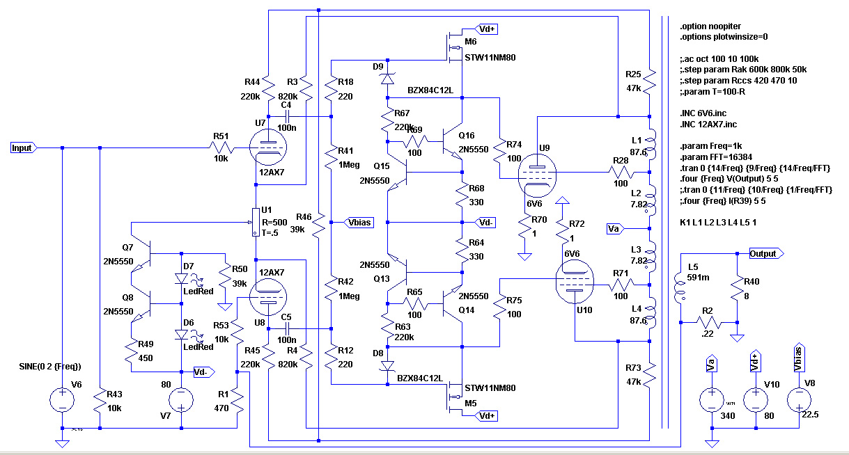

ODNF can be looked at as an ordinary global N Fdbk setup where the input signal has been moved up in the amplifier string closer to the output. Leaving the front end high gain stages with only the N Fdbk signal to handle. The error signal still re-circulates thru everything like in a global form, so spectral spreading is still occurring. Now one has to adjust a trimmer to get the N Fdbk matched to the input "effective" level, and this depends on gain B staying constant and without distortion (zero!, 0.001% or less). The availability of National LME type Op Amps is what makes this all practical.
While the theorem that global N Fbdk is more effective per gain available is true, it is limited in a tube amp by the OT freq. response. The OT magnetizing current, tube dist., and winding R (and crossover distortion) are the main culprits to overcome. Not well appreciated however is that local N Fdbks can fix these problems readily (well, fix the primary R well), and with good freq. response.
So we are left with the typically low dist. front end gain stages as the only difference between global and local N Fdbk schemes. Ordinary global N Fdbk has the front stages inside the loop.
ODNF uses an LME type Op Amp to replace them.
Local nested schemes can just use the available OT BW in global N Fdbk to fix the front end and fix the OT secondary R (also the primary R if not already corrected by a local fix). The local N Fdbks fixing the tubes, crossover, and the OT primary (and magnetizing current).
This last approach does not require an expensive OT, and can easily be done with all tubes. Nested Fdbk loops look like the winner to me for a tube amp.
A modest improvement to the ODNF scheme seems feasible. (well, uPID might do even better)
Instead of attenuating the output signal and subtracting the input signal to get the error signal and then amplifying back up. Leave the output signal as is, and Op. amplify the input signal up to it. Then do the subtraction. Now the error signal will be larger, so will need less gain B to lower distortion, or using the same gain B will lower dist. even further. Just an idea.
Once one has a super low distortion Op Amp, like the LME type, one could try the Yamaha ZDR (feed-forward) scheme. Drive the error signal with the Op Amp and sum with the output using a -very- low output Z xfmr (likely ferrite, one turn secondary) in series. The Op Amp only has to supply distortion correction power. Very low if the main Amp is already low N Fdbk corrected.

Will this be adaptable to a "paraphase concept" phase splitter, with the voltage divider referenced to the secondary of the OPT instead of ground?
I guess, I don't see why not, would have to work up a schematic probably.
smoking-amp, this is the idea (the split load on the phase splitter is not to load one side vs the other), but as far as I've tried on LTSpice it doesn't work.
