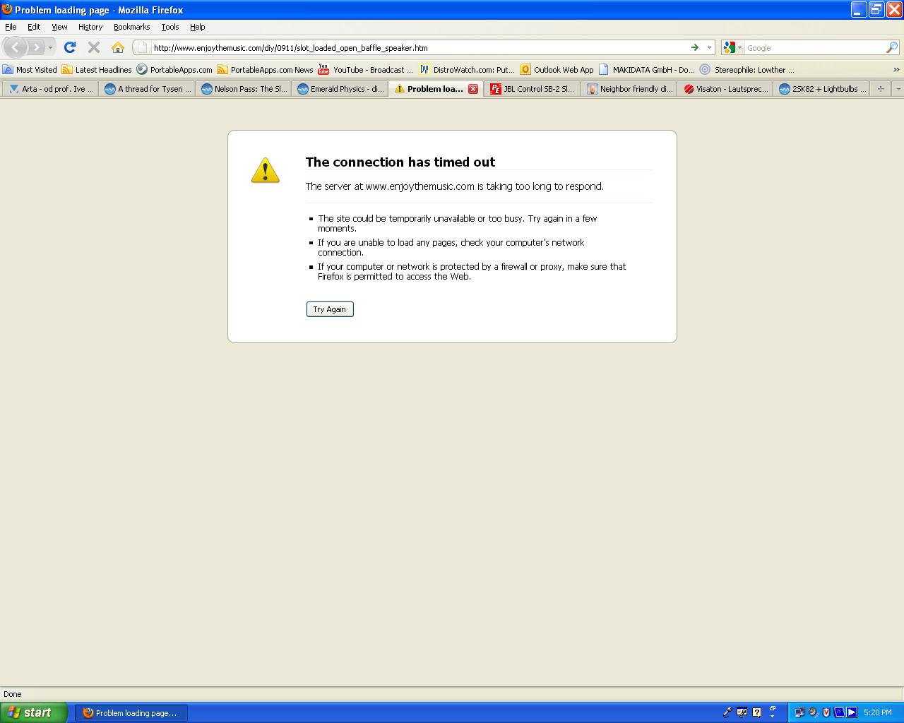

I read the whole thread and still don't get it, because the web-page isn't accessible :(:confused::scratch1:
Any idea how to solve it?
