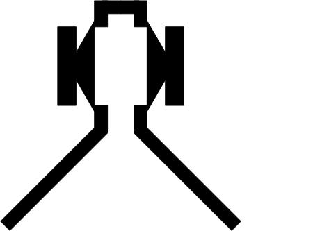

Earlier in the thread, responding to comments that there is no difference
at 2 meters, I performed the following experiment:
I measured the response on axis at 3 m. Then I turned the speaker around
so that the slot was facing the rear and re-measured, overlaying the curves.
The difference in the range between 30 and 100 Hz was about 2.5 dB.
Great, Nelson. But if I understand, what you have done it unfortunately doesn't prove anything about efficiency. What shows is more about relative delays.
I made some simulations:
Here the red and green are simulation where the the delays are symmetric and the source strength is equal, red and unequal, green. As you can see, even though the source strength are unequal (green) the amplitude at the front and rear are the same. The effect of unequal source strength is to "fill in" the dipole nulls.
Next, blue and violet show the cases where the delays are asymmetrical for equal (blue) and unequal (violet) source strengths. In this case it is observed that the front is higher SPL then the rear, regardless of whether the source strength is equal or unequal. A null at the rear (cardioid) will be obtained only with equal strength sources and the correct delay asymmetery.
The assumption here is that both sources ultimately generate a spherical wave in the far field which for frequencies between 30 and 100 Hz should not be too much of a stretch.
Hi John,
You are quite correct.
The efficiency argument, which is separate, comes from Heil's design,
where the ratio of acoustic output vs cone motional energy is improved.
If Heil is wrong, I can live with that.
I was inspired by your simulation enough to go measure the speaker output
at 1 meter in the area where we expect the dipole cancellation. Looking at
the curves for the octave centered around 70 Hz, I get the most cancellation
at exactly 90 degrees, with an 11 dB dip.
From your sim, I would interpret that as symmetric delay but unequal
source strength.

Would seem to suggest that. An 11dB dip would imply about a 1.5dB difference, but would still imply equal 0 and 180 degree amplitude. Your 2 and 3 M results seem to suggest that at least when you are out 2M or more the wave fronts are pretty much fully developed. Certainly, what ever it is, it is. We just haven't figured out what it isn't.
I'm planing on building a scaled down version so I can run a full set of measurements including polar plots. Hopefully what you are seeing isn't unique you your exact configuration. And I think Tom D's suggestion on looking at the effect of slot loading is something I might look at too.

No, not really. What I am looking at is modification of the u-frame form factor.
I am investigating mounting the woofers on the sides of the u-frame rather
than on the front so I can reduce the vertical height of the woofer enclosure.
This is purely to allow me to modify the form factor and make the speaker
easthetically more pleasing. I don't expect any unanticipated changes in
performance.

I'd say that the increased radiation resistance from the velocity transform is lost again at the discontinuity at the slot.
John K's intensity considerations are correct IMO. Only a horn would allow us to effectively make use of the improved loading.
That doesn't mean that it is unusable OTOH - which is shown by the practical implementation of course. I'd say the biggest advantage is that one can have a lot of Vd in a physically compact arrangement.
I could also imagine a "dipole" sub that can be placed close to a wall to be constructed with such a slot arrrangement.

Making progress with my scaled model. The baffle is 11" wide by 18 1/3" tall, a scaled version of Nelson's. The slot is designed to have an opening of 1/3 the total driver S and is 3/4" wide by 10 1/2" tall. Drivers will be 4 Vifa MG10 4" woofers. Due to the scaling I should be able to get good anechoic response down to 200 Hz. The dipole peak should occur at 800 Hz so I should have very good measurement capability in the low frequency region.
Slot with side cover off.
Slop with both side cover on.
Completed slot viewed from opening.
Front view of slotted baffle.
Rear view of slot mounted on baffle, ready for driver mounting.
