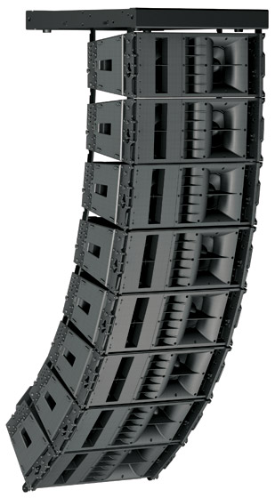

The oldest guys in that. They had the Aquarius wide dispersion range before L100. Pro sub manifolds, every floor facing sub, even a Karlson, all kinda ''slotty''🙂
