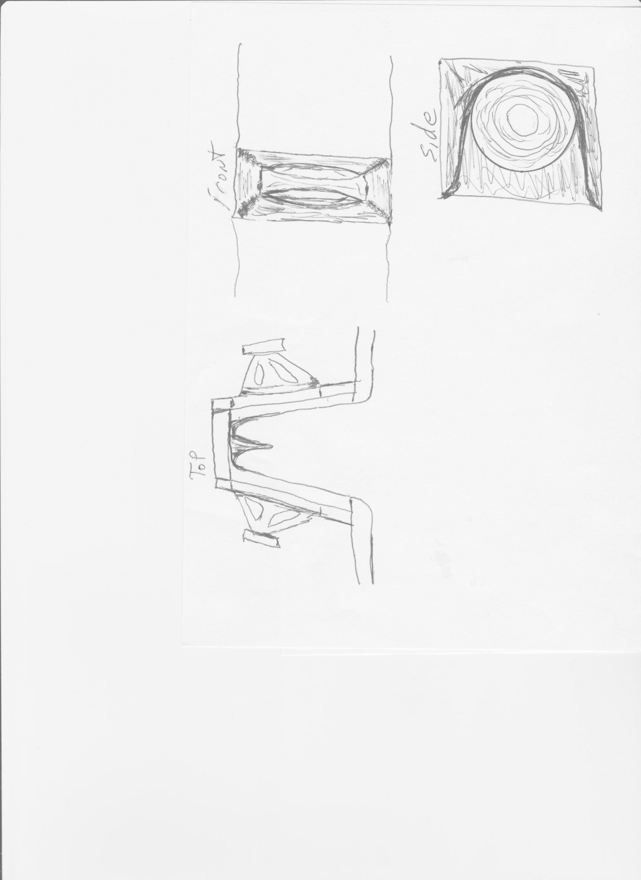

Here is a rough sketch of one slot ,I have decided to build one like this ,test it and then build 2 cabinets with 6 of these slot unit 3 per cabinet,if I like the responce.
So about slot length do you think a larger area H x W would increase bass responce as oposed to eqing it there and by the same token make it smaller for midrange?
Is there a way to better couple a speaker to air ?
Cheers
