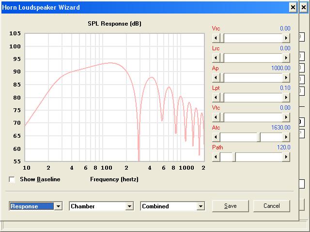

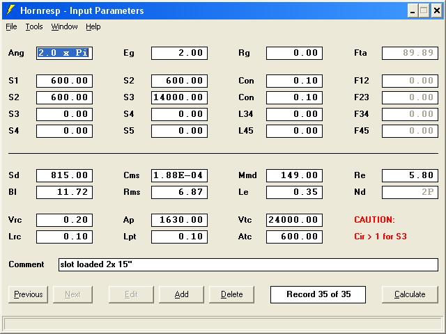

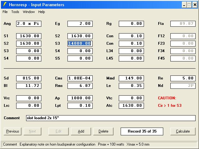

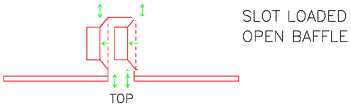

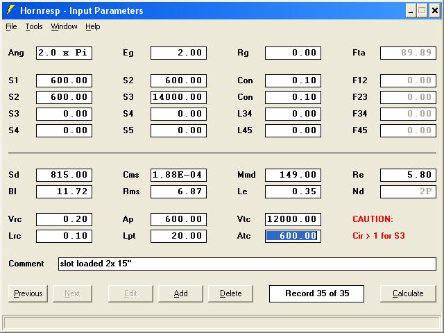

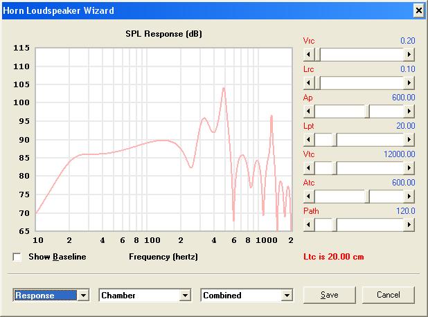

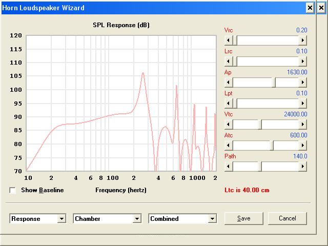

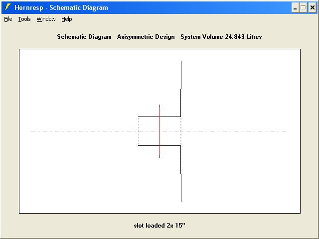

I sort of concur with sreten on this ive been playing about with hornresp and come up with something that sort of models the design i also ran a baffle simulation and from what ive come up with the 'port' seems to be adding extra path length to the box in essence making a wide baffle but doesnt seem to improve spl.
first two graphs are what i think is a representatio of the slot loaded drivers i may be wrong. The second two are the same drivers on the same baffle without the slot. There is a slight difference in spl down low but this could just be the added baffle size.
I set both to have a path length difference of 120cm
My hornresp design may not be right though.

You cannot just use pressure to indicate SPL, you need to normalise it
by multiplying it by the radiating area, otherwise you get nonsense
like small ports being more efficient than large ones, they are not.
Yes, the pressure is higher as the area is less, inevitable measured
nearfield. Farfield there is no difference, there is no efficiency gain
with the arrangement. Volume displacement is the same front and rear.
You are saying my whole fallacy is wrong, and Heil transformers obviously
don't work as described.
But it's a fact that air moving at a higher velocity carries more energy
and this shows up as greater pressure.
When I said near field, I did not mean that I was sticking the microphone
in the slot - it is true that the farther away you get and as the frequency
goes lower the effect is diminished. I find that the effect is perfectly
adequate for listening purposes.
:cool:

Combining a (folding) slot with a wide baffle doesn't make much sense to me. WRT the 9 dB difference I am very much with sreten. Simply tripling the air velocity by diminishing the area to a third doesn't give more efficiency. It is NOT the same effect as AMT.
