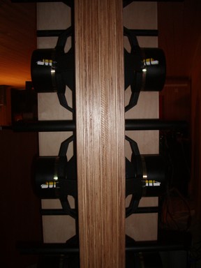

Anyone in mood for some more pics?
YES!!!!!
And some more info please: brand and model of woofers etc (if you would like to share)
YES!!!!!
How about me sharing the cost of these babies with you? $ 25.000 and a couple of hours of research, planning and engineering..
All in due time, Audio.
Actually I got 12x10" and 8x12".
I could get two 12s for the price of one 15, so it was a no brainer
What are your plans for these, Melon?

Will have some pictures taken during the weekend - with a brief overview of the whole project maybe on Monday. Enjoy your weekend, fellow DIYer's!

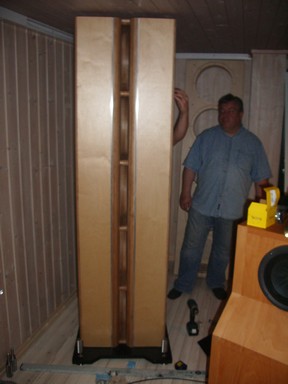

Lookin' Good !!!!!
Looking nice!!!! What size speakers ? Look like 12's maybe ,How's the response?A few more details...
