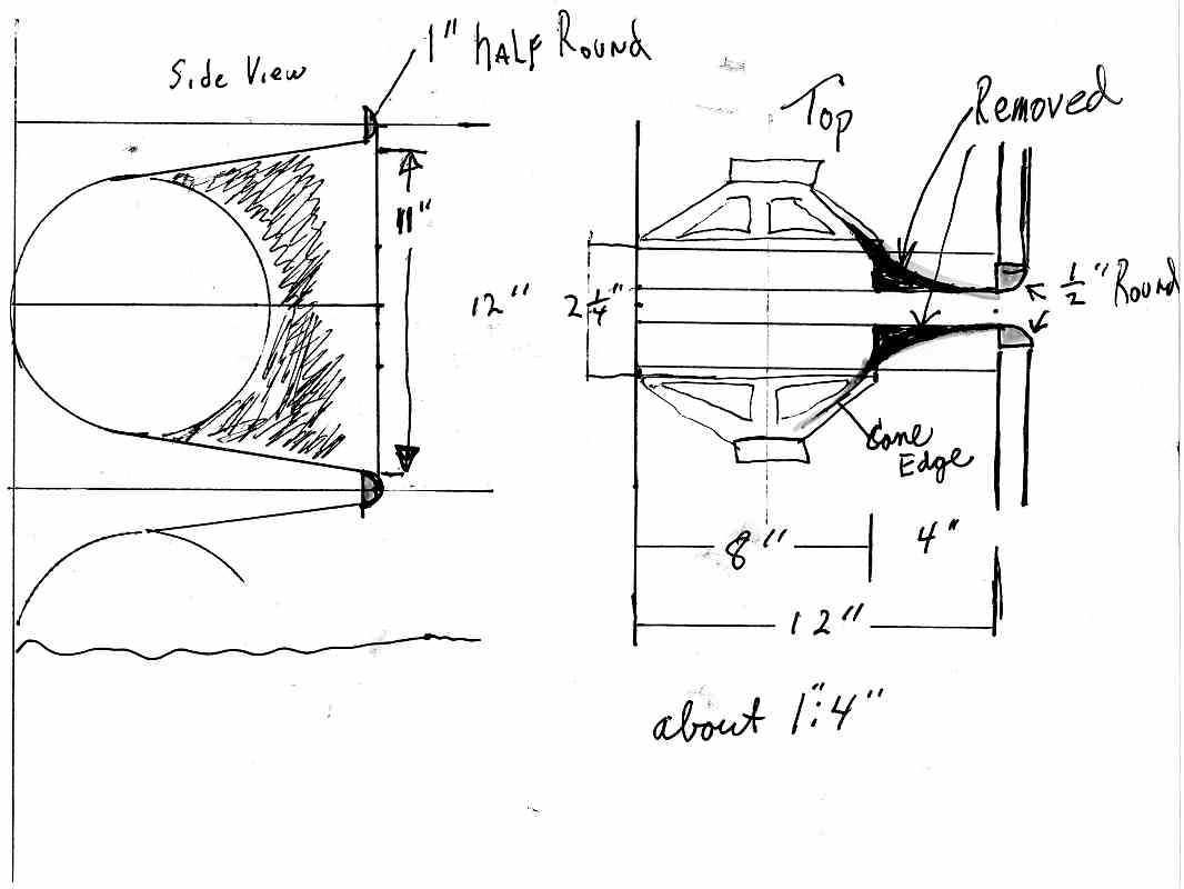

NS .. can you tell me the size that your baffles ended up ?
hi,
I made my slots at the baffle 2.25 " x 11" that's the opening I rounded the area between the slots so the actual size is 12" .
I have enclose a drawing,please excuse the messy artwork, I wish I had a drafting table ,lol.
The panels are 18" x 6' each, I did use 1" half round at the top and bottom of the slots ,and 1/4 round into the slot opening to the panels I ran one 6' piece per side , just like a picture frame would look.
I removed some plywood,I used a side grinder with a 6" abrasive layered sanding disc,was 60 grit,got it at the depo,to shave the area right at the cone edge to the slot ,I stopped about a 1' in from the edge,I built one slot with this shaved and one without ,get the grinder out and do this it helped the smoothness of the bass,I got the DATS for speaker measurements and when I learn what I need to know I will make some rough test as I am not a expert,I did run some test tones,and use my ears no dead spots or dropouts that I could hear,I played some Cher,ZZ top and Santana ,Iwas happy and had to turn down those amps,Belive by Cher didn't rattle the cones at all ,
,I'll try to finish those today so I can make a few pictures for you.
I like the sound I am getting from these and I have found about 12' apart is pretty good,anybody wants to jump in about optimum distance for slots,I'll listen......If I can help just ask! 🙂🙂🙂🙂🙂🙂x2 ^5
