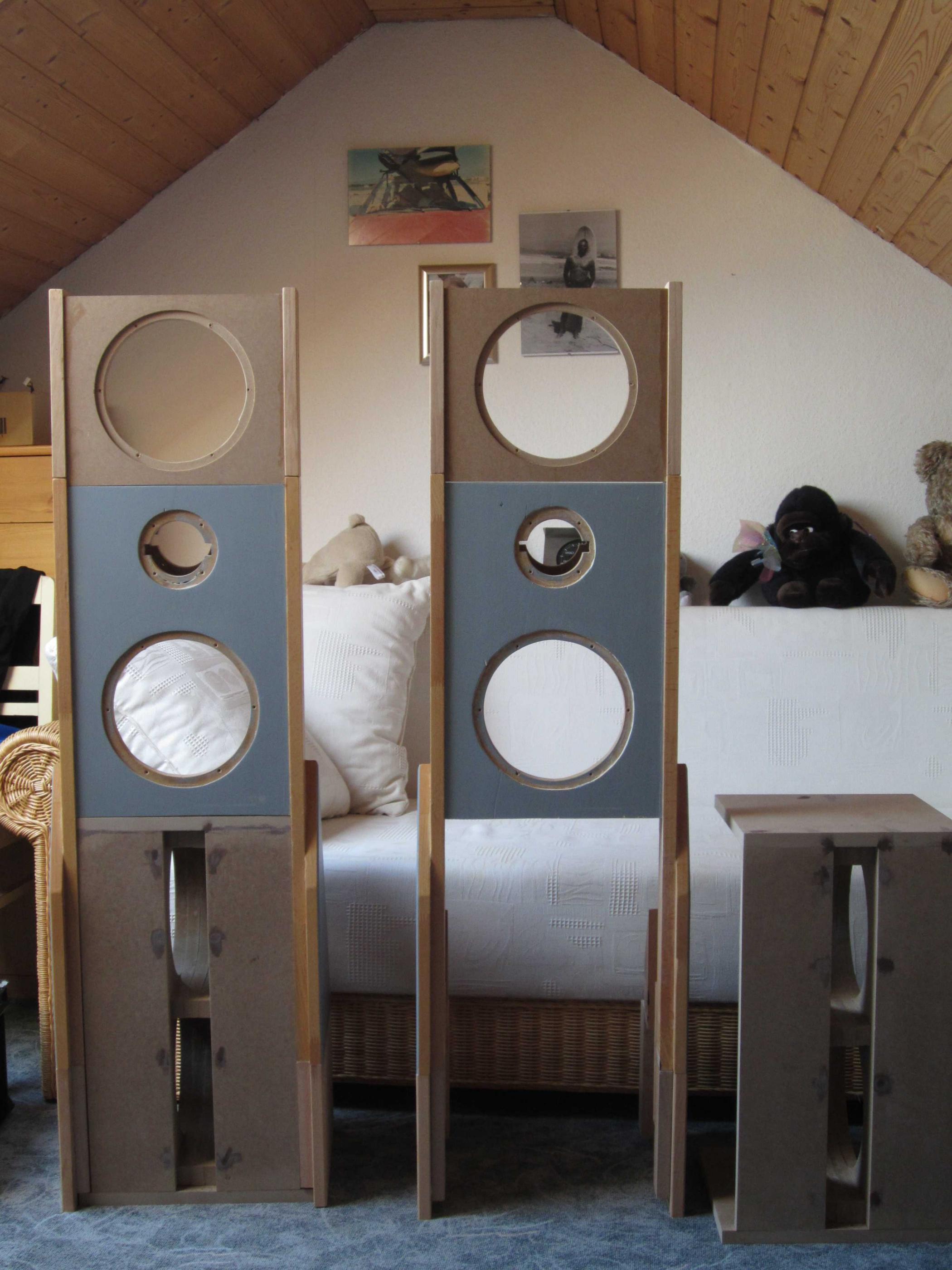

Hi gents,
below you can see my take on the topic "slot loaded sub". It is a merge between a Linkwitz style Phoenix or Orion Speaker and a slot loaded open baffle by Mr. Pass. The idea to combine the parts this way came up when I had a Linkwitz system with seperate W-Baffle Sub and the rest of the speaker system standing on top of it. I wanted to have a more compact design similar to the Orion speaker. As I wanted to realize my own ideas I went the way described. The drivers used are: 8 Mivoc AW2000 for the subs, 4 Usher 8137K for the mids and 4 Usher 9950 for the highs. Crossover fequencies are 120Hz and 1.4kHz as in Mr. Linkwitz designs. Later on I`ll decide if I go for a slightly lower crossover frequency in the lows (90Hz). As you see, woodwork has almost been finished and the speakers need sanding and painting. I hope to fire up the complete system during the summer months.
Enjoy, Jürgen

hi Vince - way cool build - does the plenum's rear need to be curved for smooth operation or could it be simplified with rectangular spacers in that area? all I've got is a jigsaw.
is slot width ~ 3 inches?
I think your woofer tester may show the composite system Q plus any outstanding cavity resonances.
can it hit a good bass drum? - (you don't have much cone area on top)
Joined 2000
Instinctively, I would say rounded, just because I think it would act as a better guide and not have as much turbulence. Also the mouth of the slots should be rounded for the same reason.
Use a blade made for scrolling and set the speed to medium, that would have been a "5" on my jig saw. Let the blade do the cutting and don't rush it. If you go all out like I did, you'll use up 1 blade.
Joined 2000
All are 13x33-1/2. Figured out even spacing for the three drivers, marked it and drilled a small hole through all 5 panels. The front Baffles are 33-3/4wx30h. the woofer baffles are 3.5" higher so there is some space the fasten the upper baffle, that is the same dimension of the bottom baffle. The upper front baffle will need a brace, like in the article.
