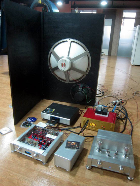

Finally someone is doing it - really big
At the Munich High End 2012 fair silbatone will show two classic Western Electric theatre horns supported by a huge slot loaded open baffle:
Look here and here for the full story. Or wait for RMAF to see them in the US.
Doubt we will show that woofer at RMAF--or, if we did, there would not be room for anything in the room but the woofer! Maybe a line of piezo tweeters on top?
Definitely a "big room" design, although it will break down small enough to fit into my Volvo station wagon. Unloaded, it kinda looks like a piece of playground equipment!
We will get a chance to put this beast through its paces at the Munich show. It will be running @ ~80hz low pass.
On initial audition, it was very "potent" but it had an open and natural sound that mated quite well with the WE15A horns. A worthy technology, it seems...will have more to say after the show.
Madman jc morrison designed the woof. I think his idea of pairing the Altec 515B and EV 30W is supported by matched Xmax (and possibly Vas) between these two drivers but I wouldn't rule out sheer perversity as one of the design goals.
